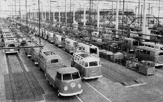

Today, fifty years ago on April 8th, my bus was born and rolled out of Hannover. This year marks the start of a long process to return to full factory condition. This thread hopefully will document that journey.
Birthday Photo!
