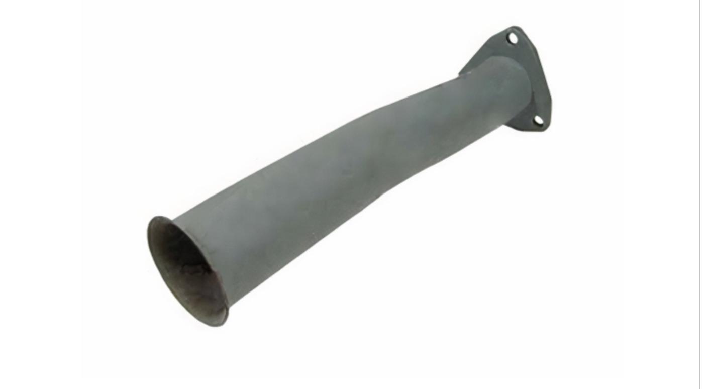

I used a cheap and dirty Empi exhaust to get my bus on the road again but now I’m looking to get back to stock ish. I won’t be putting a cat back on for now. My question is how do I join this
To this?
And how do I support the tailpipe end of the muffler?

well, there is pipe called a cat delete pipe that goes in its place. You need the special donut clamp to be able to join the two. They are rare these days and outrageously expensive. The last ones I bought were almost $100 although you can find them in old stock sometimes for less than $20 if you get lucky. The last official price from VW on them was around $60.
The tailpipe is self supporting and it is curved. The muffler is held to the crossover with a special strap.

Something like this?
https://www.vanagain.com/product/muffler-clamp-kit

Can it just be welded? Seems like that would be a better connection than the clamp. Especially because the one I linked to needs to be altered to fit. A quick google search came up empty for the correct size.
Weld only if you never want to take it apart again. And yes-no, that clamp will work with some modifications, sometimes and sometimes-not, but it is not returnable once you start the mods. It is not the correct one, it is for another VW that is close but does not fit natively. Most likely they are relabeling a 070 298 051 A super beetle clamp. Wolfsberg West and German Supply list that they have the correct ones but you really need to talk with them to be sure they have the real bus one before you order it. They went NLA about 10 years ago.
These are what you need (see old ad link). I don't have many left now, maybe 3 to 5, and don't like to sell what I have cause they can't be replaced. Will admit to hoarding them. Same for original TS II sensors. Ad is deleted now. Gotta learn to grab some of these things when they are available. They are 50 year old cars. I had 11 or 12 at one time but it was only to keep them from being lost to landfills. I sold most at my cost - here in California they are almost needed if one is to be fully visual inspection legal A used one can be reused if you have one and if it is not too bad. That is another option you have. I re-use mine when I have the muffler off rather than use another one that is near impossible to replace.
https://www.thesamba.com/vw/classifieds/detail.php?id=2334183

Looks like welding is the way to go for me. I can see the advantage of being able to drop the muffler just by removing the clamp if needed but it’s also another leak point.
or, the kit is a 023-298-051A. That’s probably what ww is selling. i think scott is out of stock. the “a” kit has a donut with a slightly smaller diameter. you need to dremel it to fit. if i remember correctly.
by the way, without a cat or straight pipe, the muffler just won’t fit correctly.
and, the guys at overdrive, many years ago, added some large hose clamps around the muffler and cross pipe in back to add support for the muffler.

The stock set up uses a hanger from the shroud to the heat exchanger and the alternator hanger on the other. Then there is a strap that mounts the muffler to the crossover. That is more than adequate to hang a late exhaust.

make sure the flanges match. If the exhaust uses the 1979 trapezoidal flanges instead of the 75-78 triangular ones it will work. If it uses the 75-78 or federal triangular style flanges the one Ray posted will not. My photos are all the triangular flanges on my 1977. If you weld it be sure it is clocked right before you do it.

I have the triangle flanges, 76 style heat exchangers. I would love if a triangle to trapezoid flange adapter was made although it would probably push the muffler too far out.
