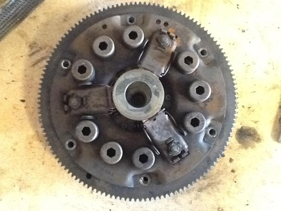

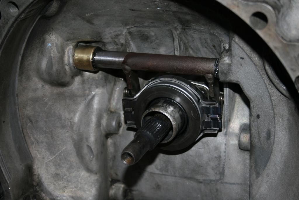

The early style looks like this:
It is compatible with a pressure plate that looks like this:
or this:
The key item is the ring on the pressure plate which contacts the release bearing.

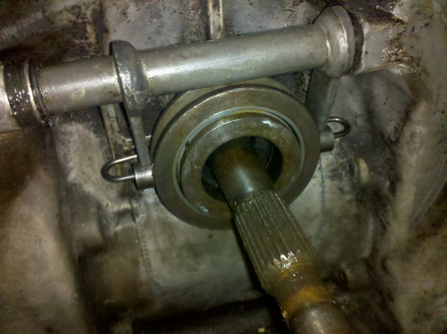

The late style uses a guide sleeve which is attached to the transmission, surrounding the input shaft. Like this:
This setup requires the late style pressure plate without the contact ring, like this:
Often, the ring can be removed from the early style pressure plate to make it compatible with the late style release bearing.
It doesn't matter which transmission you use, as long as the pressure plate and release bearing are compatible.
Good luck, Mondshine
