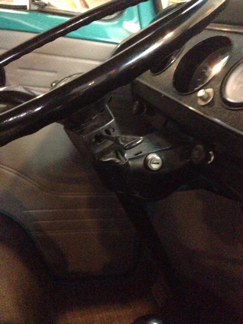

Not to highjack your thread but:
I have a similar problem with my horn, when I got my bus the horn was operated via a push button on the dash. I have discovered that the problem is that the ground wire is not connected to the steering coupler and if I touch one of the bolts with the wire, the horn button on the wheel works well, BUT I have no idea how to connect the ground wire to the steering coupler, if I just attack it to one of the bolts it will get torn appart when turning. Could I be missing a part down by the coupler?
Can someone provide a picture of how the ground is attached to the coupler please?

Excellent (sortof), a 74 can have 2 different horn systems, is your wiper and signal switch in a separate metallic housing from the ignition switch?, or is everything covered by one singular plastic shroud?
Слава Україні!
mexnotch
Joined: November 08, 2007
Posts: 51
Location: Mexico
mexnotch is offline
PostPosted: Wed May 08, 2013 5:41 pm    Post subject: Reply with quote
Separate housing. Here's a picture. (BTW, you can see the push button for the current horn Confused )
