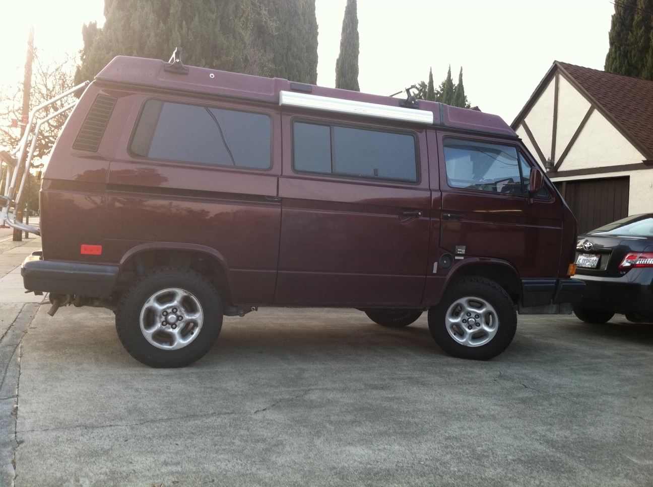

PostPosted: Mon Apr 29, 2013 12:06 pm    Post subject: Reply with quote
With rust, function is still there.
I would like a proper look to match my van Very Happy
