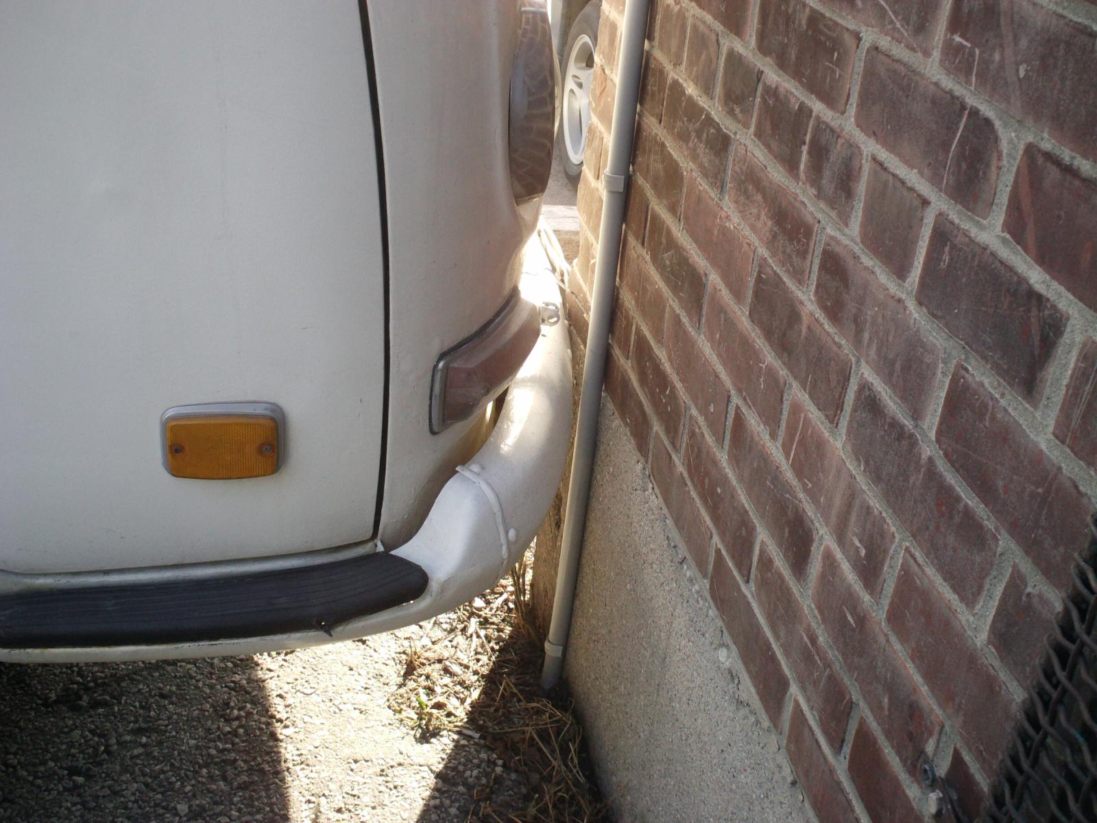

Here is an interesting little mystery I had to solve one morning recently.
One morning in January I went out to the parking lot and found my bus had been pushed up and over the parking curb and into the brick wall of my building. Of course my first thought was that some punks had been messing with my bus and pushed it over the curb as a prank. I was getting pissed. But there were no hand prints, dents, or any sign of the bus being manhandled. The back of the bus was quite dirty so any of this would have been obvious.
I put the bus in neutral, went back to the engine compartment and tried to rotate the fan a little bit by hand: it was locked up tight. When I disconnected the battery the engine freed itself up (thankfully) so I figured I had a starter problem.
As it turns out, my hot start relay shorted out and engaged the starter causing the Falcon to drive up and over the curb then bang into the brick wall and come to rest. The starter obviously remained engaged for a good period of time since parking my bus the night before. The starter is fried.This occured during a mild spell in January so there was lots of salt run-off on the roads and I had just returned from a trip a few hours North of Toronto. The salt water worked it's way into the relay as it sat over night. Now I can detest road salt for an entirely new reason.
Thankfully there was no damage done to any other vehicle or person, and only a little dent on my license plate. If I had have been parked 5 feet to the left the bus would have went up and over the curb and straight into the passenger side of my neighbors recently painted Mustang. You can see it parked in the back ground. Thank-you, thank-you, thank-you.
So I replaced the starter with my spare (without the hot start relay) and all was good. In fact I never needed the relay in the first place and wired it up a few years back only because it came with another engine I was installing and figured what the heck.
What if the bus had have been in neutral with the parking brake on? I think a couple hours of the starter self cranking the engine may have been worse.

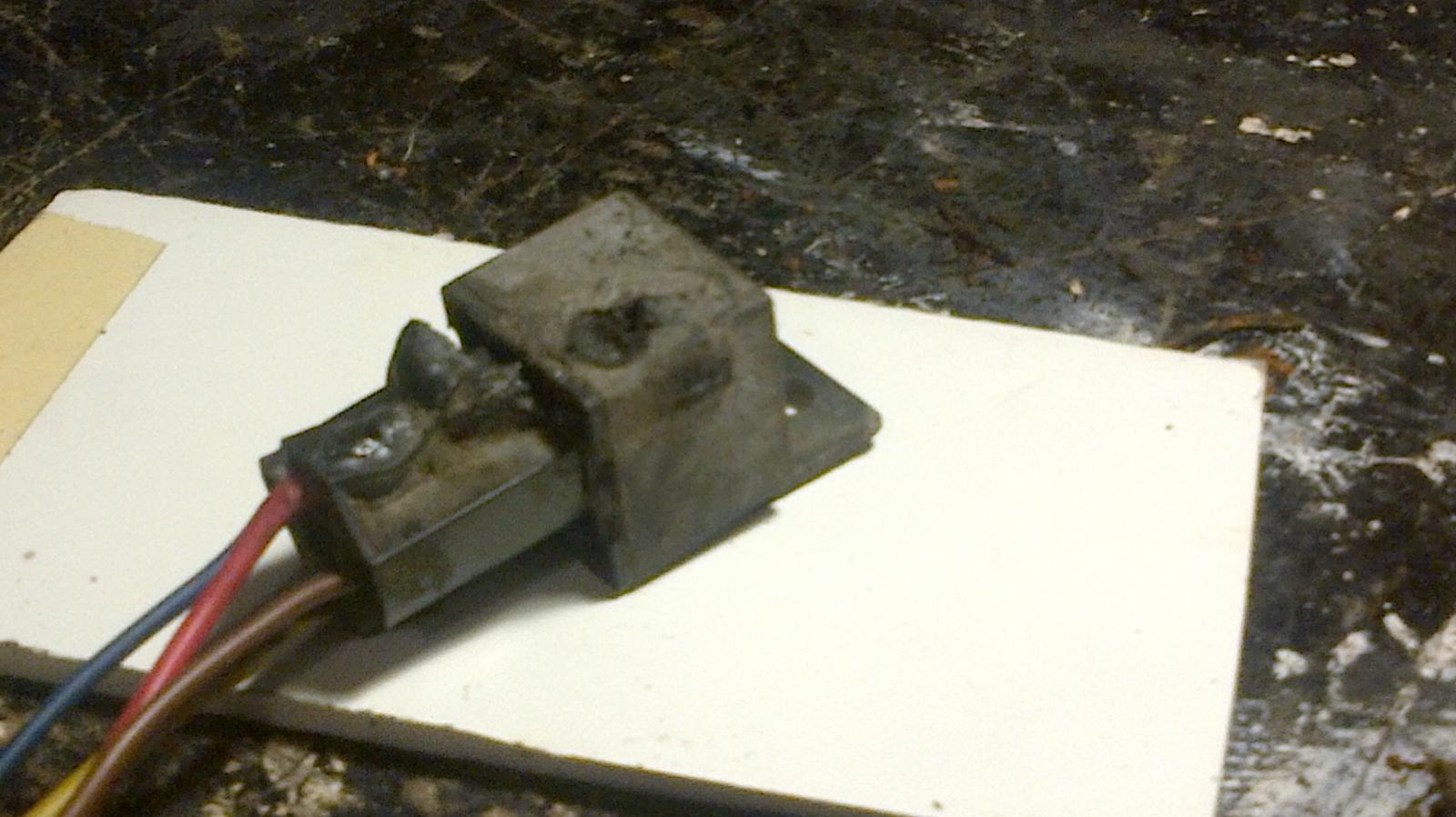

Bala wrote:
Show me one instance where a properly installed relay (not ford style) has failed like this.
Ok. Got me. How about this photo?

PostPosted: Tue Apr 30, 2013 1:05 pm    Post subject: Reply with quote
SGKent wrote:
I said properly installed relay. It's not a big surprise the a relay subjected to salty road water would fail. I don't mean to be disrespectful to the PO, but that is just a very bad idea.

Millennium Falcon is offline
PostPosted: Tue Apr 30, 2013 1:24 pm    Post subject: Reply with quote
I resemble that remark. I did have a rubber housing around the relay for protection, thought it would last. Obviously that was far less than perfect.
