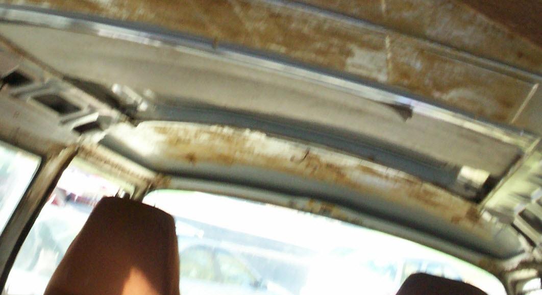

busdaddy
Joined: February 12, 2004
Posts: 53038
busdaddy is offline
PostPosted: Sat Sep 20, 2014 9:41 pm    Post subject: Reply with quote
shaunofthebus wrote:
...........just hoping someone with the headliner out might share a pic or take a look for me.............
Like this?: http://www.thesamba.com/vw/forum/viewtopic.php?p=7376877#7376877 (scroll down) Wink

PostPosted: Sun Sep 21, 2014 11:38 am    Post subject: Reply with quote
thanks for the input, fellow members. just hoping someone with the headliner out might share a pic or take a look for me. have to do it the hard way and start cutting.....
I'll see if I have any photos from my restoration but trust me, it is a heck of a lot easier to break out the voltmeter and report back on that then find out later it was a bad connector at the fuse box after you have made cuts in your headline. The headliner on a bus is pinched at the sides and wrapped under the windshield at the front. As Skills said, the original wire comes up the pillar and then goes along the channel and into the dome light. I believe that the ground goes back the same way.

PostPosted: Fri Sep 26, 2014 11:09 am    Post subject: thanks for the pics Reply with quote
yup, the wire has juice in it right before it disappears into the windshield post. so there is a break somewhere. going to have to find the junction even if i have to snake a new wire.
