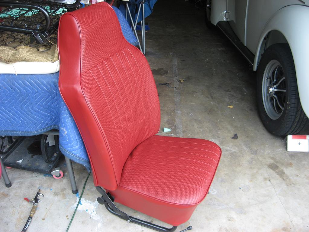

Can anyone tell me the difference between 68-69 front seats and 70-72 seats, they show as two different upholstery sets? I've got 3 sets of front seats, but some are 69 and some are 70, getting ready to redo one set of them...

I dug all three sets out of the barn and looked at them, and they are all exactly the same (other than being left and right of course), but I still don't know for sure if they are 69 or 70. I suspect them all of being 69, even though two sets of them came out of 70 cars. They had tags in the backs glued to the horsehair that say 113-881-775-H and 6-wo-69 below that. They also have large foam headrests and on the outside right at the base of the headrest there are two black trim buttons. Anyone know another way to pin down the year?

Thanks, that matches what I found.. I looked up seperate listings in the classifieds for 1969 seats and 1970 seats and compared the pics to mine and mine all appear to have the wider headrests. Turns out I have three sets of 69 seats, and the reason my two 70 Bugs could have 69 seats is because the runners didn't actually become wider until 71... So 68-69 seats will fit in a 70 car but not a 71, but 68-69 covers wont fit a 70 seat frame because of the wider headrests .. Tomorrow I'm going to stamp a little "1969" plate and attach it to the bottom of the seat so I dont forget all this mess a year from now..
