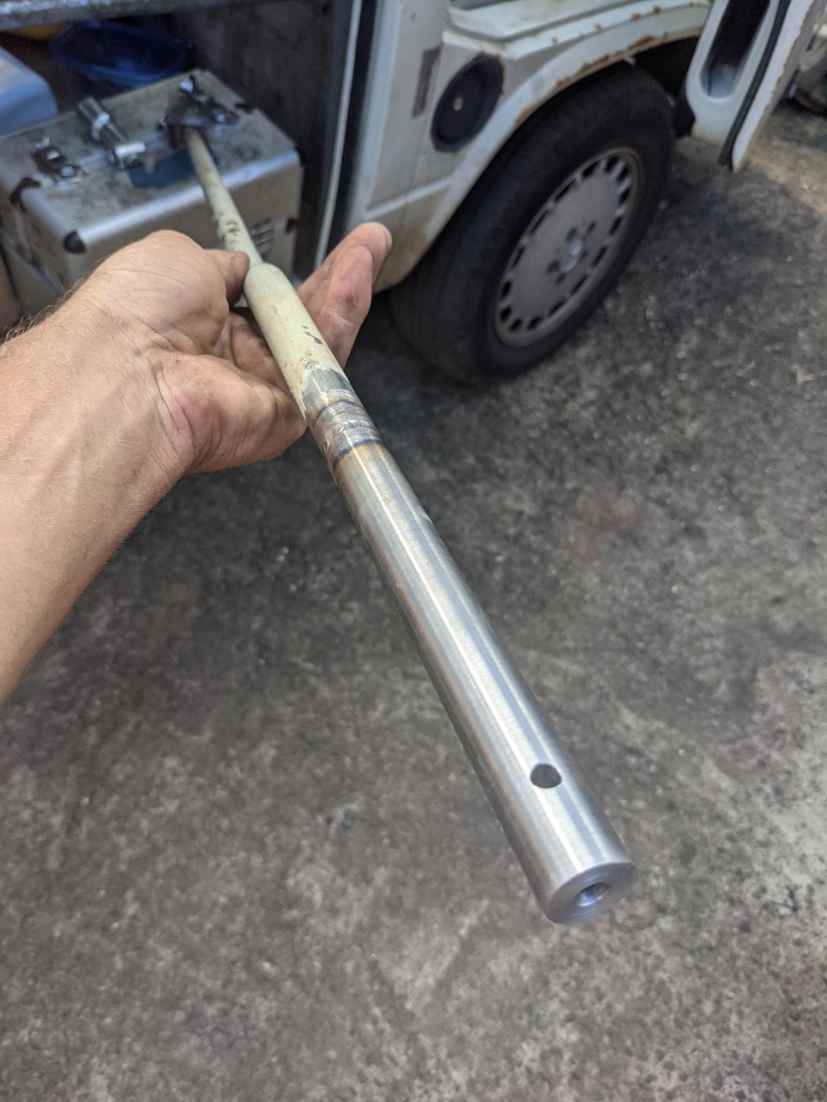

As an aside, coating the interior of the shafts with Wurth wax or sprayable sound deadener has made a huge decrease in noise transmitted by the linkage into the cabin.

Not using the aftermarket billet rear cup and extremely hard aftermarket bushings will cut down on the noise transfer too Wink

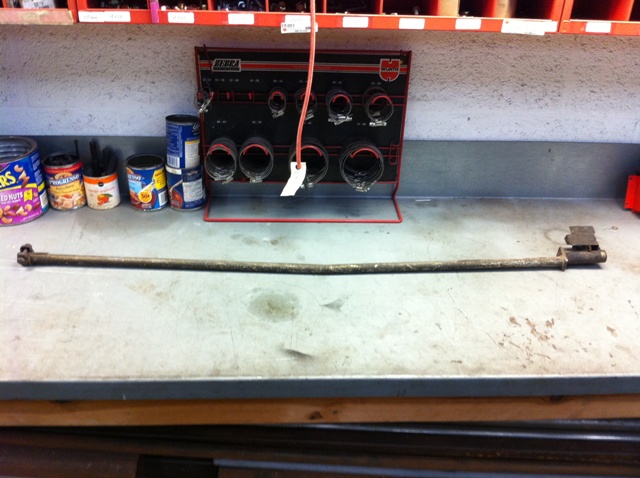

In the US market the early vanagons had a 3 piece shift rod setup. Add to that there were subtle differences between the air cooled and 82 diesel rear rod.
The noticeable difference for the early setup is the rear shaft. Rather than being supported by a bushing like the ones above, the rod slipped over a pin at the transmission. Here is a picture of my original 82 rear section.
You can see the pin lower right.

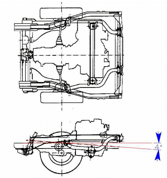

Here is a side drawing of a 2wd diesel. It shows the install angle. Not that it explains anything, but it looks cool.
SyncroGhia
Joined: August 21, 2009
Posts: 2458
Location: Highnam, UK
SyncroGhia is offline
PostPosted: Thu May 01, 2014 1:43 pm    Post subject: Reply with quote
The 2WD diesel setup moves the gearbox around all over the place.
Not only does the 2WD gearbox sit higher but the mount is in a difference place centrally.
The Syncro uses the same gearbox mounts on both.
Good to see it in a diagram Smile

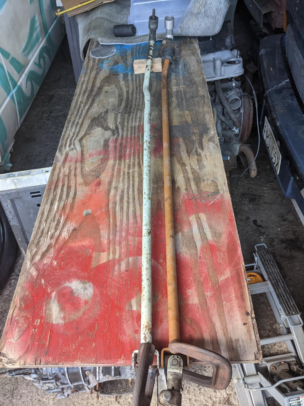

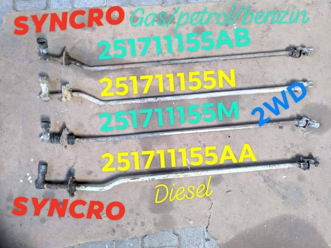

Hi guys!
here are all the rear shifter rods for the 091/1 and 094 transmissions.
It has the missing piece of the puzzle, the Syncro diesel shifter rod.
For all these years I thought there was only one rear shifter rod for the Syncro no matter diesel or petrol until I went to install the late diesel version of the Syncro diesel engine and transmission protection plate. The shifter hits the mounting rectangular tubing on the right side by the nose cone.
It`s now complete, I hope it will be helpful as there`s no pictures online of all together. Thanks Felix Buhler for the pic and the shifter rod, I added part numbers on it Smile

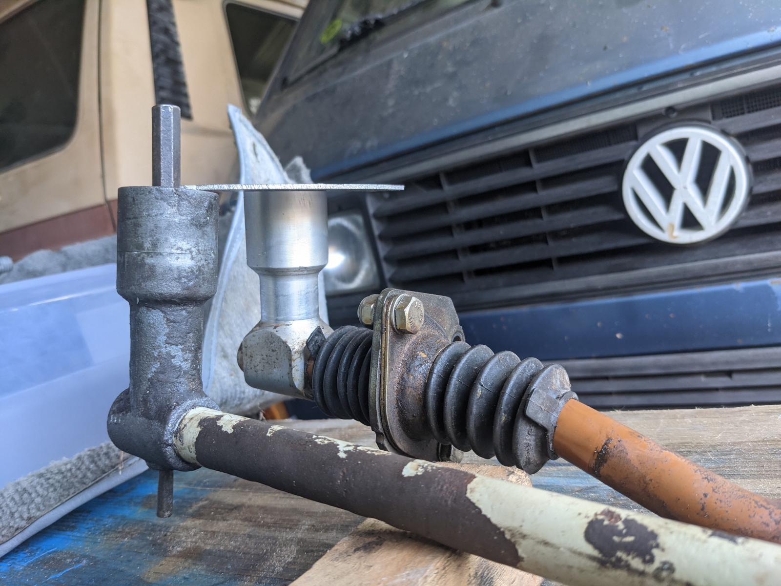

Follow up on this.

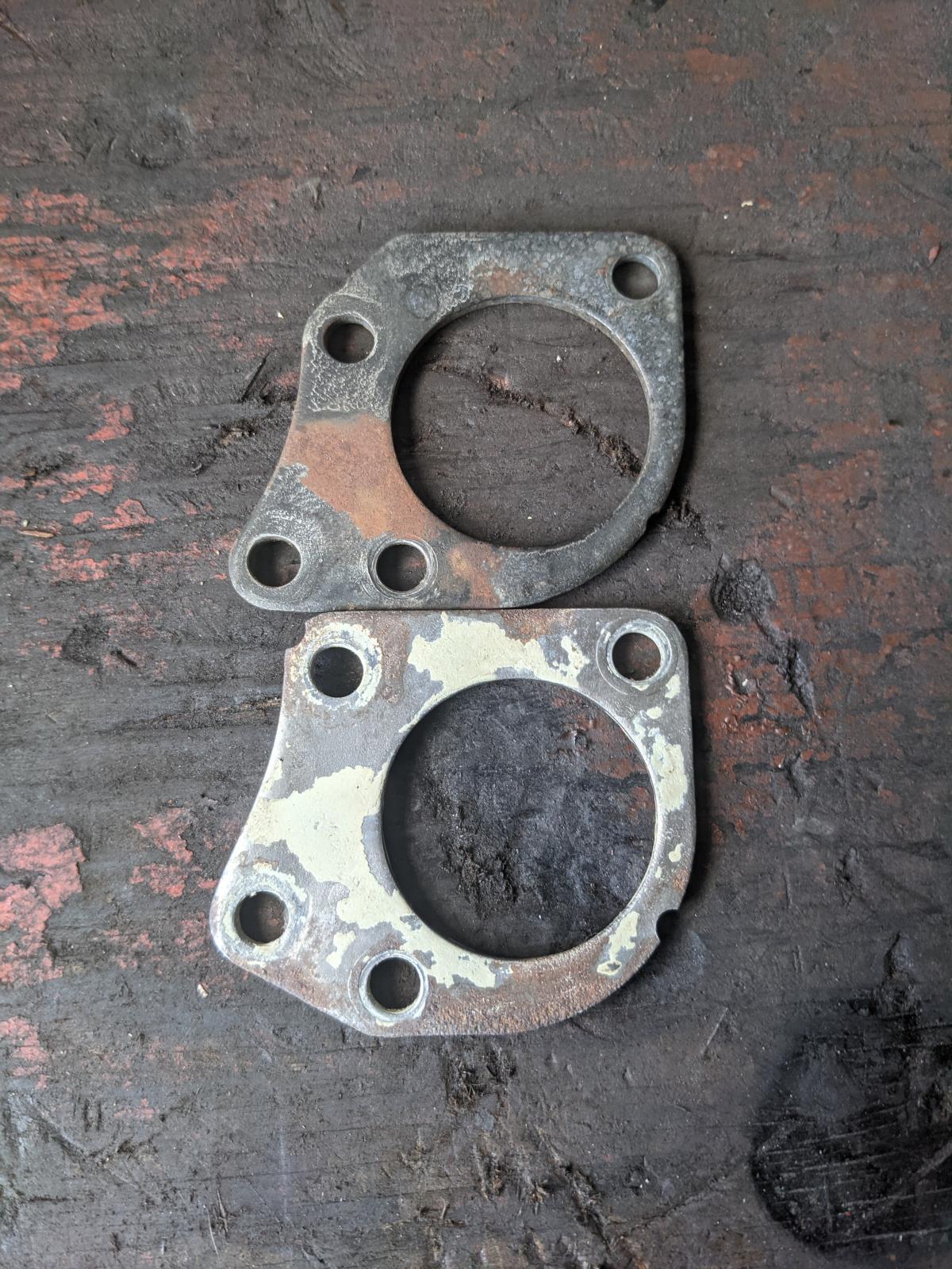

Un-accordingly to ETKA, the Syncro diesel does NOT use the petrol plate and shifter. I tried both for the sake of science on a Syncro diesel shifter.
Other members around the world who took pics for me confirmed they had the diesel selector cup and plate.
Petrol on top, diesel on bottom
This explains the 10mm difference between the petrol and diesel selectors, the diesel plate lowers the shifter position from the transmission by 10mm

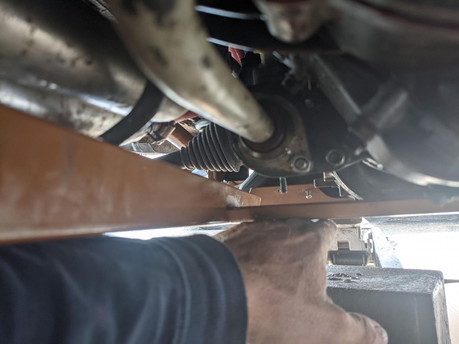

With petrol parts, the shifter is very close to the transmission, way too close for engineers to accept that...
Much better with diesel plate

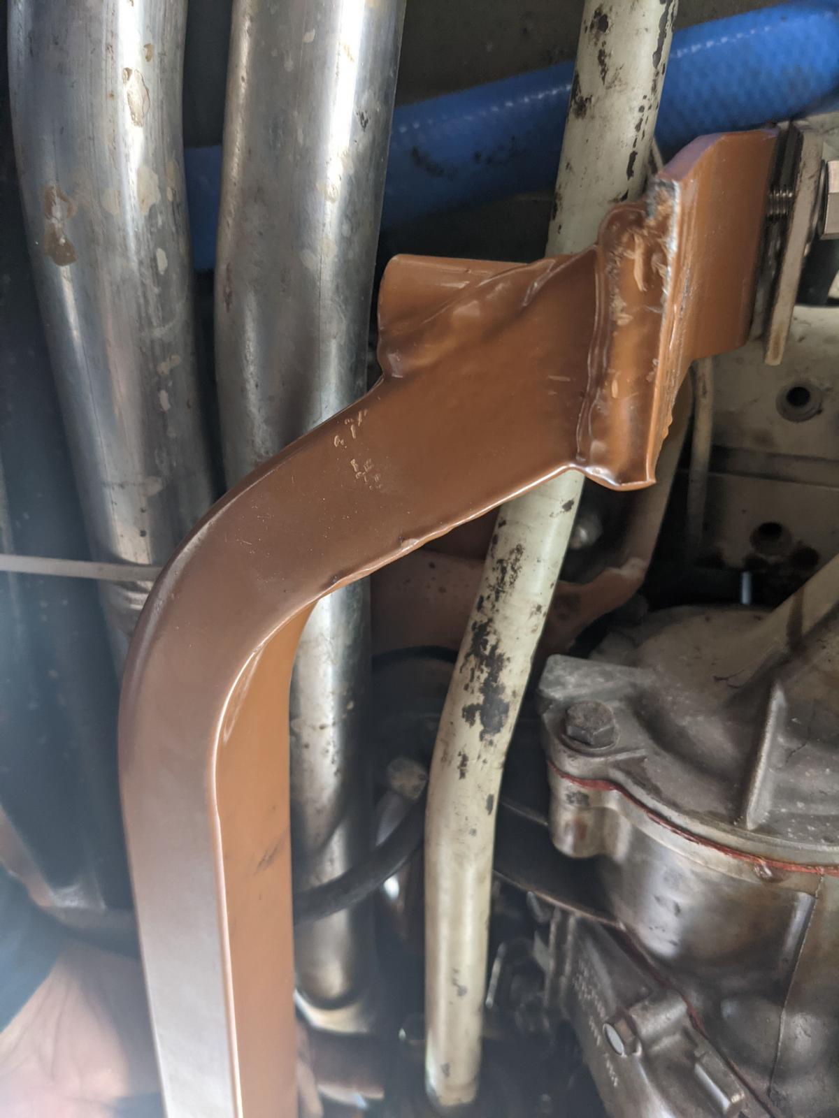

Why a diesel and petrol rear shifter when the transmission is in the same location? Because the petrol one hits the engine and transmission skid plate which is different than WBX, much wider.
They could have made a diesel syncro shifter for all Syncros, so I don`t really know...
Comparison of shifters between syncro petrol shifter and syncro diesel shifter
The syncro diesel is also clocked a bit differently at the selector.
Brown shifter is gas, white is diesel
That`s where you see the brown gas shifter would hit the skid plate mounting bar/elbow on the right side of the van.

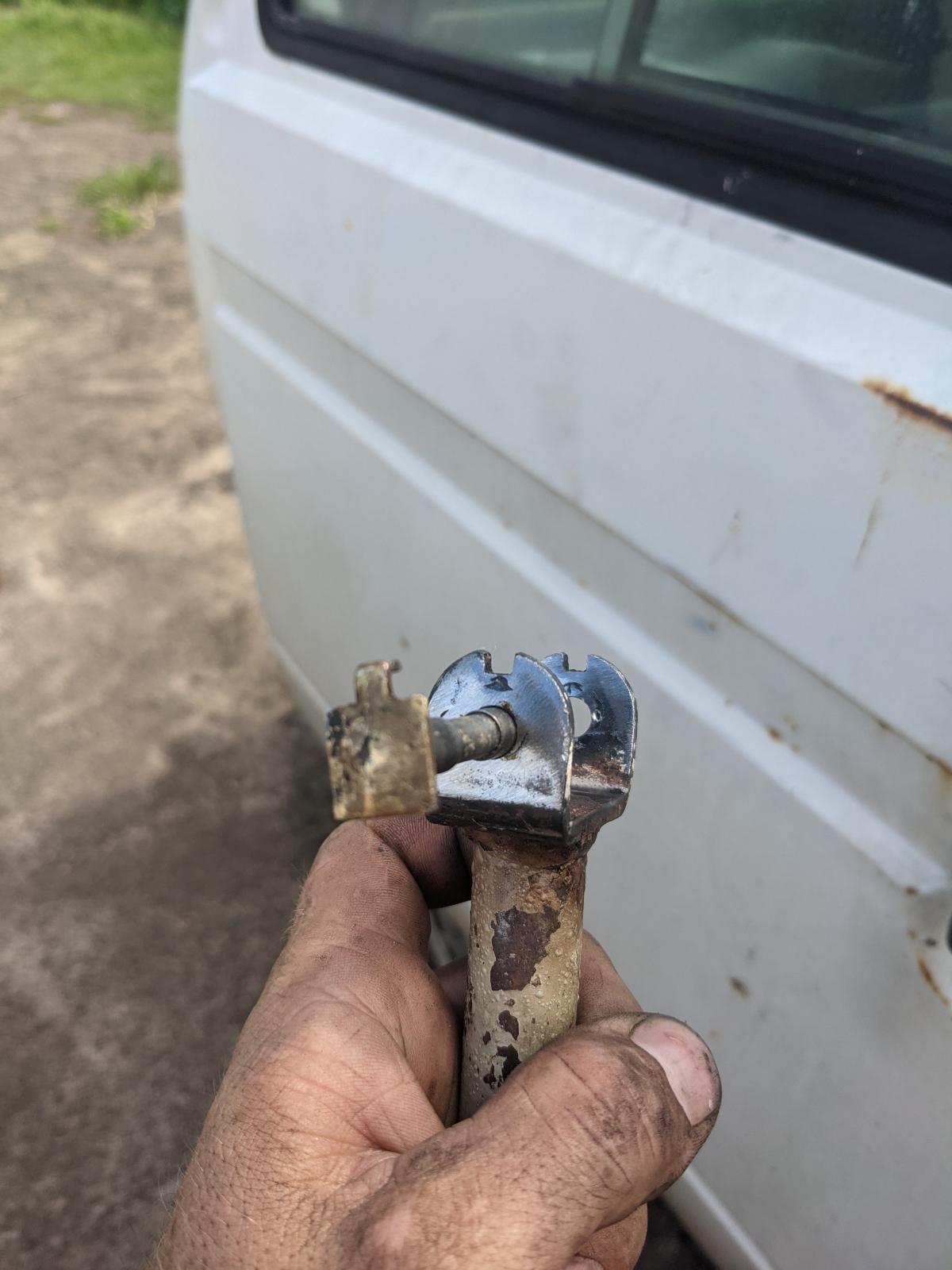

I also fixed the syncro diesel shifter I got from Germany, it was a zombie shifter!!
Before
Cut and welded a thick 20mm rod
This part had so much play, it got welded shut and redrilled.
I had brazed the head of the pin a long time ago too.

I choose the VW part for overlanding and put white lithium grease like factory this time.
I also use the VW brand bellows, the JP Group ones are mega junk, they will crack just sitting for a couple months unused, if you see them, boycott!
Happy Syncro diesel shifter!
Hawk eyes will notice my high tech selector boot, made of neoprene insul tube. This is 7/8 ID. Fits tight and lasts a very long time and much cheaper than the evil undersized junk found nowadays.

Hi all,
Apologies for dragging up this old thread, but can anyone tell me the purpose & function of this bushed gear linkage above the fuel tank in the 82 model?
Seems it was deleted and replaced with a direct shaft from 83 onwards.
MarkWard
Joined: February 09, 2005
Posts: 18586
MarkWard is offline
PostPosted: Mon Dec 23, 2024 8:00 am    Post subject: Re: T3 Gear linkage differences, petrol, diesel and Syncro Reply with quote
The early 3 piece shift did not have a universal joint like the later 2 piece ones. The area you ask about was to allow the early shifter to be moved downward to select reverse lockout. You’d need all 3 sections to make it correct. The diesel also had a different rear section from the gas models.
If you aren’t having shifting problems, you are probably ok.
