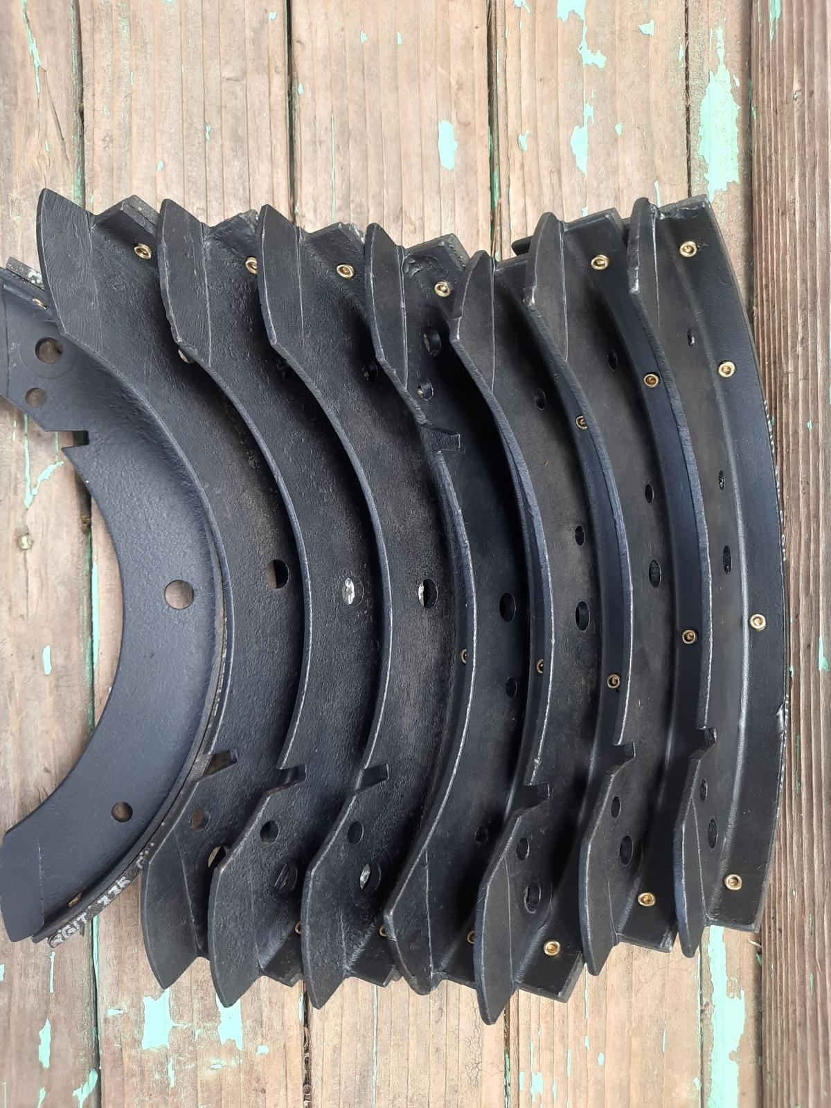

i had mine done localy for a 51 , i bought nos pads on the samba and this guy cleaned the old shoes n riveted in the new pads for 10 bucks a shoe , i thought was very reasonable , its called
L & M Friction Materials Inc in Riverside CA its just a 1 man shop that has been there for decades , took him almost 2 weeks to complete but i was in no hurry .
he didnt like the steel rivets the pads came with n used his own brass ones , they look SHARP !!!
