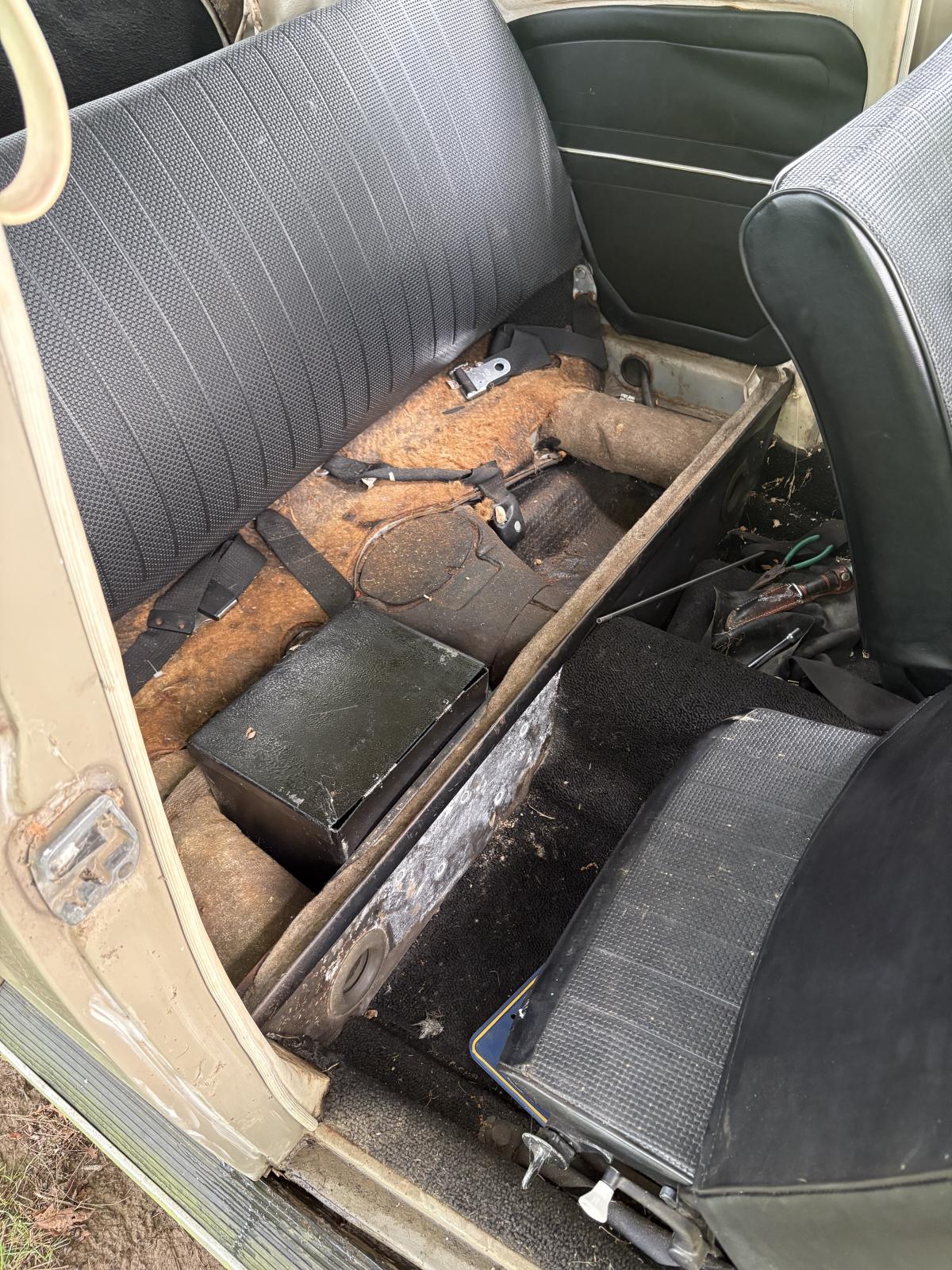

Came across this 66 on FB and figured I’d go see it since it’s the same year as my Bus. 1 repaint, og interior is under the seat covers in amazing condition.

The color is confusing me, it's definitely been repainted but I don't see an old re-paint going the lengths to remove everything in the interior, etc for paint. I can't find any overspray inside which makes me question what color is this car?

The color of the dash and interior jambs appear to be "Sea Sand", an original factory 1966 color. I can't tell from your photo if the outside was repainted the same color, or something "close"?

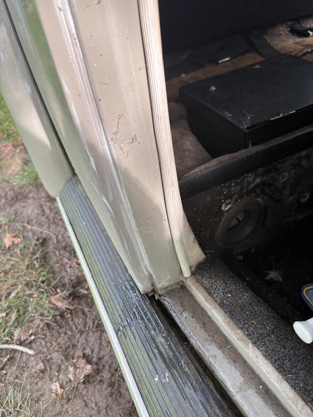

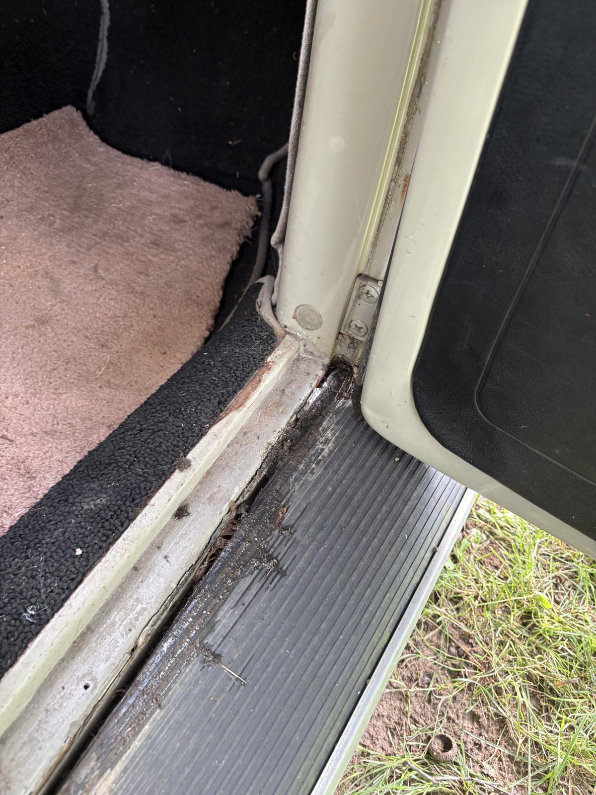

If you haven't already done it, I would suggest you remove the running boards and check whether the garbage buildup is just old leaves or corrosion.
It's a common place for the running board or the heater channel to start rotting away. A coat of anti-rust would help either way to help seal off that area.

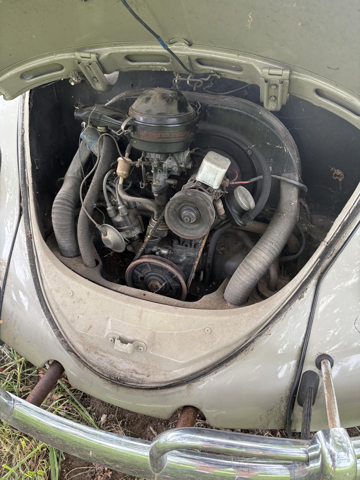

Nice unmolested Beetle. You likely have a carburetor/ distributor mismatch. It’ll run but you can do better with a factory match.

Thanks! That makes sense now, I was overlooking that color.
Good idea! I'll be back with the bug later this weekend and will tackle that. I think there's some bondo going on in there but if it's not too bad I may cut out and patch. I've done rockers on buses, should be able to figure this one out.

Pretty sure the carb is 30PICT/1 - will check distributor once I'm back in town. Do you know what the part number should be? I'm finding conflicting answers.

Stock distributor for a 66 or 67 bug should be a 113-905--205k or L. From your picture that may be it.

Needs the hose clamps on the fresh air tubes and the lower seals for those.
Do get a proper rebuildable fuel pump soonest.
Thanks! Always appreciate your advice on my Split Bus thread too. I've added the seals on the fresh air tubes. Rebuilding a square top fuel pump next week for the Beetle.

Here is the pre-heat tube grommet to put on your need to buy list:
https://www.wolfsburgwest.com/cart/DetailsList.cfm?ID=113119585A
