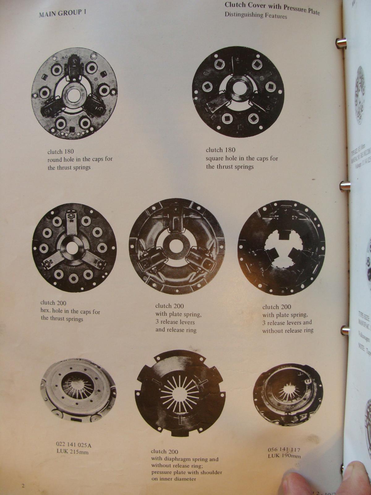

Well if you've removed your engine, then you've likely seen the pressure plate. There are three basic kinds, early, middle, and late. (There are subdivisions of each type, but I'll let you research that Smile)
Early pressure plates are usually operated by three sprung arms with a retaining ring in between them. See the top two plates below.
Late plates look like a bunch of fingers reaching towards a gap in the middle. See the bottom three plates below.
Middle era plates are like a hybrid of the two- they have the spring fingers and a retaining ring.

I include all this information, because after 40+ years these cars tend to have a myriad of parts thrown in. Each PP requires a certain TOB. PP and flywheel size have to match- your old PP should say on it.

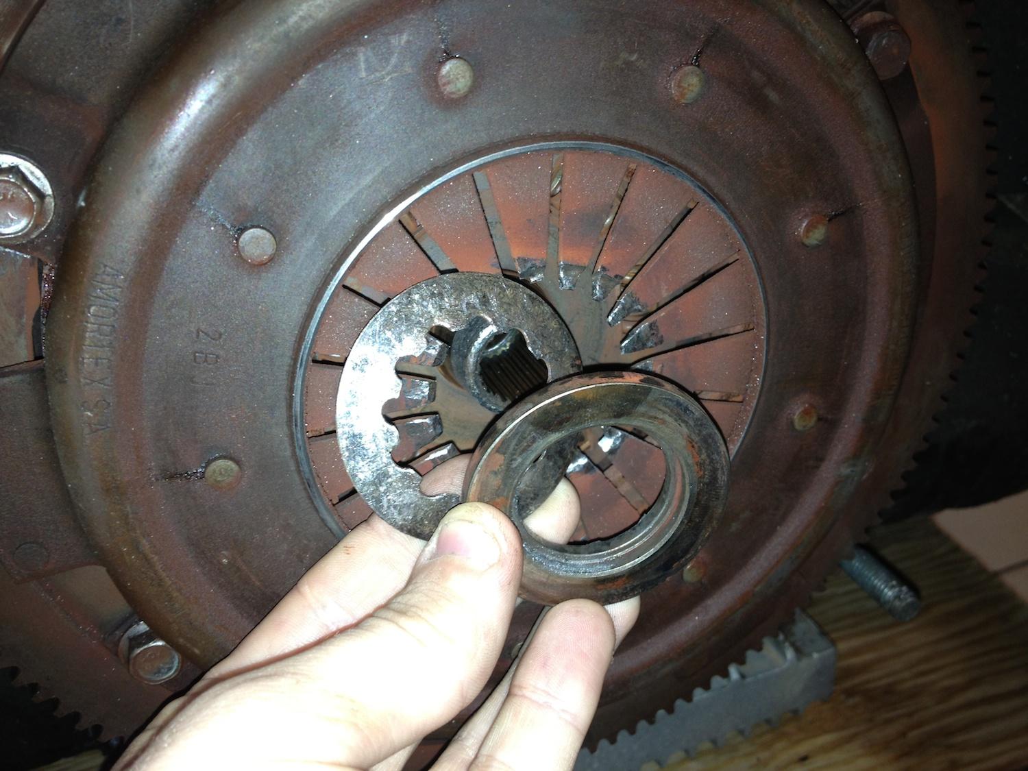

Well I think I found my culprit.
The pressure plate took a beating but everything looks in tack.

Yikes! Glad it didn't do any major damage but I can see where the junk in the washing machine sound came from! Mine just recently popped off as well (intact) because of those crappy clips. Completely stripped the gland nut.
Might be a good time to upgrade that operating shaft and replace the tranny mounts while you're in there. Warning, the clutch arm is a real pain to get off. I had to cut the operating shaft off to get it out!
