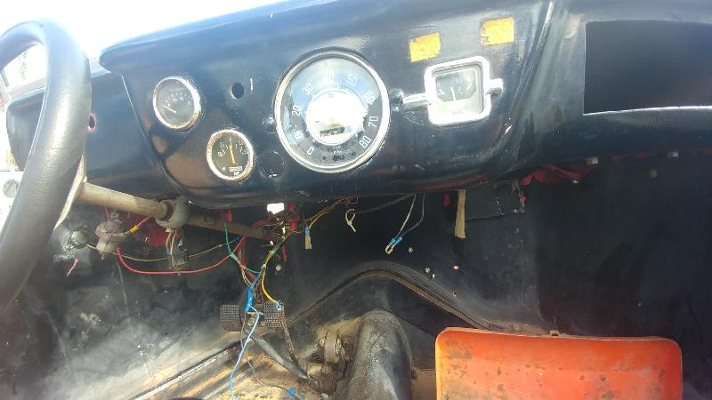

When I got it none of the lights or gauges worked. I've got the 4 lights up front working, the taillights and horn, but that's it. I downloaded a wiring diagram, but only some wire colors match up. Anyone able to give me an idea based on the pictures? Any help would be greatly appreciated!

For the chattering have you checked your bowden tube curve?
As far as the wiring that would be a remove and replace if I owned that buggy.

Have to agree with JPS if wiring is badly butchered, sometimes it easier to just start over unless you really like challenges...

Awesome! I too had wanted one since childhood and finally got it 3 years ago. Yes that is your typical Buggy rat's nest! Nothing time and patience won't sort out. I have mostly sorted mine but a new one might have been quicker.

I know the pictures of the wiring look bad, but I don't think it's as bad as it looks. There's only a few wires disconnected, and the others seem to be well secured. I suspect it was done pretty well, then someone got ahold of it that didn't know what they were doing. Not that I do, but to rewire the whole thing is more than I can atack right now. Thanks again for the comments, this by far is the most fun car I've ever had!

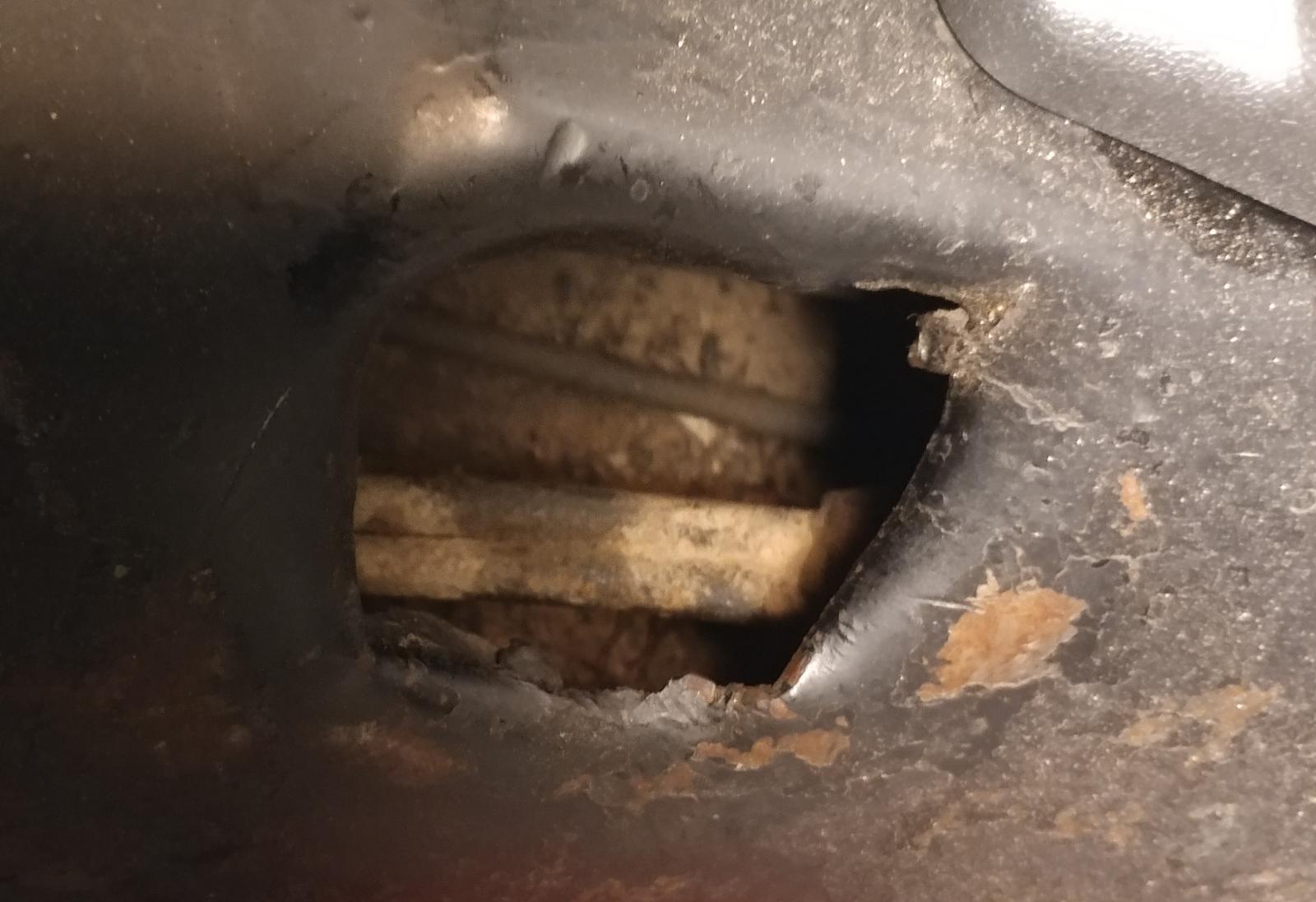

This can't be right. Do you have to remove the pedal cluster every time you loosen the clutch cable? I mean it didn't feel like it came off the "pedal arm" where it's connected. But now it feels sloppy and there's a clicking noise. There's not much difference in the curve that I can tell. I've got not started it yet because the clutch really feels weird.
Another thing is that there's stuff going on inside the tunnel that seems strange to me, one of the POs cut a hole in the passengers side of the tunnel and may have cut something. It looks like 2 metal tubes struck together that are just hanging in there. Can anyone give some insight to what that is? Thanks in advance!
