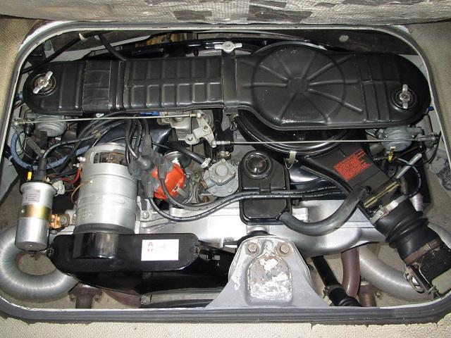

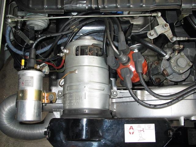

Thought I should share this with you as I am really stoked with how this conversion is turning out. I have recently installed the Bosch TCI-h system - from a 1.9l waterboxer, on the T-series type 3 engine in my '69 Notchback. (This is a standard, late model, 1600cc, twin-port, twin-carb engine.) The centrifugal advance curve has been adjusted to suit the T-series engine and the appropriate vacuum advance for this engine was fitted to the distributor. The vacuum orifice in the venturi of the left hand carburettor (VW 118-1) has been blocked off so that only the orifice below the throttle plate is in use. This is to create a load sensitive vacuum signal for the distributor. The digital idle stabilizer wasn't fitted as there is no load, other than the generator, on the engine at idle speed.
This system has been under test/in use for approximately 15 000 miles with no reliability issues at all. Some minor fine tuning of the advance curves has been done as I am gaining experience with this system. It is a huge improvement over the original points system. The engine starts easier & idles better - especially when hot, acceleration is smoother & there is a small improvement in fuel consumption. The conversion was prompted by the poor quality of points & condensers that are currently on the market - even good brand names like Bosch, Beru etc. I have had out-of-the-box failures with condensers and both my cars have been stranded on the side of the road as result of failed condensers. I use my cars a lot, so reliability is a big issue for me.
The parts used are as follows:
Distributor: VW 025 905 201 N
Rotor: VW 071 905 225 A
Vacuum advance unit: VW 043 905 271 (Perfutubo 473)
TCI: VW 191 905 351 B
Ignition coil: Bosch 0 221 122 023
Here are some picture of the installation:
