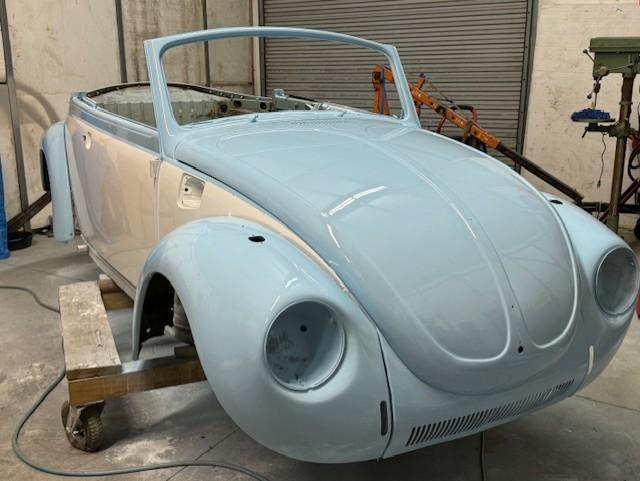

I just painted my 72 with shop line AU single stage for under $ 600
