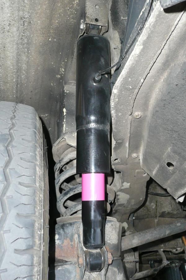

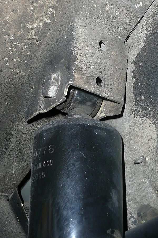

With the recent threads on shocks and airbags I thought I’d offer a look at what I’ve done. I have been using this set-up for more than 3 years now so I am confident that it works for me and addresses the issue I wanted to fix. YMMV as they say, so decide for yourself if this is a good idea or not.
I installed Gabriel Hijacker Air Shocks on the rear of my 84 Westy.

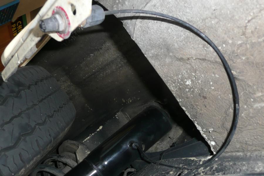

I used a separately purchased kit to be able to air up the shocks individually.
The air line runs to a valve that is mounted in a convenient hole already present on the lip of the fender behind the wheel.
I did this solely to be able to level the van left-to-right, either when unladen or fully packed for a trip. Like most, my Westy was lower on the driver’s side without an assist in place. The result is a level van that can be easily adjusted prior to travel or on the road. The hot pink tape on the shock body is so I can easily tell with a look if one or both shocks need more pressure. The actual adjustment is done with a pressure gauge and measuring stick – I do this about as often (and at the same time) as checking tire pressure.

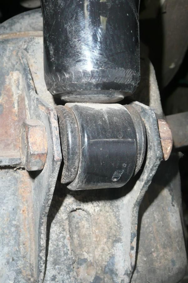

A concern with such an arrangement is the additional stress it may place on the shock mounts so I kept an eye on the top mounts…
and the bottom mounts…
I see no evidence of any problem with either.
This is obviously not a solution for bad springs nor appropriate for jacking the rear way high whether for off-road clearance or just bling. My driving is mostly on paved roads and never in true off-road conditions. I only use air shocks to level and thus there is no need to go crazy with air pressure, lift or the additional stiffness that would come with that.
Bottom line, the van sits level, the ride suits me and after three years it still rides fine. I make no warranty or claims as to the suitability of this for others, merely offer it as ‘what I did that worked for me’.

The exact shock I used is the MaxAir model no. MA758.
However, this particular shock is a longer travel version than OEM shocks.. and it is not a great application for stock height vans using OEM CVs. (The CV is not quite up to that extended angle range of operation)
And the shock may bottom before you bump stop does.. NOT good.
A better fit for your van might be the MA768.
That's 12" compressed, and 18.5 extended. Close to OEM.
(you can check your current shock lengths by compressing them and getting a measure that way)
That MA768 shock lists a LS26 and LS28 mount, top and bottom. You may need to shim out the narrower mount with a fender washer or 2... But the mounts on the van and the swing arm are both "clamp" style and are intended to be compressed in tension snugly around the shock bushing sleeve. There is some give to the mounts on the van, so you have wiggle room.
(In my fitment I chose to shave the shock bushing sleeve down a bit to fit better. The bushing sleeve was a 1/16" or so on the bigger side.
You have 12mm mounting bolts (not 1/2").. although they are pretty darn close.. the 1/2" mount version actually allows a bit of movement. I prefer the 12mm.
Here is a link to Monroe's fitment sheets so you can verify what I have said here..
http://www.monroe.com/assets/downloads/english/08_MountingLengthSheet.pdf
You will also want to check your shock mounts and bolts.. Although the mounts will not take up a whole lot of force over stock.. the added resistance as you pump up airshocks DOEs increase forces some. As long as you don't go curb hopping or dune jumping you should be fine (given the mounts and bolts are OK and rustfree)
FWIW.. the Gabrials are likely a very safe bet, too. Equal, if not better.

here's where I put my fill valve. Used the existing hole and the space behind allows for extra tubing etc.

So I've got the wrong bushing at the bottom. OEM sleeve and bolt I believe, but wrong bushing. Not sure if this is because I transferred the previous bushing and shouldn't have, or didn't transfer it, or what...but clearly this aint right.
Having trouble finding a suitable "hat-style" replacement on the web. Willing to switch over to 1/2" bolt/sleeve if necessary. But just not finding the obvious solution. Any ideas/sources? What should I do in the meantime...stack washers on both sides or something? thanks
Hey D!
I just saw your email on this, too.
Energy Suspension makes several different size "hourglass" shaped bushings..
Do a search on ebay.
They come as a single piece.. or as a double or split 2 piece bushing.
There is bound to be a size that fits this application and the hourglass shape will keep the shock eyelet centered on the bushing.
Measure the inside diameter of the shock eyelet.. and the distance between the tangs (shock mount on swing arm..
We can fix this.
-89 GL Westy, SVX.. finally.
-57 pan f/g buggy with a 67 pancake Type 3 "S"
"Jimi Hendrix owned one. Richard Nixon did not"
-Grand Tour, Season 1, episodes 4 and 5
We can fix this.
thanks, I was wondering about the hourglass shaped ones...wasn't sure if those were only for shocks that had hourglass shaped eyelets(?).

Steelhead wrote:
We can fix this.
They can be used if they fit snug... or better yet, I am seeing some 2 piece types that have flanges on them.. similar to what T3 technique sells as 2 piece for the control arms.
I am looking for Energy's master list.. I had it bookmarked but have lost track of it.
Here:
http://www.energysuspensionparts.com/table-catalog.asp

Shouldn't I be looking for something like this?
http://www.ebay.com/itm/2-Universal-Shock-Loops-w-...mp;vxp=mtr
I don't think you need the inner sleeve...
How about these?
http://www.energysuspensionparts.com/proddetail.asp?prod=9.9176
You can cut them down lengthwise to fit.. Have to measure the shock eye diameter, though..
Or with sleeves, here:
http://www.energysuspensionparts.com/proddetail.asp?prod=19601

Those might work though I need to fill up a lot of space with flanges of the bushings. Just under one inch in total (1/2"per side).
you know...I think I ended up with wrong Gabriels. Comparing the width of my eyelet to Awhanee's above, It seems I have narrower eyelet, which probably lead to me hacking upon install. Wondering if maybe I should start over with correct gabriels with wider eyelet.
You want the flanges of the bushing up against the eye so it does not slide around.. then maybe fill up the area on either side with fender washers.
"Hacky".. yes.
Compare model numbers.. If not the same, I'd also be concerned about length extended and compression.. check your order, too. A mistake in filling the order maybe.. gets you new ones.
[code]How about drilling out a pair of tall bump stops and trimming them down to right length? Nice long cones. will keep the shock eye centered and can customize size. hacky but might work well.[/quote]
Not sure which bump stops you are thinking of... but necessity is the mother of invention!
