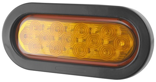

cuz im thinking about getting a "bunch" of Single LED Lights
(ready to hook up)
and i think just mount them in the holes (they are "open" light sockets)
with current resistors...
i have tried identical to this in the dome light
but it didnt work
once a couple mods happen
i will be hiding lights like these..(flush mounted from behind)
for turn lights
74 Mexi Swamp Thing. 70 square volksrod (Swamp Rat)..65 C10

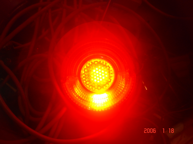

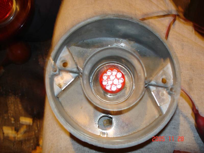

i did a write up on doing my tail light buckets on my t34 lights to LEDs a few years back.
http://www.thesamba.com/vw/forum/album_page.php?pic_id=243950
http://www.thesamba.com/vw/forum/album_page.php?pic_id=243951
did the front turn signals too

those are 1157 bulbs,.i updated the sockets to accept the 1157 bulbs which are a duel filament type bulbs instead of the 1156 type single filament bulbs.
the less bright light is the running light, the brighter is the brake.
i have two sockets converted per light so there is two per side now
still contemplating if i should do the top amber turn socket as well... we'll see..
