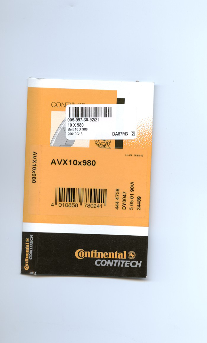

I recieved 2 Mercedes belt A0099975292 and turned out to be 10X980, to short. I e-mailed the guy you listed for belts, no reply.
I have searched the net for a 9.5 and 10 by 988/990 belt with no luck. |
This is curious as I've just checked with my local Mercedes dealer. I read out the part number and asked him to read out what the spec is for that belt.
He said 9.5x990 which would be useable with the aid of intake gaskets to take up the slack, however you have been supplied with 10x980...very odd.  _________________ John.

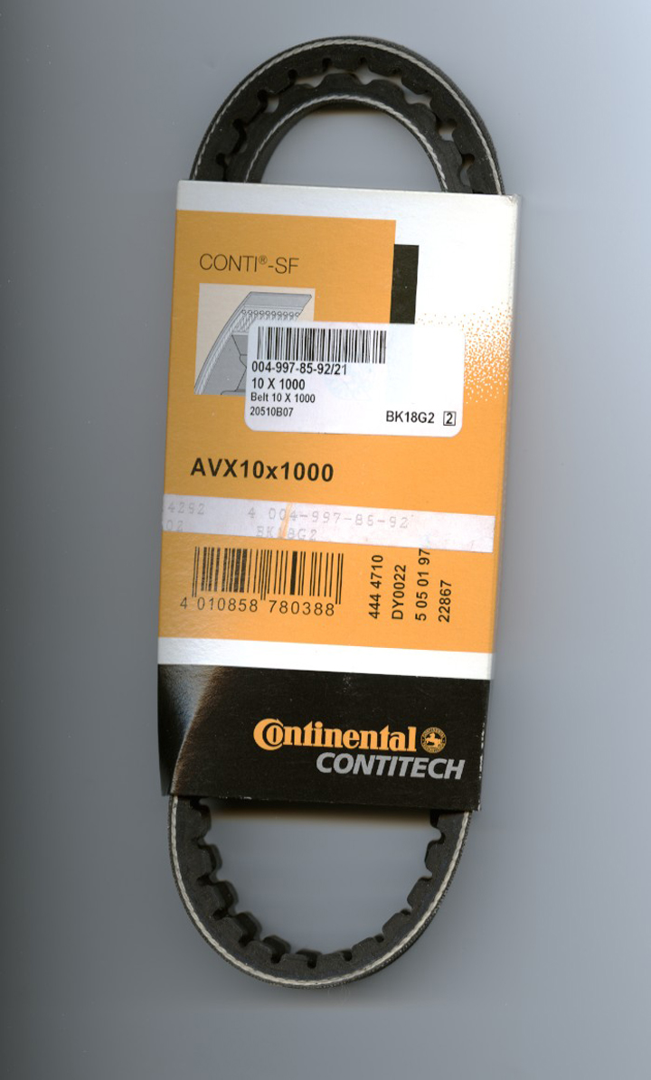

| For the record, I'm running Continental 10x990 double belts which seem to fit fine. I'm just wondering if the tensioner setup cuts down on belt vibration. |
