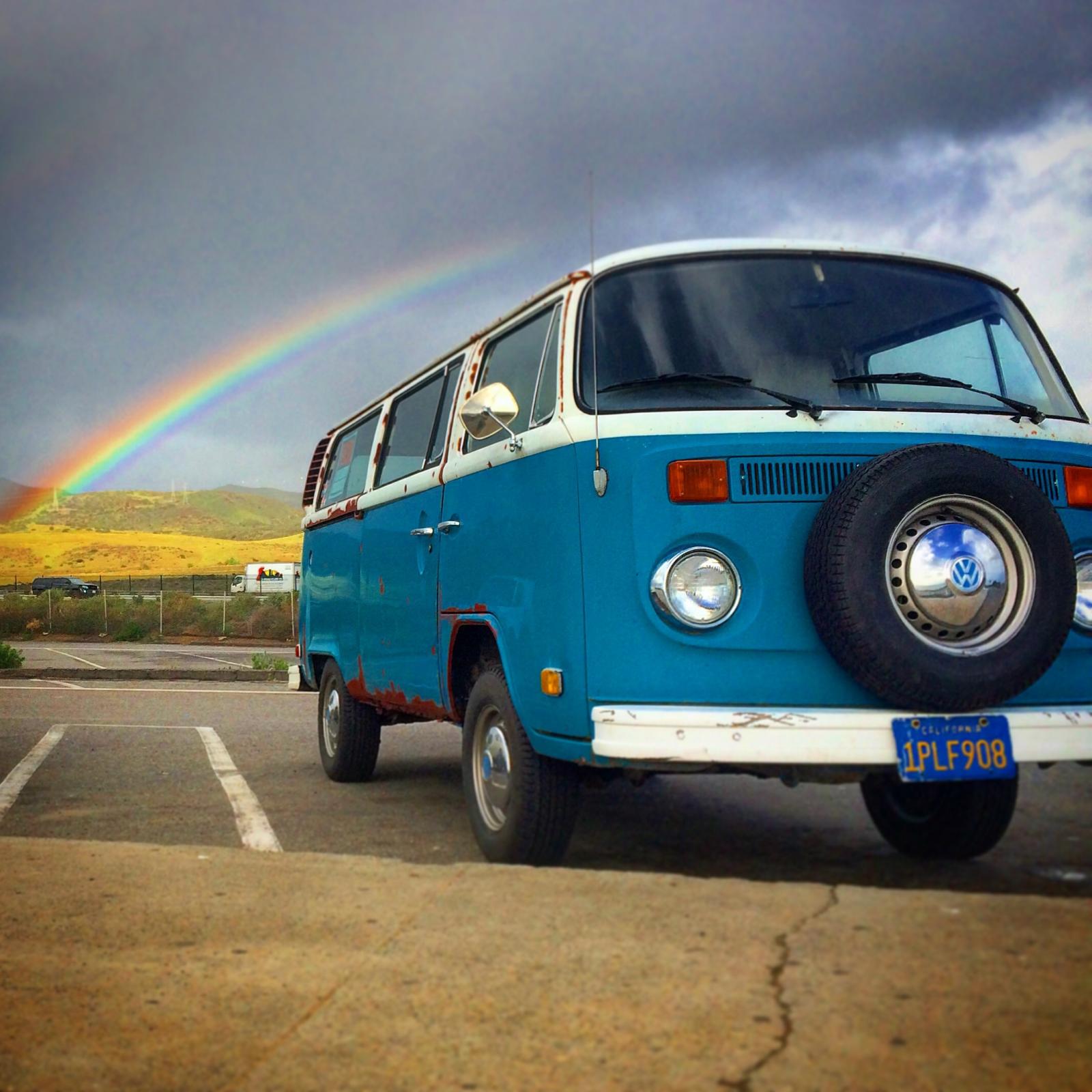

PostPosted: Wed Apr 15, 2020 6:54 pm    Post subject: Re: Spare general grabber tire question Reply with quote
nebe wrote:
Ain’t no way mine would be able to hold my spare that way. But as previously suggested, some stud extensions could make it happen. Is your spare also resting on the bumper? I do like the hubcap as opposed to a spare tire cover
Yes, the spare is resting on the bumper in that pic. That way the bumper takes almost all the weight, and the studs are mostly responsible for securing the wheel in a collision. You almost have to mount the wheel this way if you want it "hubcap out" without bending the nose skin significantly. There are also mounts that someone makes that use the front bumper brackets to suspend the wheel a few inches above the bumper and in front of the nose. Theoretically no contact, though I haven't seen one in person to inspect it for strength.
