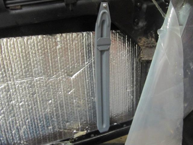

Here is what the bracket looks like as well the installed repro armrest on the driver's side. Make sure you get the plastic reinstalled. I was just test fitting the bracket at this point. The bracket works on either left or right side. This bracket fits my 1960. I am not sure if it is the same bracket for your later door or not. Perhaps others will chime in on that question. [img]

Sounds like you would need the later style bracket. It is actually more of a clip than a long style bracket. Give these threads a read for further info. There are some good pics of the clip/bracket and door frame.

I believe there was just one rear ashtray on the passenger side. Usually I have been able to reuse the panel clips but it probably would not hurt to have some extras. The passenger side should have the bracket welded in place on the door unless someone has removed it by drilling out the welds(unlikely). I think it would be difficult to see the bracket by just popping a corner of the door panel. I am not sure on that. The window riser and door handle hold the panel pretty tight and they can be a pain to install if they have the pins.

Now I'm seeking the parts for the armrest. I partially popped off the door panel and see that there is no bracket in place so I need to find one. Also, unfortunately, there are no punch outs nor marks on the back of the door panel for the armrest bolt locations. I assume I will have to measure very carefully to get them in the right spot.
