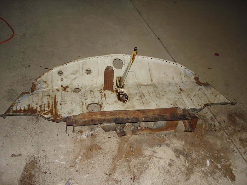

Whole floor... Funky Green from Bogota. Arrived yesterday.

PostPosted: Wed Jul 31, 2013 10:12 am    Post subject: Reply with quote
Still haven't figured out how the heater tube comes apart to allow the floor to slip over it. Help?

Posts: 71916
PostPosted: Wed Jul 31, 2013 10:18 am    Post subject: Reply with quote
On a '67 floor I took out there were a couple spot welds where the heater tube comes up through the floor and attaches to the piece that goes straight up to the dash, an inch or 2 above the floor. I ground those down and pulled the tube out the bottom.
I was working with a hacked front clip so the tube wasn't attached under the floor so you might have to separate that first.
Pic I made of spot welds:
http://www.thesamba.com/vw/forum/album_page.php?pic_id=235230
After - obviously not exactly what you are doing:
http://www.thesamba.com/vw/forum/album_page.php?pic_id=235859
Thanks...needed that!
