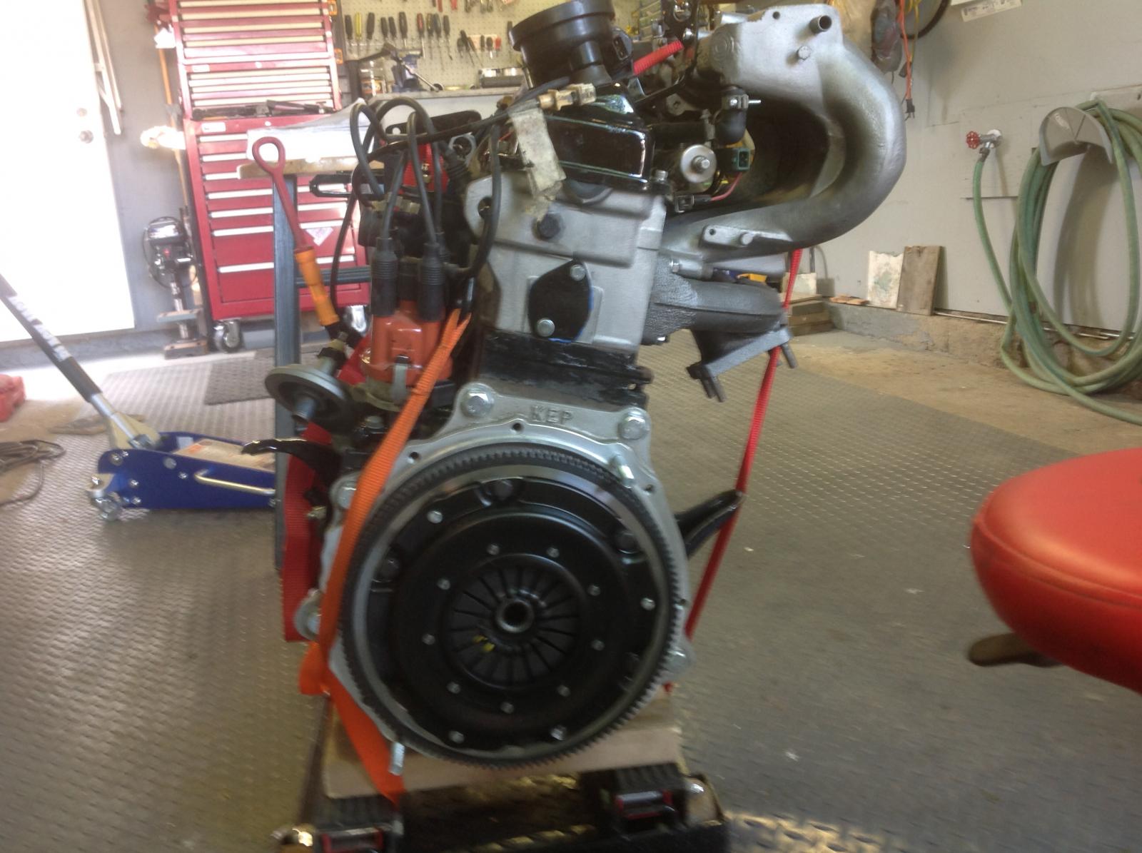

I cleaned up the motor, replaced valve stem seals, head gasket, rear-main seal and whatever else needed to be done including buying a new alternator and water pump.
I ordered an adapter plate from kennedy and began reading every thread and web page on conversions I could find.
I decided I would upgrade the 3 rib for a good used 6 rib transmission. I replaced all the seals and gave it a fresh coat of paint. I kept the 3 rib bell-housing and starter. Ordered a 200mm kennedy stage 1 pressure plate and sachs clutch disc.

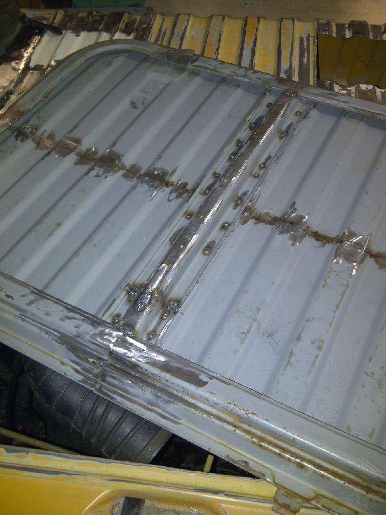

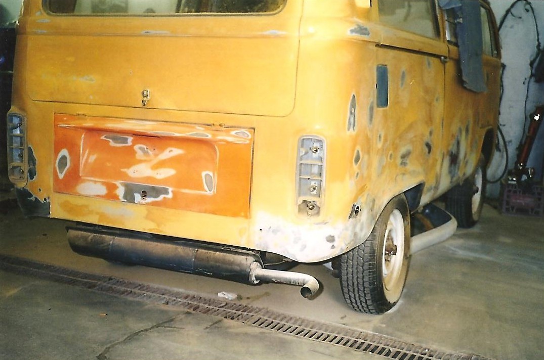

Having a 72 and no engine access panel was a challenge I wasn’t ready to take on with an engine swap. Out came the grinder and in went the access panel. I don’t know why I didn’t do it years ago. Maybe it was because I was 13 years younger and crawling through the back hatch to change plugs and tune the carburetors wasn’t as hard as it is today.
I tried using a bay access hatch and decided that it was too small especially given the effort required to install it. I wanted something that would be larger and went with a metal vanagon hatch. I removed three or four inches in width and in length. Removed the support brace and welded it on the vertical plane so it wouldn’t interfere with the throttle linkage of new motor.

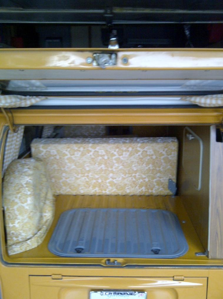

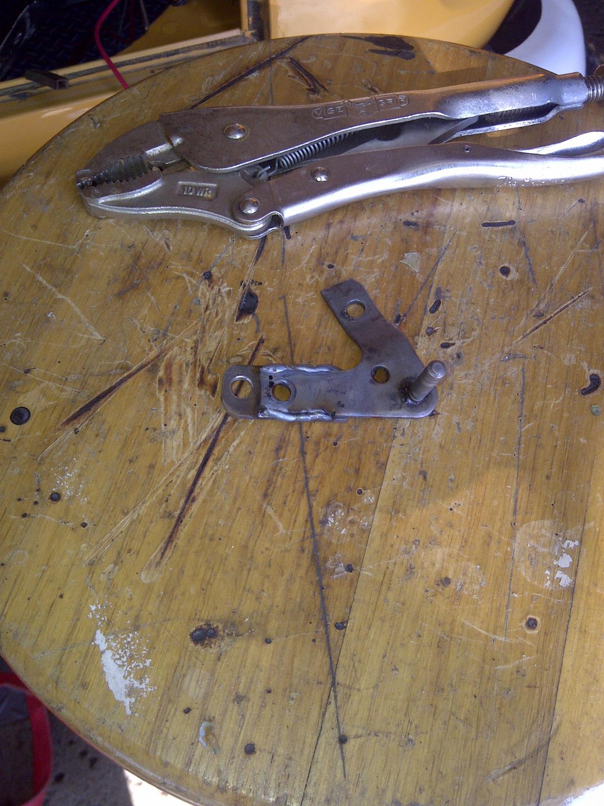

Here are some more pictures of the hatch I made.
I then started fixing the access holes that the PO had put in the rear deck for the fuel lines and fuel filler hose. This gave me a real chance to try my new welder. I couldn’t get anywhere with just the flux core and decided to borrow my neighbours argon tank. It was like night and day. I could control the heat much better. Later that week I went to buy a tank for myself.
I think it turned out pretty good for spray can colour match.

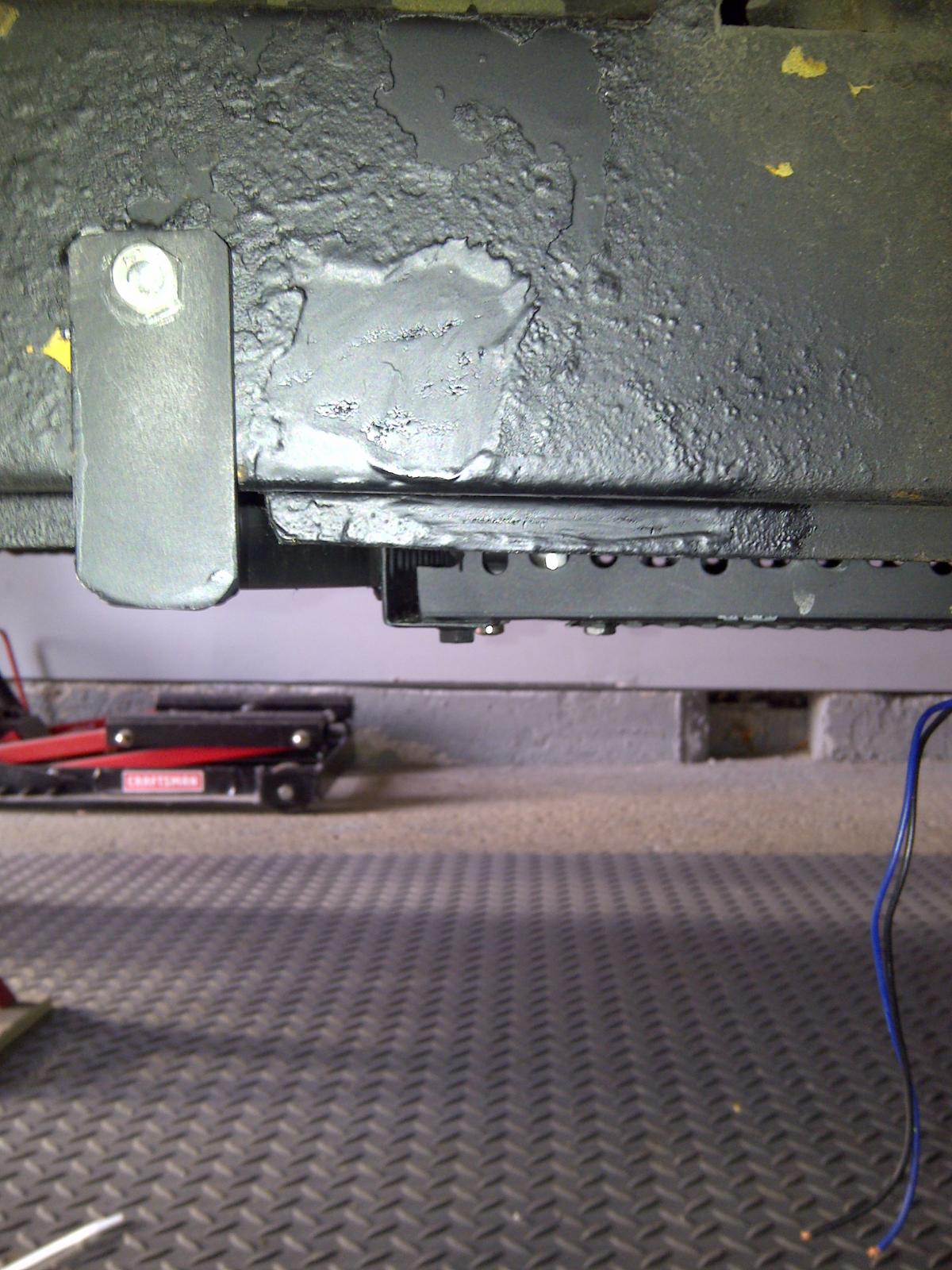

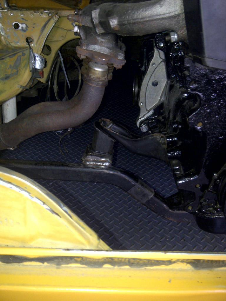

Between welding, sanding and painting the rear deck I tackled the engine mounts. I decided to use the VW fox engine mounts with the bus engine carrier bar and bus engine mounts (cut and flipped). I moved the engine carrier bar forward to line up with the engine and welded it to the frame rails. (If I had my time back I would have drilled and reinforced the frame so the bar could be bolted as per stock mounting points of the air-cooled motor).

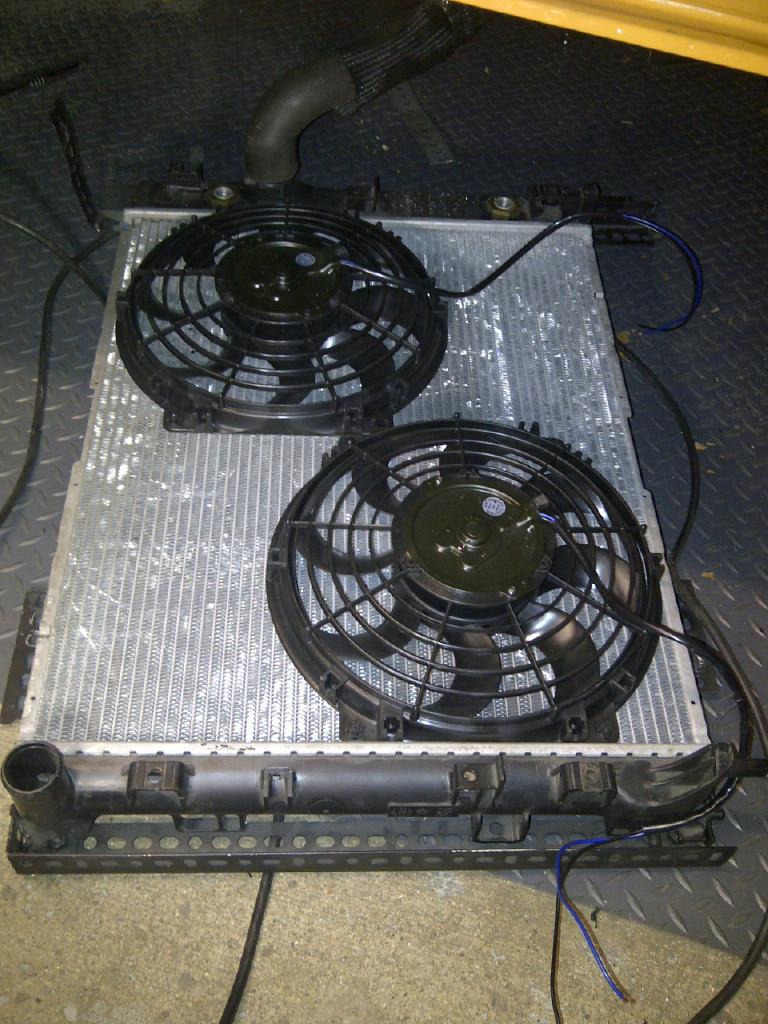

Next on the list was the rad. I wanted it to be tucked up as high as I could go with the fan on the top pushing down. It needed to be hidden but functional.
It was a pain in the butt to work on given my bus is lower than stock. The rad was a kijji find (your version of Craig’s list). It was brand new. It is from a v8 dodge Dakota. I also found a good deal on a big single electric fan flex-a-lite 398. I installed it but didn’t like the fact it interfered with the shifter rod unless the rad hung down further than I wanted.
I decided to purchase two smaller flex-a-lites – model 392. Combined they have almost the same CFM as the larger fan and they could be placed on the rad to stagger the shift rod and therefore allowing me to tuck the rad up higher. The fans are controlled by a jegs adjustable fan control kit.
Insert rad second version.

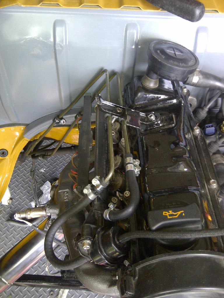

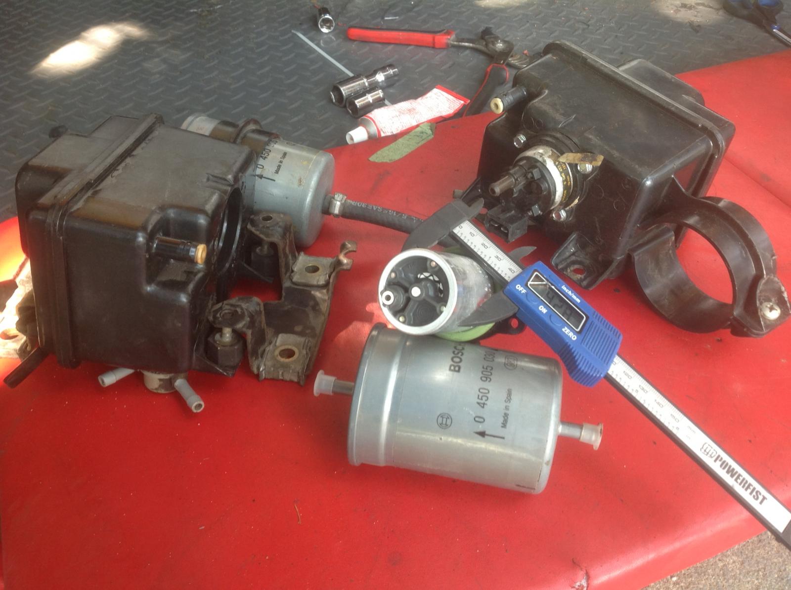

I also added a fuel return line to the tank. I ran as much steel fuel line as I could from the fuel rail on the motor back to the tank. It got a little tricky bending it all but I think it worked out. Double-clamped for extra safety. You can see where I damaged my newly painted firewall with the brake booster outlet on the back of the intake. That firewall was painted three times and when I was installing the motor with the intake on it got damaged again. I thought of removing it to repaint again but there is no way that is happening with the motor in.
I was originally going to use the MK2 fuel pump and fuel box. I tried installing it under the bus and it just didn’t look tidy. I actually have two of them and supposedly one is only 6 months old.
I bit the bullet and bought a late bus/vanagon electric fuel pump and installed it on the frame rail the same way it is done in a FI bay window.

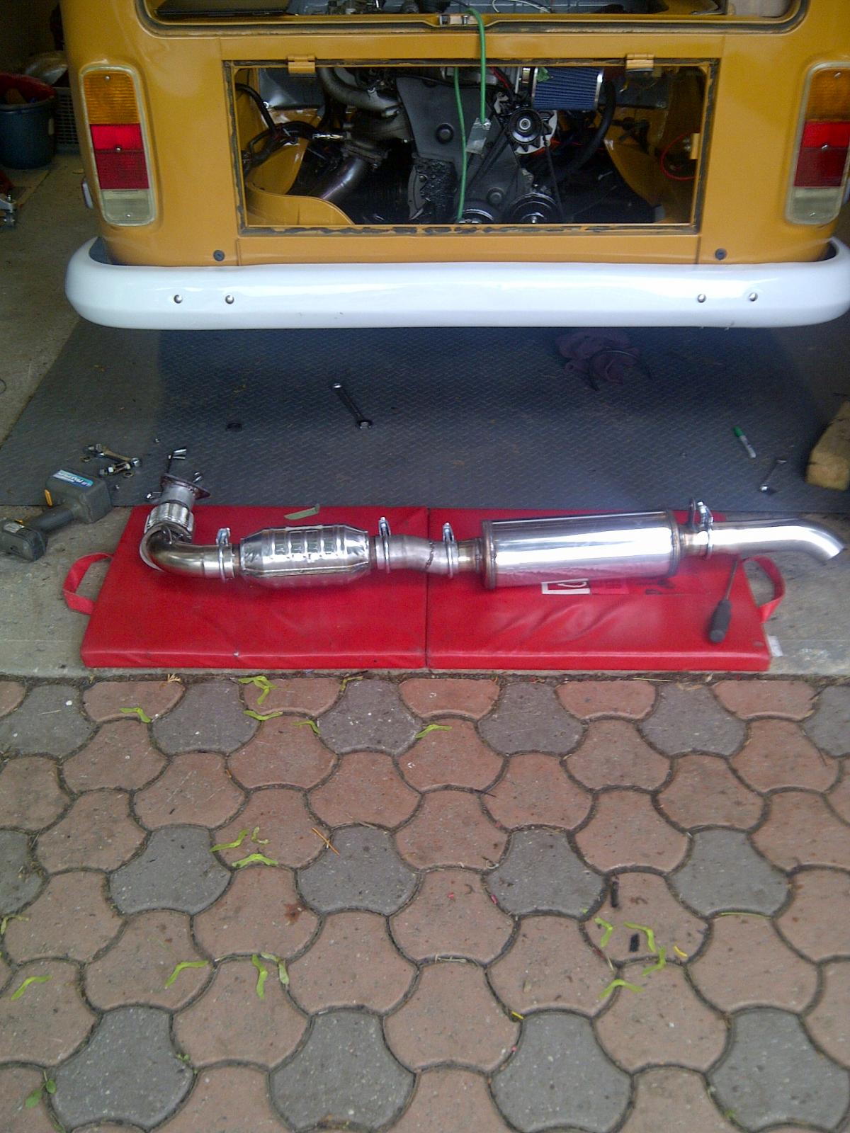

Once the engine was installed I had to work on the exhaust. This required a little trial and error and in fact I’m still sorting issues with it.
I first attempted to use the manifold and dual downpipe from a MK2. The angles along with the engine mount didn’t work out (or I ran out of patience) so I switched to a single mk3 manifold and single downpipe.
Insert picture of dual downpipe.
My neighbour helped with the fabrication and welding. We used 2.5 inch mandrel bent stainless left over from his hot rod build for the downpipe ( a tad too large but the price was right and we had it on hand). I ordered a flex pipe for a Chevrolet Malibu from the internet that had the right bend it for the turn and bolted on a magnaflow polished cat and muffler. It looked really good but was too loud.

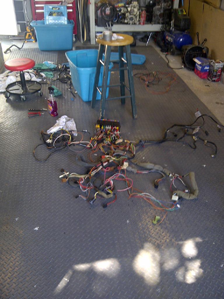

I then moved on to wiring. It was like trying to sort through spaghetti. This was the part of the job that I found most intimidating. I actually finished most of the job myself but called in one of my friends from our local club to help with the wiring of the relays and fans.

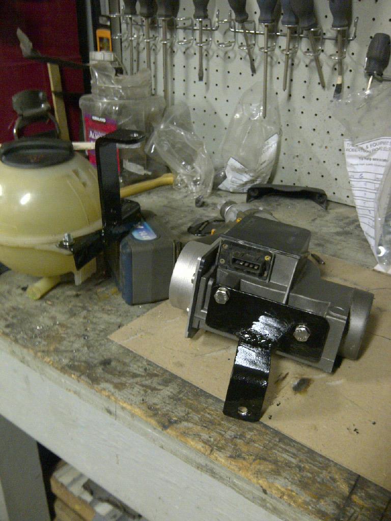

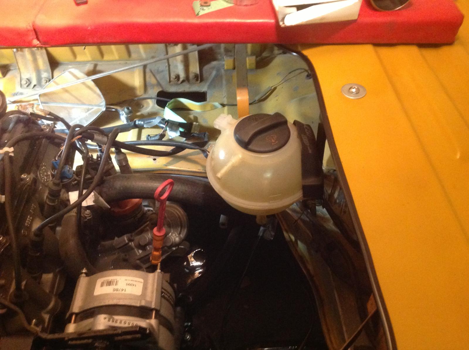

You can see I decided to install the ECM in the driver’s battery tray. I thought the wiring harness fell there naturally and looked cleaner. Bendejo has his installed in the same place.

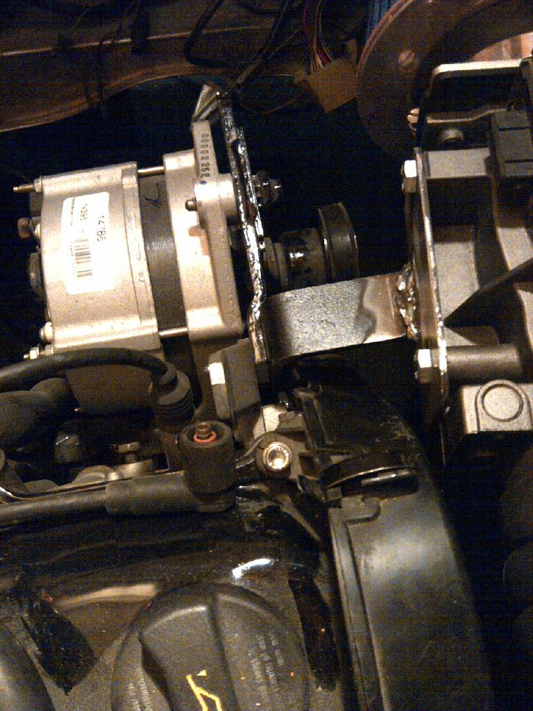

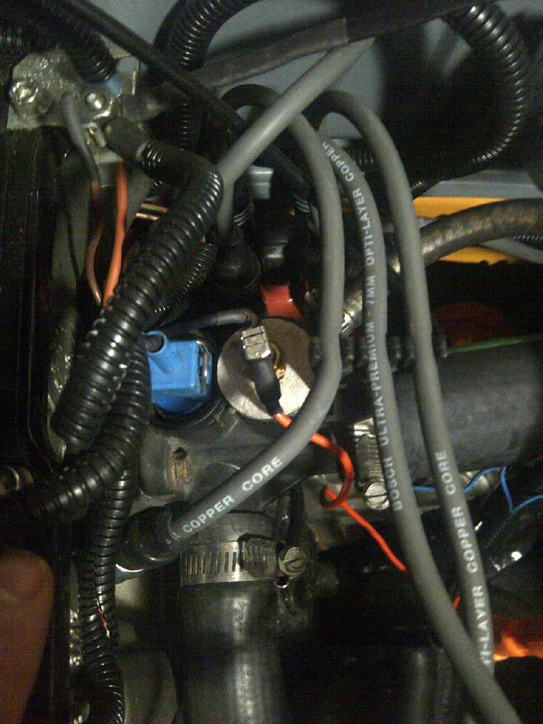

I stole Krautski’s idea for my intake and welded a small bracket to the alternator bracket. It worked out well.

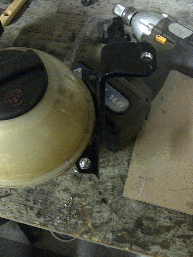

I also copied his idea for the overflow bottle and installed it with a bracket I made through the deck lid.

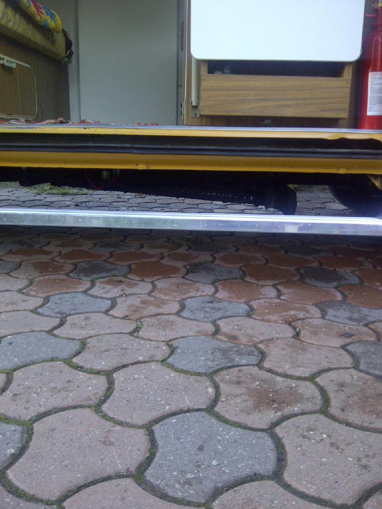

Wait, Wait!! So the radiator is mounted underneath between the frame rails? Can you take a pic of that for me as I'm currently mounting my rad and gave up on the undermount solution as it hung down too far... on a stock height bus!

Don't worry those pictures are coming. I have been watching your thread and wished I had done the same as you and posted daily.

It ran really well but as suspected above the exhaust was a tad too loud. There was a horrible drone at about 60-65 mph. I couldn’t hear the kids in the backseat. Perhaps not always a bad thing.
I also had an issue with the cooling system. While it didn’t overheat the fans had to be on constantly in order to keep it under 200 degrees.
I decided to remove the cat and replace it with a vibrant performance polished stainless resonator. It really quietened things down but not enough so last weekend I removed the magnaflow and went on the hunt for a quieter muffler. While searching the local u-pick I found a small round muffler on a Chrysler New Yorker. Turns out it was the same one I was contemplating ordering from Summit Racing. It is a walker 18253. This muffler is a perfect fit for a bus. Now it is whisper quiet on idle and much quieter on the highway. No magnaflow drone! Here is the link for it.

I’m still working on the rad and cooling issues. It has been very hot up here since it has been back on the road (100 degrees) and the fans are on too much. I don’t think it is getting enough air-flow. I lowered the rad by about 2 inches in the front, added a small spoiler and sealed the space between the rad and the frame rails the best I could. The spoiler was a u-pull find from a Saturn. It seems to have made an improvement but the fans are still coming on the highway. I may have to lower the rear or go back to the drawing board. The pipe wrap you see zip-tied is there to help stop the hot air from coming back up into rad. It is temporary until I figure things out with the rad.
Otherwise, looks great!
So, how does it drive in comparison to stock? Is it a daily driver? How far have you pushed it on a hot day? How well does it cool?
(ps, I'm that guy who posts every day after wrenching in the garage, but mostly it's cause I'm a noob mechanic who likes advice from the peanut gallery, AND cause I have a crap memory... My threads let me go back and see what I did. I'd be lost without it!)
Take a look at the fellows speed shop design radiator. The scoop barely hangs below the rails, but you must cut a hole in the main leg of the ladder frame for the return. They sell a kit that makes this feasible by gusseting the area around the hole. It is a nice design that isn't too complicated and works quite well for the intended engine.
Marshall
"Consistent maintenance with quality products is the cheapest warranty you'll ever need."
1977 CE1 Transporter Deluxe, Subaru EJ22, Skills Cooling, Steedle HD 091 w/ GuardT .82 4th

Webwalker,
I tried searching for fellows speed shop and all I could find was a shop own the uk where the rad costs 400 pounds and there were no pictures of a rad installed.
Is this the one you are talking about?

Sloride wrote:
Webwalker,
That's the one. There are pictures, but the majority are on their Facebook site. As with most solutions, it is custom built. Once you see how it goes together and that it WORKS and keeps the engine cool....well, you can't patent physics. It is simply brilliant in its simplicity.
I've uploaded a summary of the pictures that I've pushed up to the gallery here:
http://www.thesamba.com/vw/forum/album_search.php?...ts=summary

I'm so relieved to see some familar names responding to my post. I was starting to think I was getting the samba conversion cold shoulder.
I trust you all approve of the project and can appreciate your ideas being paid forward and used elsewhere.
Dan, we are all planning to come to your show this weekend. You'll be able to check it out in person.
As for putting a hatch in a 72 you could make do with a baywindow hatch if you can't find a vanagon one. My orignal plan was to put a bay hatch and surround in but it just seemed like the same amount of trouble to graft it in as the vanagon hatch and the hole isn't quite large enough.
When cutting the hole don't do like I did and make it square and then have to go back and weld the rounded corners back in.
Craig

There were a couple of conditions that I had to meet when doing the conversion and I believe for the most part I respected them all.
1. The bus couldn’t appear to have an engine swap i.e. no rad on the front bumper.
2. The least amount of modifications to the bus the better. Everything had to be easily reversible if I wanted to go back to air-cooled.
3. Lastly the motor had to fairly inexpensive, a decent power upgrade, all conversion parts needed to be readily available and it had to be easy to work on. Ideally it would be VW. Silly I know - but somehow I felt I need to respect this.
I took the same approach with my conversion. Yours looks really nice, well done!
Have you considered any ducting under the bus to channel air to and from the radiator?
