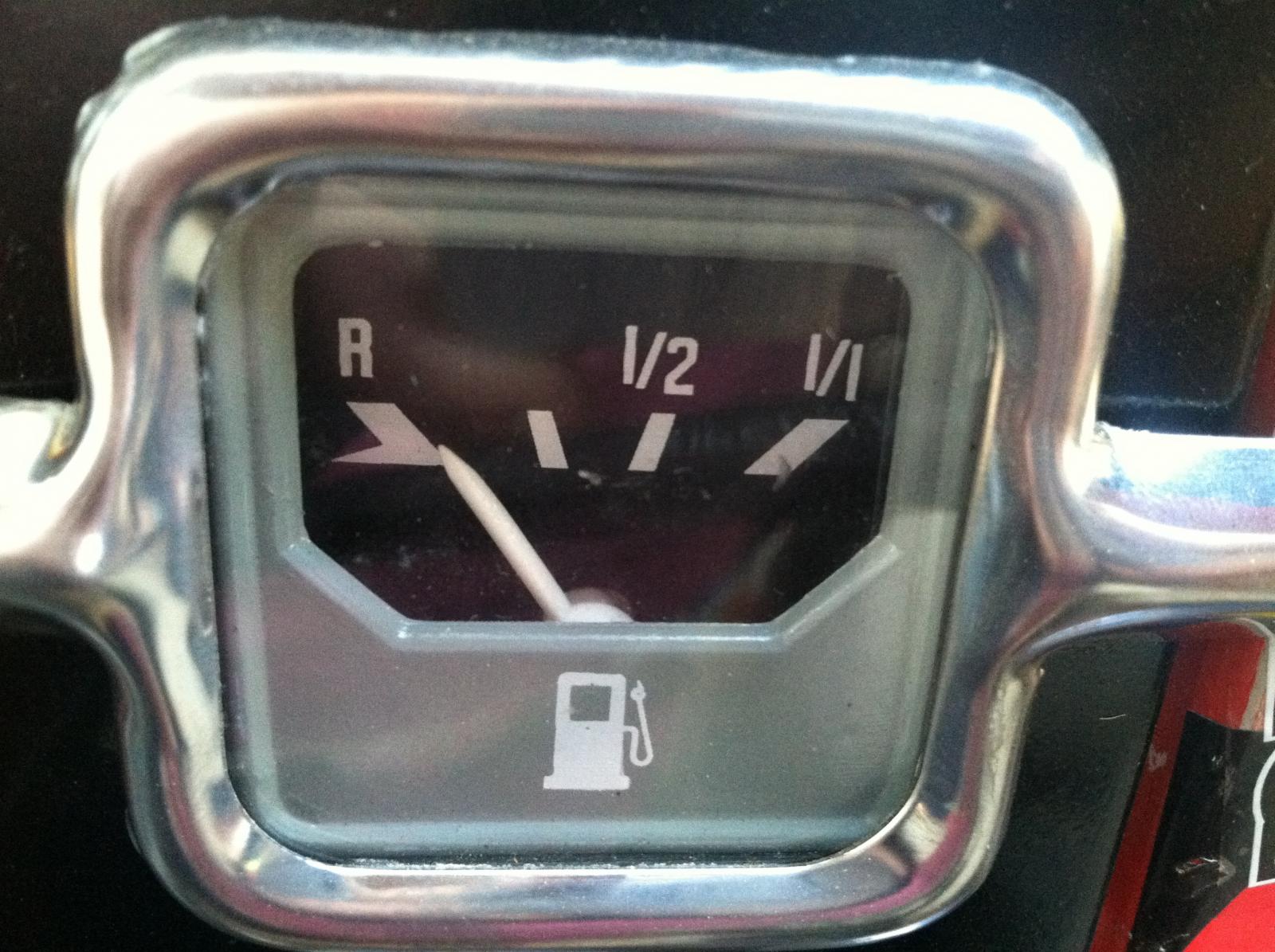

bringing back an old thread so i dont make a new one for a simple question. I have a 72 bug with older parts. i have a early tank in it with mechanical fuel gauge. i bought a brand new sending unit, and a brand new fuel gauge. i put gas in the tank and i the fuel gauge is still on reserve. i dont think it moved much. my question is how much gas does it need for it to go up? maybe i should completely fill the tank, adjust the fuel gauge so its on full. and go from there.

No, don't adjust it to be accurate when full. Accuracy there does you no real good-- you have plenty of gas so you don't really care if you have 9 or 10 gallons.
Adjust it so it is accurate when nearly empty-- a fracoitn of a gallon can mean the difference between making it or getting stuck by the side of the road. Zero or one gallon makes a lot of difference!
Adjust as in the manual page above.

where at on this gauge is completely empty?
on my sending unit if i push it all the way to the "full" position, it hits the inside of the tank before it gets all the way there. i also compared my new sending unit and my old VDO one that the cable holder broke. and they are at different angles at all positions.

Empty is when the needle does not move when you go over big bumps or curves! THis is actually how I really knew I was very low!
But seriously, the left most part of the wedge-shape to the left of R is empty. R should mean you have about 1.2 gallons left. The adjustment above will ensure this.
Search around for "sending unit" or "gas gauge" and you will find a thread on the various manufacturers and type of gauges and senders. Not all are interchangeable.
Also, the float can hit something inside the tank and give erroneous readings.

ill fill it up to full and see what my gauge says.
then ill let it get pretty low and drain the rest so i can see if i am accurate.
