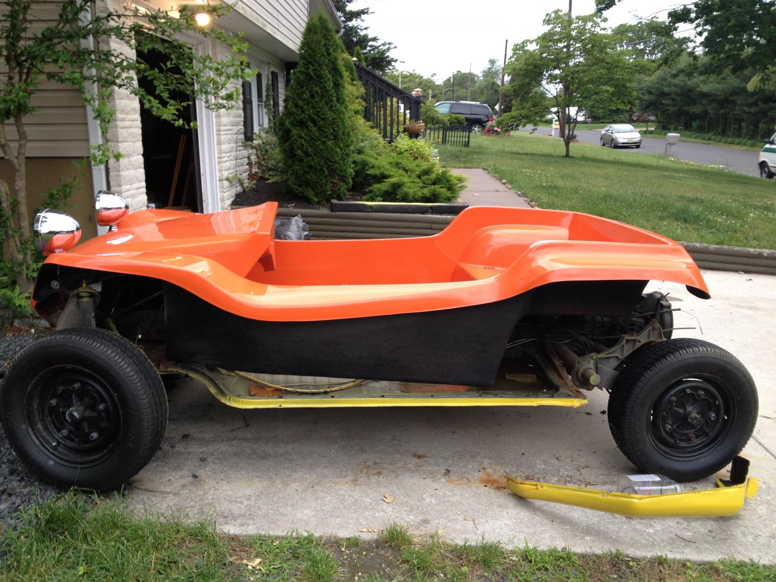

[img]thesamba.com/vw/gallery/pix/1164015.jpg[/img][/img]

I cut it all down already. Got rid of the floor pans and made aluminum. Pans with my own out side chassis that I have seen a few of you guys do. Got the body from berrian acme in Pa. I have lots of pics I have in my profile.

https://www.thesamba.com/vw/gallery/pix/1164629.jpg

Joescoolcustums, I can assure you I really tried. I did sell a lot of thing parts for really cheap to people that needed them. I guess I did not say my past. So a lot of you don't know me. This is my second buggy. I have been building cars for the past 15 years. I did a real nice 32 ford a while back I was trying to trade for a thing. This build is going for street and off road. I'm using a 1915cc from mofoco with a 73 bus trans on a 76 thing chassis. When I cut it in half Passos fell out. I was hopeing for pirate treasure, but Mexican money was funnier.

For the rear I went with 3x3 with atomerks 2 inch lift spring plates. I just ordered them so I will let you all know how it turns out. I can't seem to get the old spring plates off the torsion bars. I also added even more braces through out the car. My motto builed it at least 5x stronger then you will need. Over kill yes. Never worry again yes.

https://www.thesamba.com/vw/gallery/pix/1164625.jpg
Well on my way. I hade appendicitis. Now my guts hurt and this is how it sits.

Sweet build!
I like you design of the chassis and cage.
