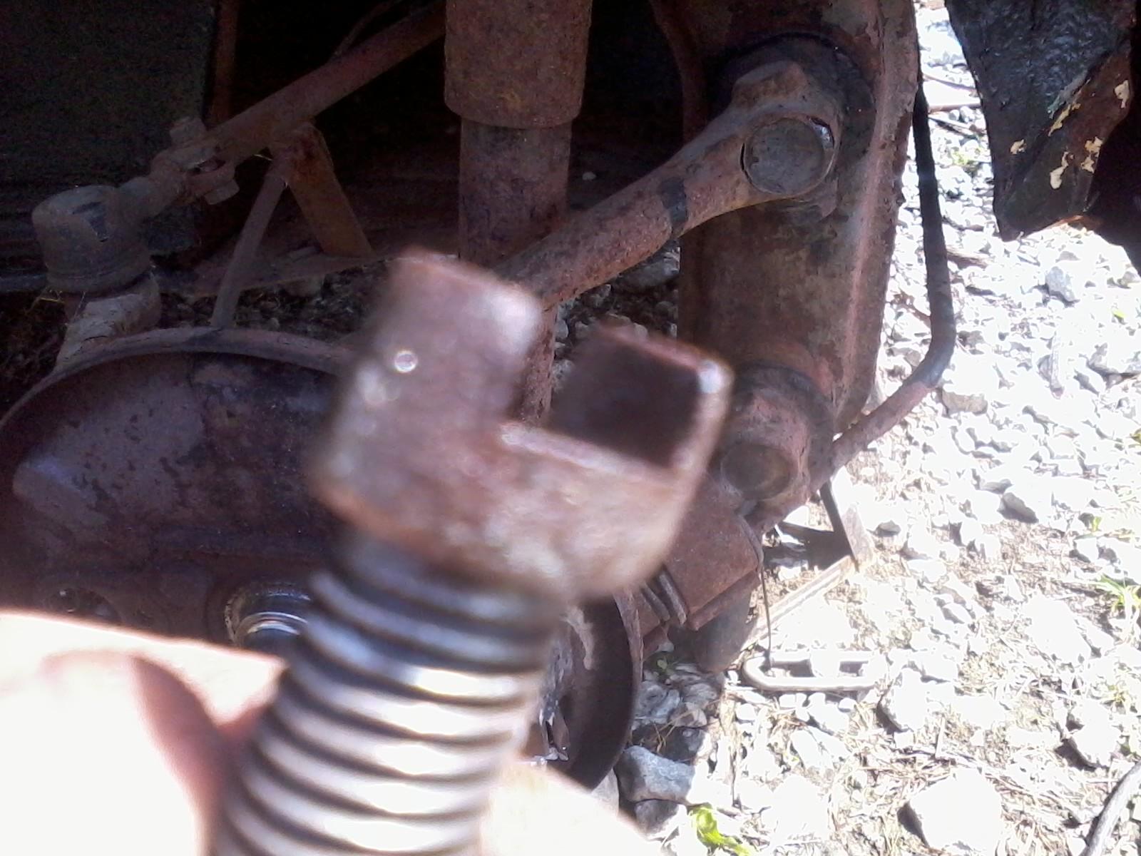

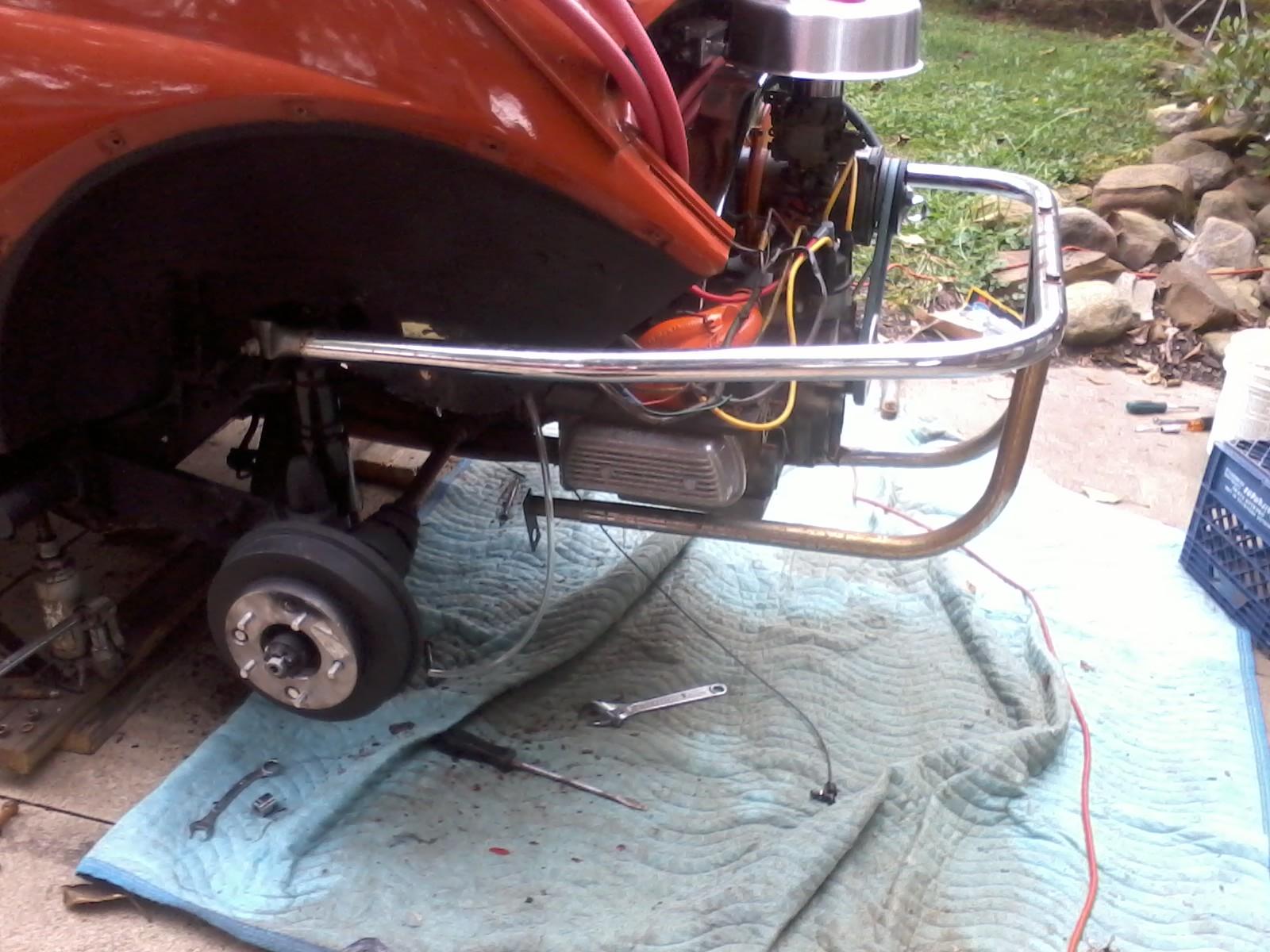

Well, I picked up 2 beetles over the past 2 weeks, and time to start my project thread, I picked up a 69 and a 70 base beetle, both have been previously started as baja projects. The one in this thread will be the 70. I plan on keeping this one and making it a street toy that looks like it could meander off road slightly. As seen in a couple of other help topics, the rear brakes were the first to be tackled, frozen and haven't been serviced in eons, it boiled down to a set of torches to loosen the rear nuts, as I don't yet have a torqe tool...( hey Santa....) After finnaly getting the drums off, I ordered all new shoes, hardware, wheel cylinders and seals. Plan on saving the adjusters Pray
pretty straight forward, like any other brake drum job, needed a little heat from a hand held torch to release the adjusters, everything got copius amounts of anti seize and new grease.
one thing to note if you haven't done these before, the adjuster is tapered and the narrow end goes towards the center, this allows the shoes position properly
rinse and repeat
drums were in exceptional condition, just needing a light sanding, bearings repacked and new seals, after final adjustment of shoes to drums, finished off with my 5 lug Chevy adapters.
Dinner time, rears tomorrow.

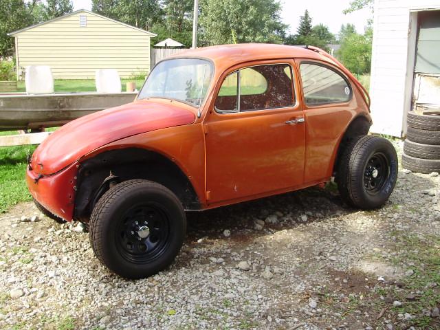

Replaced the rear brakes today, finally will have a working e-brake Dancing
All adapters and wheels on, will probbaly have to remove the wheels in the future for other work that needs to be done, but I couldn't resist, 215/65/15 fronts, 275/60/15 on the rear, has a nice stance now.

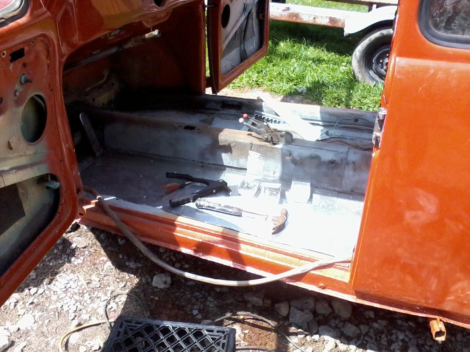

Started my hillbilly floor repair, I call it hillbilly because I'm not replacing the pans, not in the budget for this buggy, but I happen to have a lot of heavy gauge stainless steel laying around, so, the floor will be rust proof and strong. I have about 3/4 of the driver side repaired, should have most of the sheet metal work done tomorrow, see if I can get some pics. More tomorrow.

PostPosted: Sat Aug 17, 2013 1:57 pm    Post subject: Reply with quote
Finished the floors today, so now they have all stainless shetmetal, caulked/sealed everything , added a foam underlayment for cushion and a water barrier should any find its way in. Gotta figre how I'm mounting the seats yet.

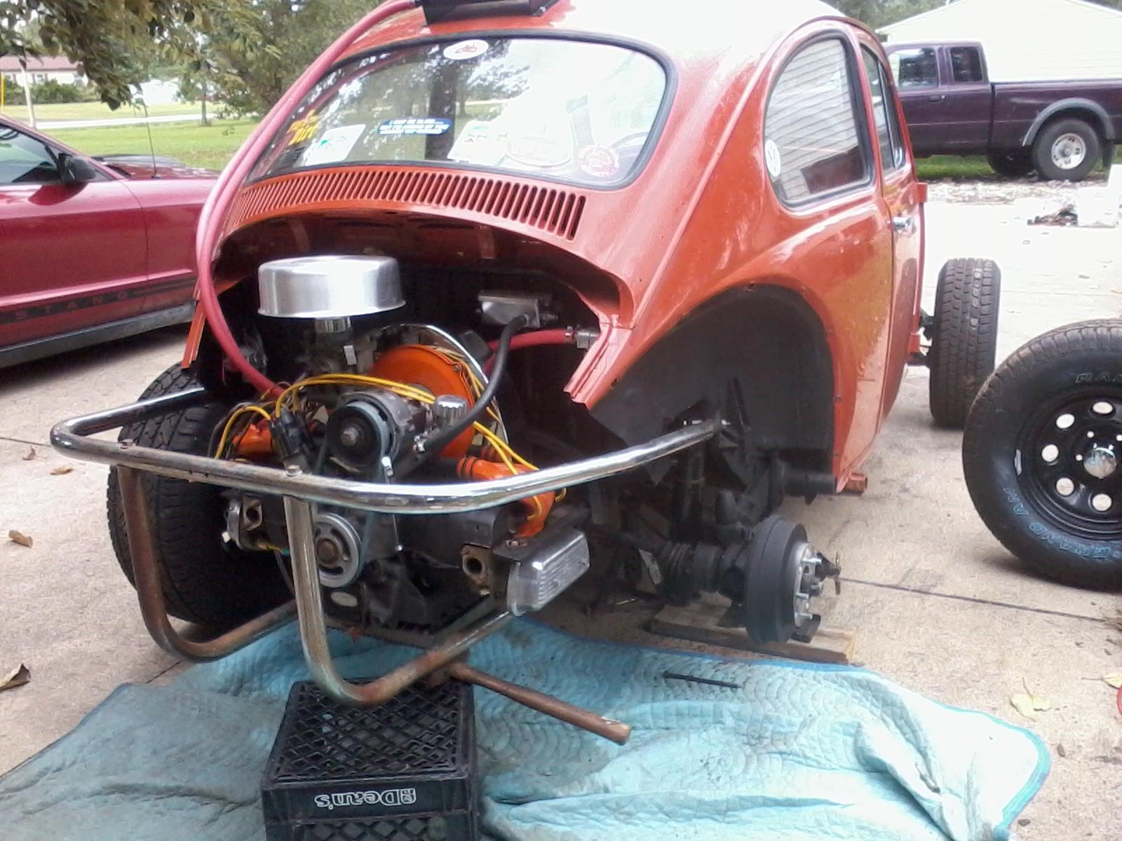

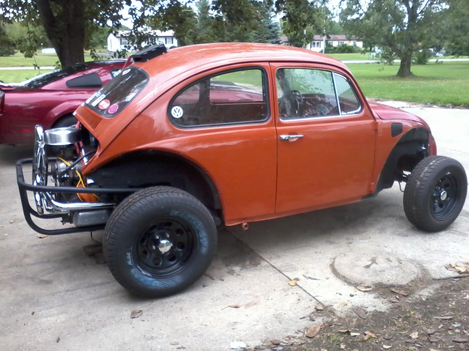

PostPosted: Sat Aug 31, 2013 4:29 pm    Post subject: Reply with quote
Got some more work done, installed new rear shocks, mocked up my cage, tack welded the mounting kit, removed it again, finished up the weld, cleaned and painted with the truck bed liner, the chrome was too far gone, and I don't mind a little chrome, but not a big fan of a lot of it, needs too much care in cleaning for my taste.

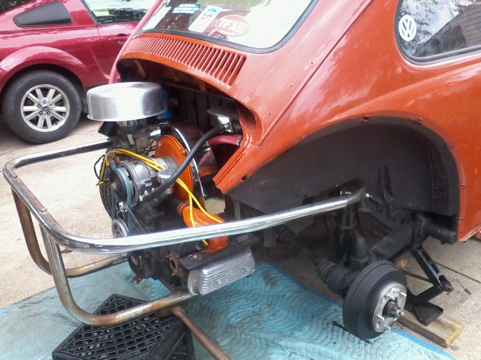

PostPosted: Sat Aug 31, 2013 4:33 pm    Post subject: Reply with quote
A couple questions for anyone watching this thread, there was a smaller aluminum pulley on the crank when I got it, what is the advantage of this if any, I thought it would take more revolutions to do the same job for the alternator and fan, wrong thinking??
Also, this empi breather thingie ma bob was also mounted, but only hooked up the the oil filler tube, where do the other two ports go?

My opinion on the pulley is that it doesnt generate enough rpm to run the gen and fan at a sufficient rate. I have that same exact pulleyon my 2180 but it has no gen or fan.

The underdrive pulley is a race thing, not good for a daily driver, and really not good for an off road car, insufficient fan speed/cooling. the other two
ports on the breather are for the valve covers, you can drill the valve
covers and buy aftermarket bungs for them. I run a set on my sandrail,
they can and do reduce crankcase pressure. My Baja I just run a breather
at the oil fill neck.

Soo much rain the past 2 days, all I got done was change the crank pulley back to the original. Funny thing about that, don't know why I thought I'd just pull the pulley off after taking off the bolt.. Rolling Eyes Anyhow, I managed to use a steering wheel puller, by running 2 bolts from the backside of the pulley up through the puller, and the puller center bolt fit nicely inside the center bolt hole, a little turn of the nut and pop, easy out.
