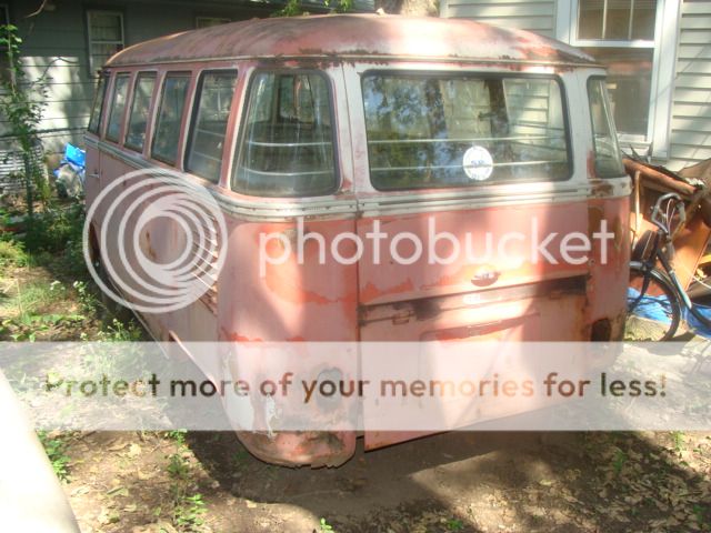

as posted here on TheSamba
what no floors? Laughing

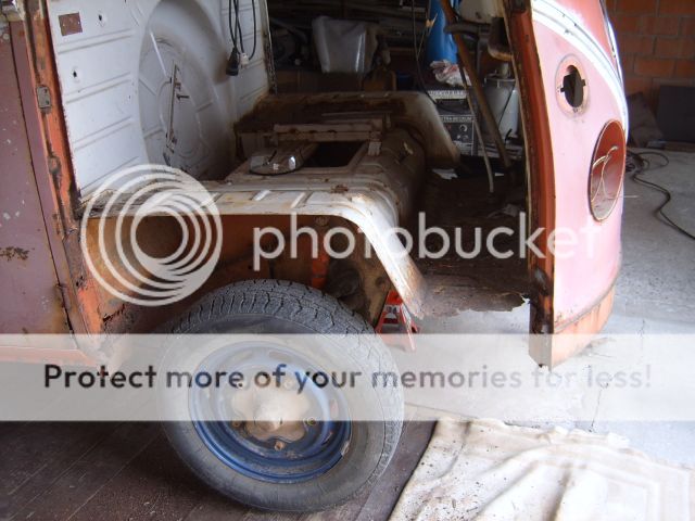

as arrived in Belgium. "damn a lot of work" Laughing not to worry... Wink
The intention is to build this bus keeping it's current look, but having a solid rust free bottom.
Yes there will have to be some serious paint blending, but I don't care, I'd rather have blend paint then get killed in traffic due to the poor condition of the bus

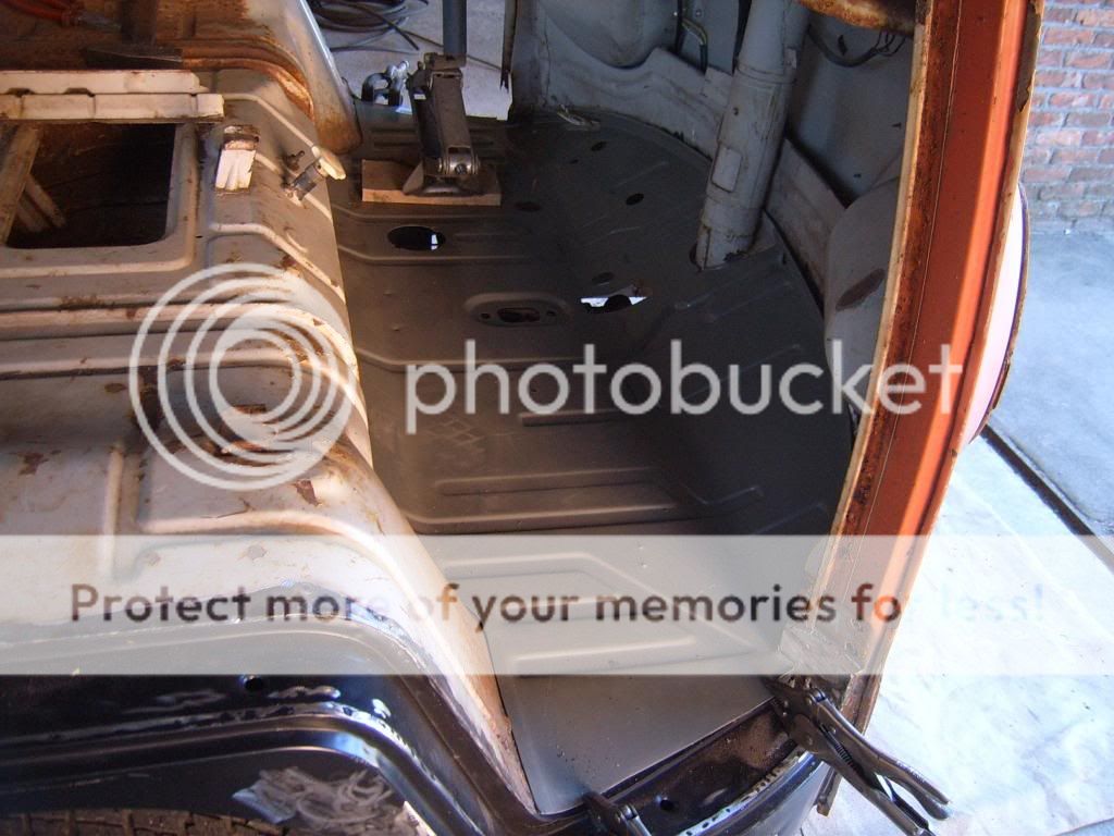

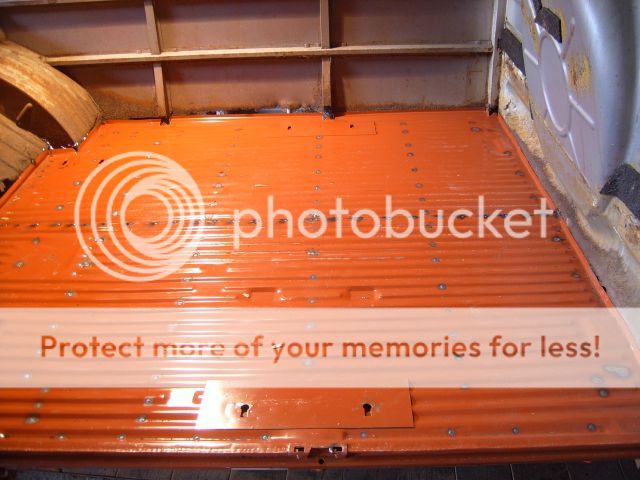

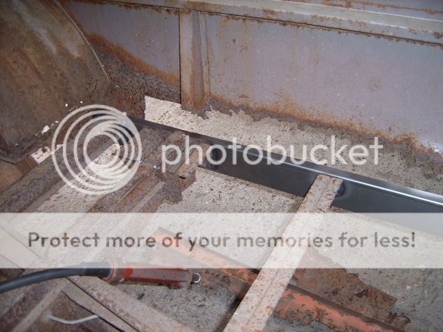

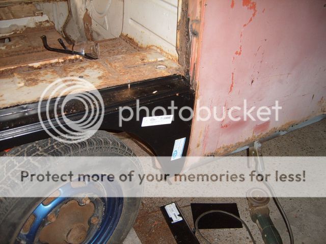

fitting rocker under cargo doors...
blasting/prepping the frame underneath and finally fitting a floor Very Happy

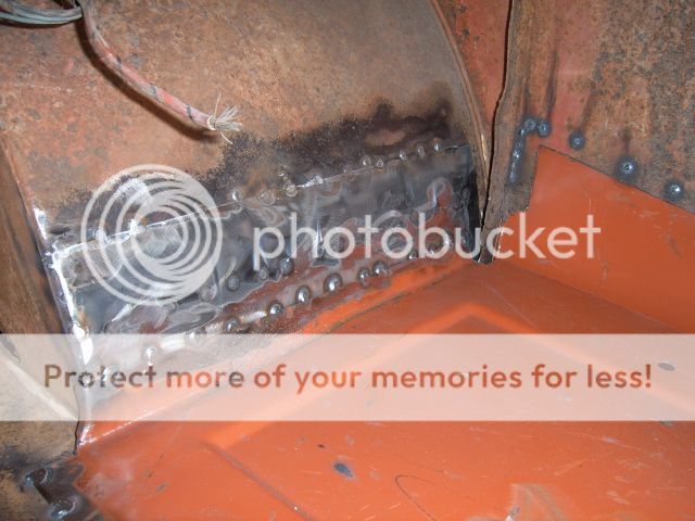

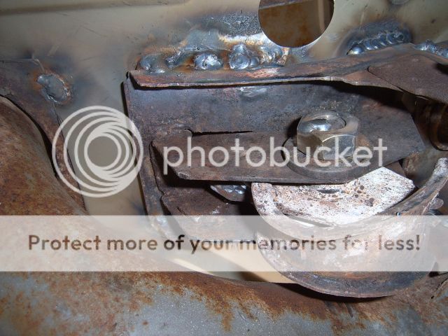

started making some small patches where needed, leaving as much og material intact as possible..
a lot more to come in the next days Wink a difficult challenge was to see how far we could go without messing up the original looks of this bus. I DON'T want it to be a restored bus, there has to be lots of surface rust, paint chips, dents and scratches that 50 years on the road created...

Vintagespeed wrote:
If you feel like changing it, this Bus should have middle seat mounting plates that look the same as the rear seat mounts. Lose the huge plates.

hey Everett, thanks for the tip, how should that floor look? Can it be adjusted?
When ordering online the floor plates always say 55-67 Laughing

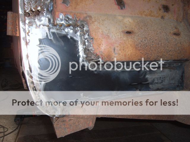

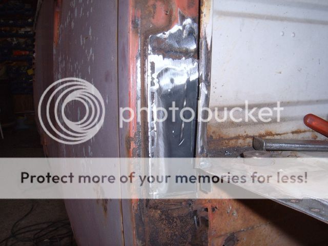

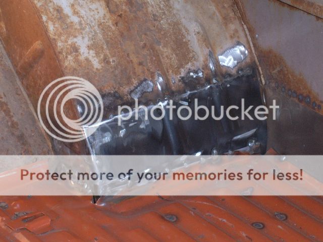

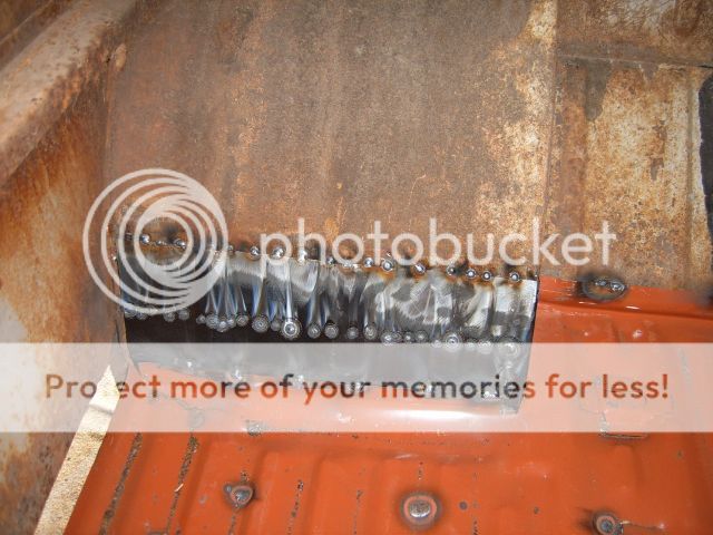

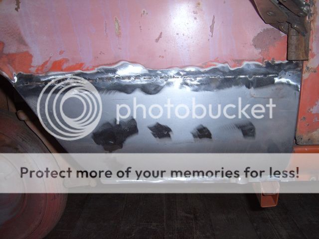

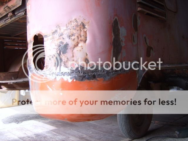

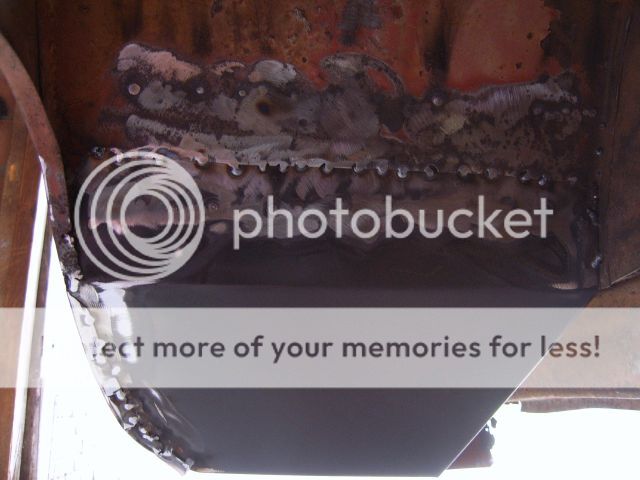

as for the current welding progress :

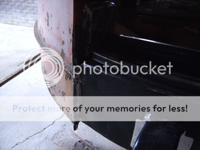

out with the old doglegs
little patch just in front of the cargo door rockers
inner wheel area
front floor will be cut out entirely too, it will be replaced
dogleg fitting :
it's comming along great, I can hardly keep up supplying metal parts for my buddy Wink

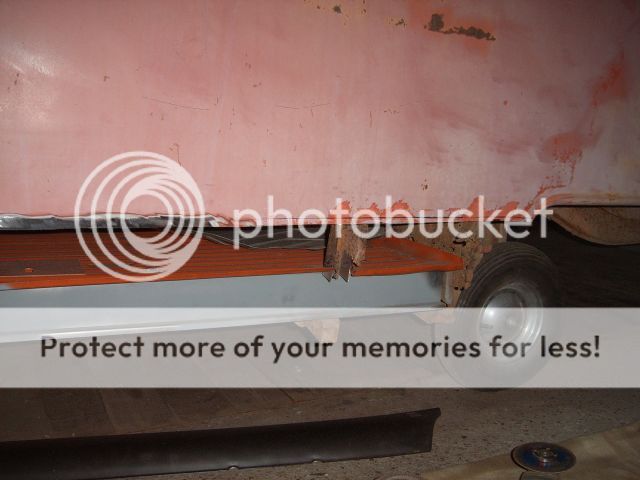

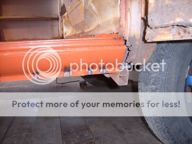

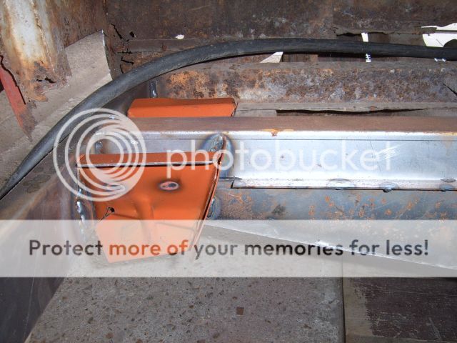

patch above cargo floor
small patch above dogleg

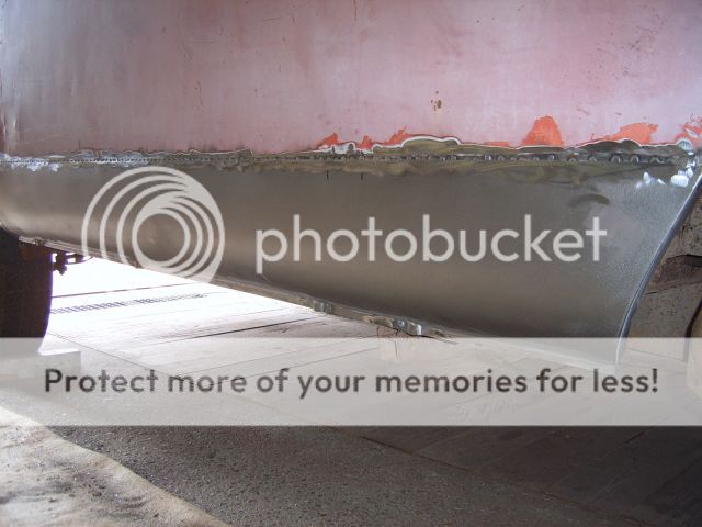

rocker out

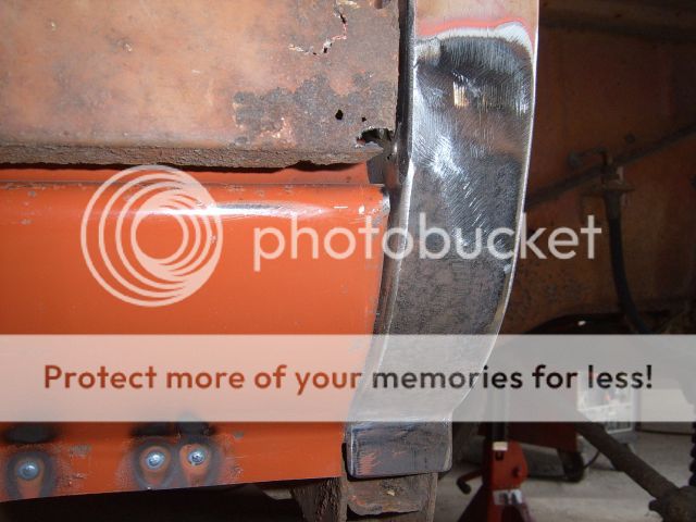

Autocraft rocker in...

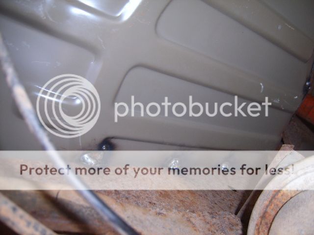

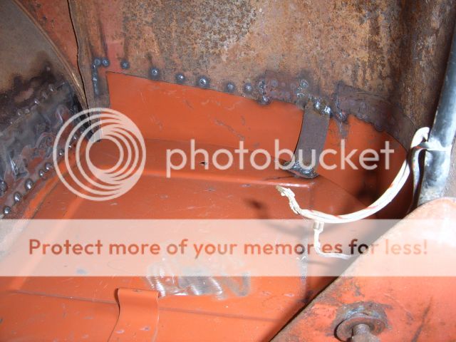

fixing the inner wheel area behind the rocker
other side needs an Autocraft rocker too
man those panels are sweet when it comes to fitting.

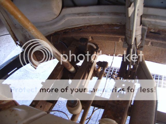

next up...front floor renewal
currently steering wheel, box, handbrake, etc are being removed. more on this shortly!

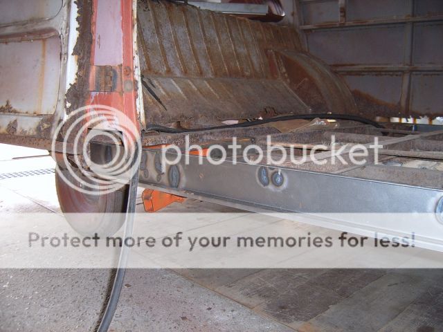

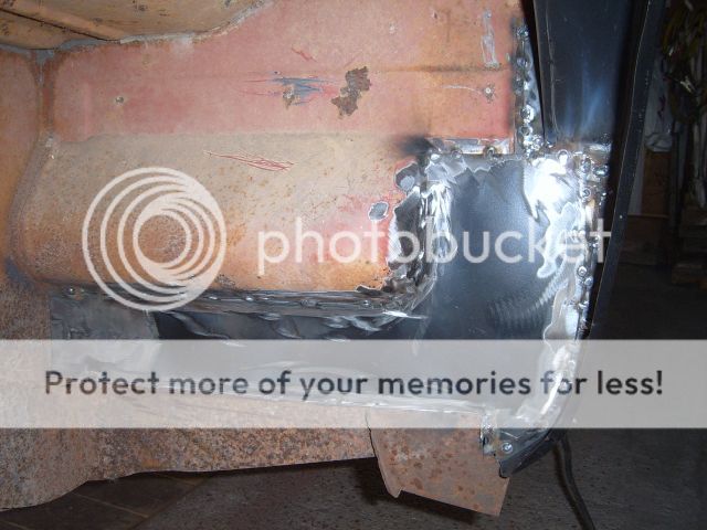

some more of Luc's work of today..
fits like a glove, let's start pinning it down from below
I like the og stuff, so let's but that back Very Happy
at this point, it's no longer a flinstone car Wink

Hmmmmmm...getting ready to finish up my floors this week. What do ya'll think about welding them from below like this as opposed to the more common way...from above?
Wexford
Joined: January 28, 2009
Posts: 376
Location: Bristol, UK
Wexford is offline
PostPosted: Sat Aug 17, 2013 2:55 am    Post subject: Reply with quote
Weld through from above (having cleaned, primed and painted the tops of the chassis rails that will no longer be accessible when the floor is in....mark and remove paint from the spots where the welds will go)
