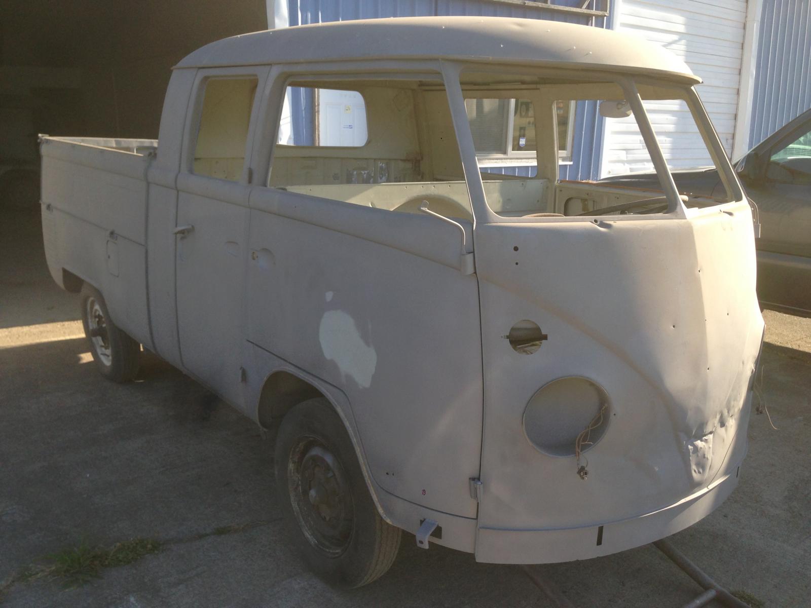

Hello Everyone,
I am new to the forum area and would like to start in. I have a few projects going and would like to start a build thread. Here is my 1965 Double Cab that I got a few months back and we started working on it about three weeks ago. It is starting to move along and wanted to share. If there is anything you see that I am doing wrong please let me know.
So this is how I bought it. Someone blasted it then let it sit for some time. I took it back to the blasters to get it cleaned up.

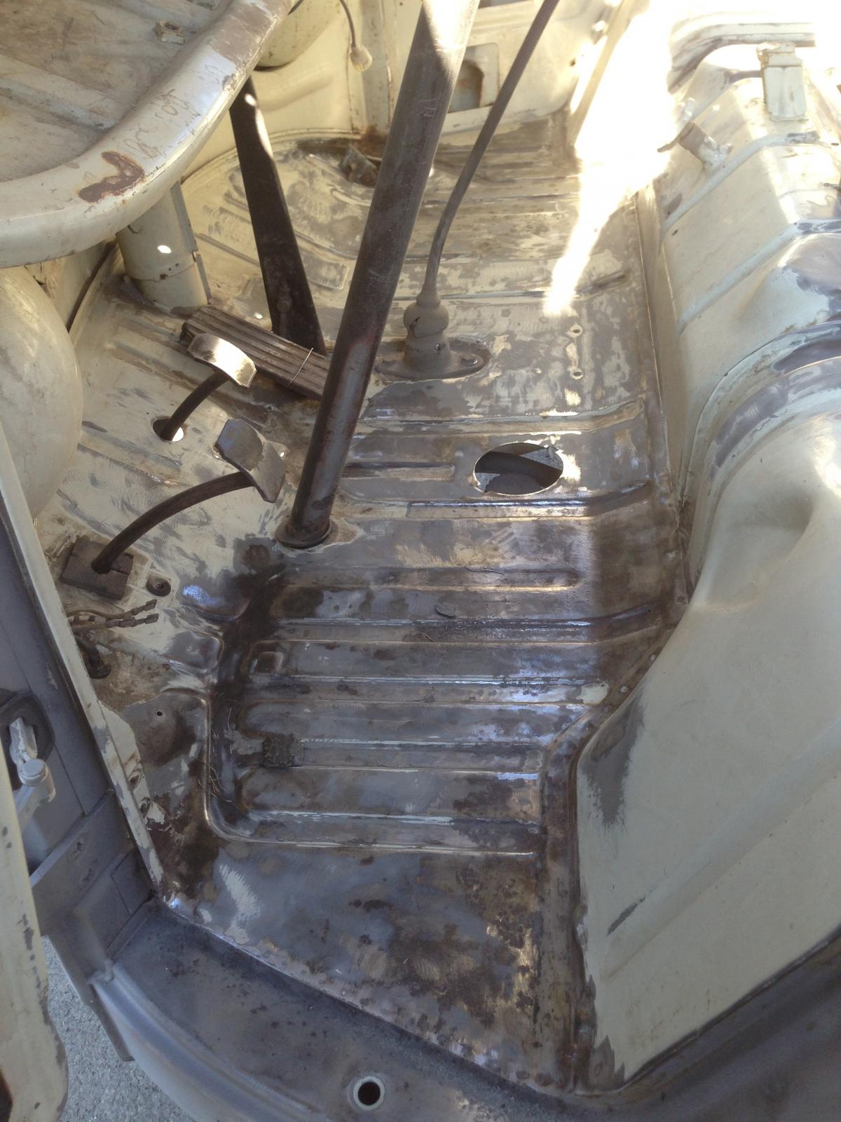

That front floor looks really solid, definitely a nice DC project to start with.

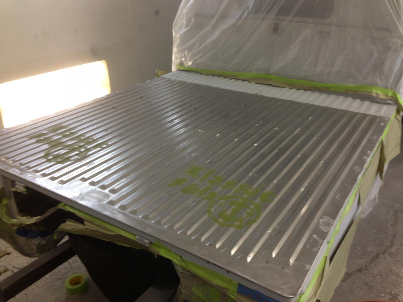

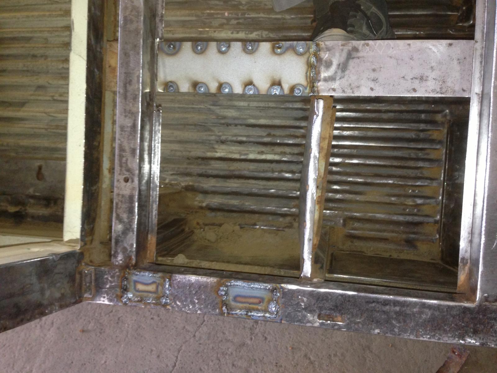

Sorry I haven't uploaded for a time but I have been working. These pics where from July 30th so almost a month old. I will try to get caught up. Here is some pics of the new metal going in.
Yes that is how much dirt came out of the rear outrigger. They didn't look bad but were questionable and man I am happy I replaced them.

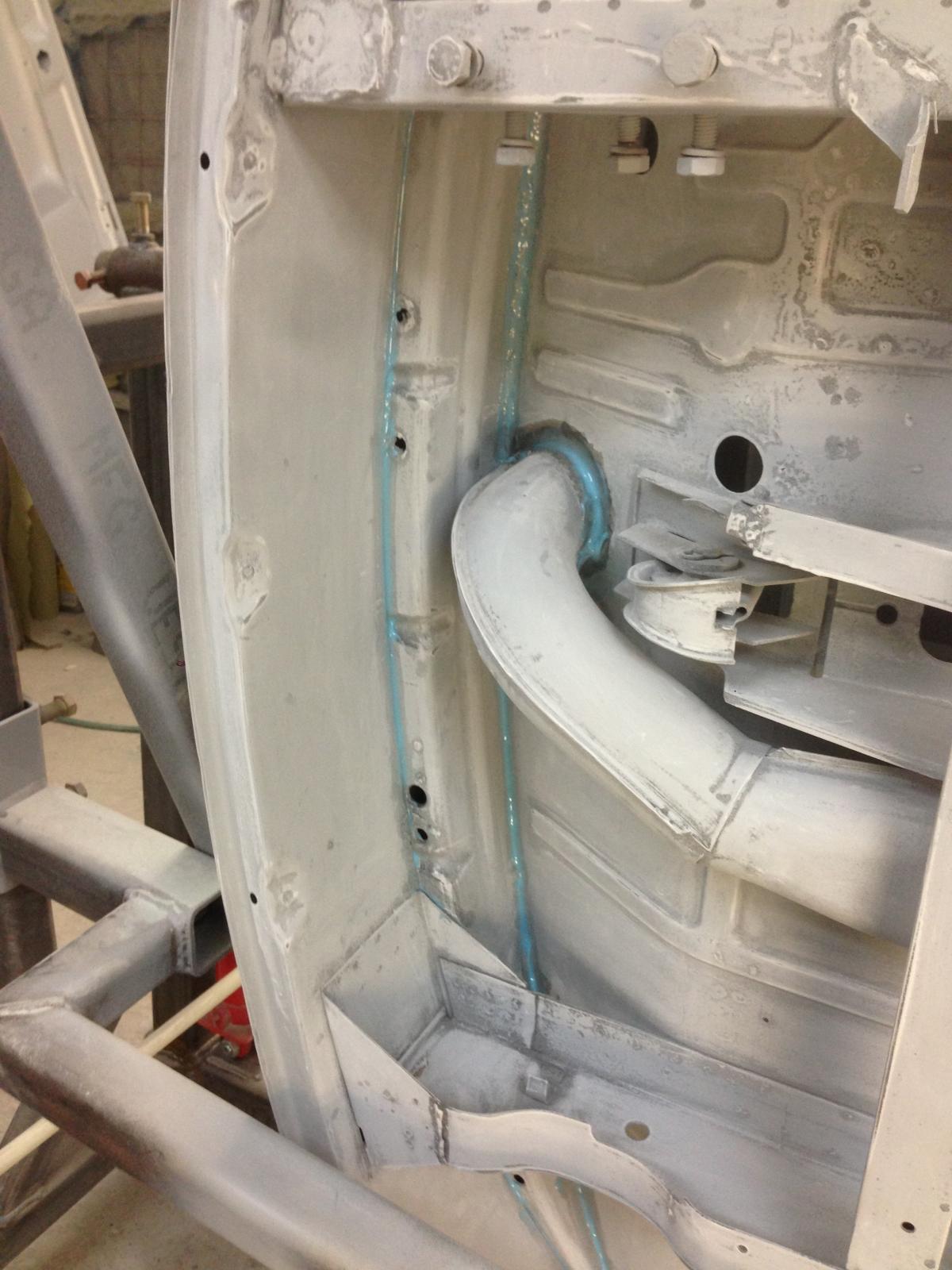

PostPosted: Tue Aug 27, 2013 12:39 am    Post subject: Reply with quote
Ok now it is painted with two coats of epoxy and two coats of primer.
This Saturday it took all day but got it seam sealed with Fusion 123EZ two part sealer.
All the seams have been primered again and now it is being sanded down for final paint.

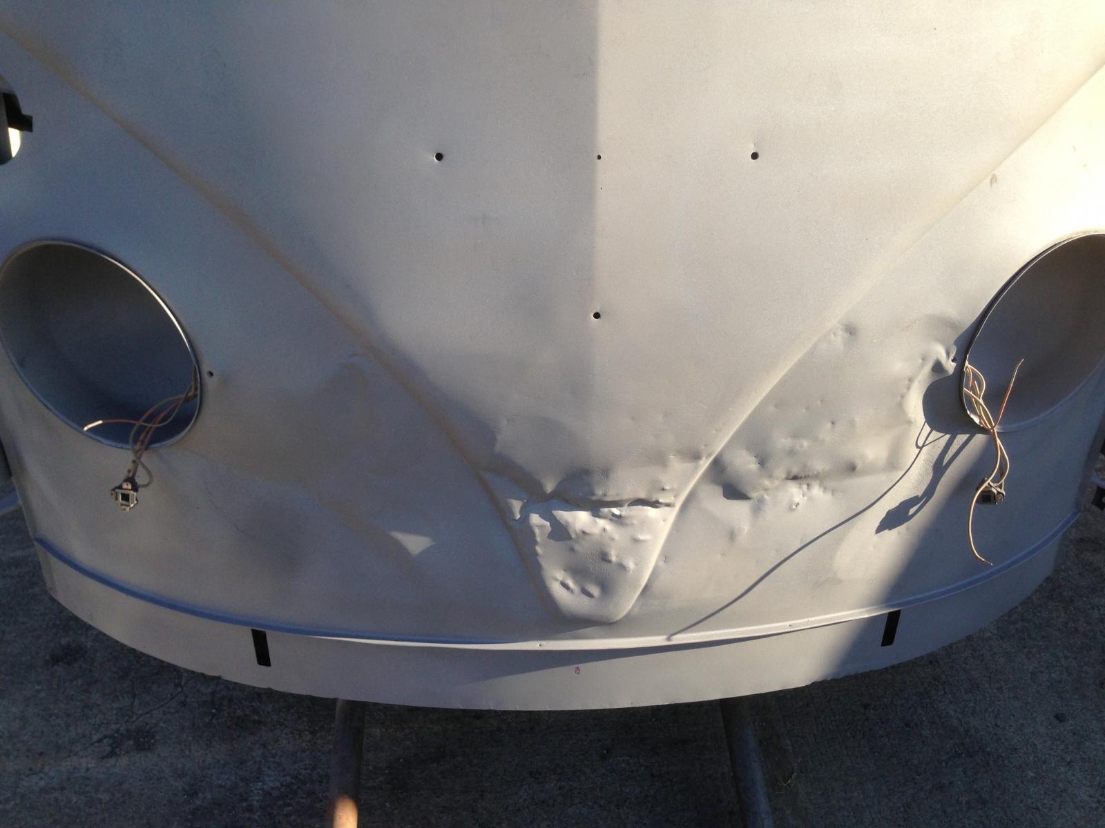

MorrieH wrote:
hope you fixed the funky dogleg..

PostPosted: Mon Oct 28, 2013 12:30 am    Post subject: 65 DC Reply with quote
Yes it was fixed.....

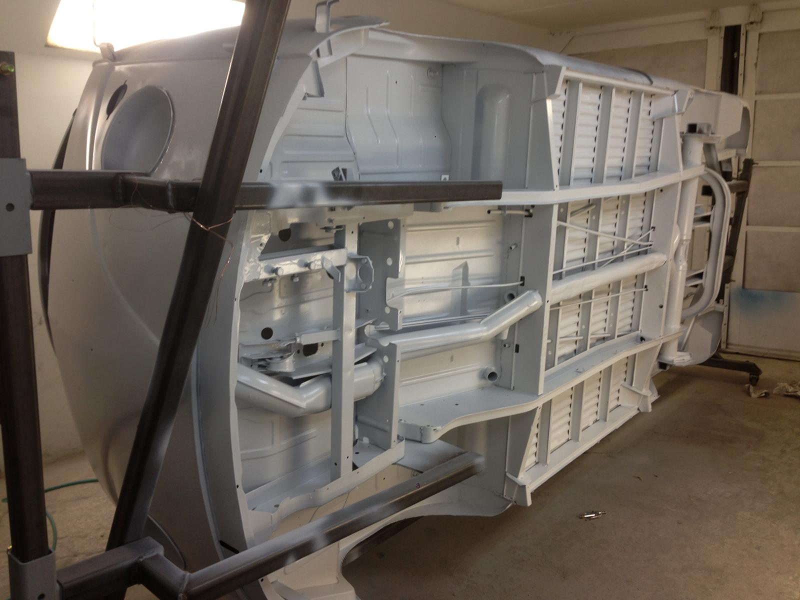

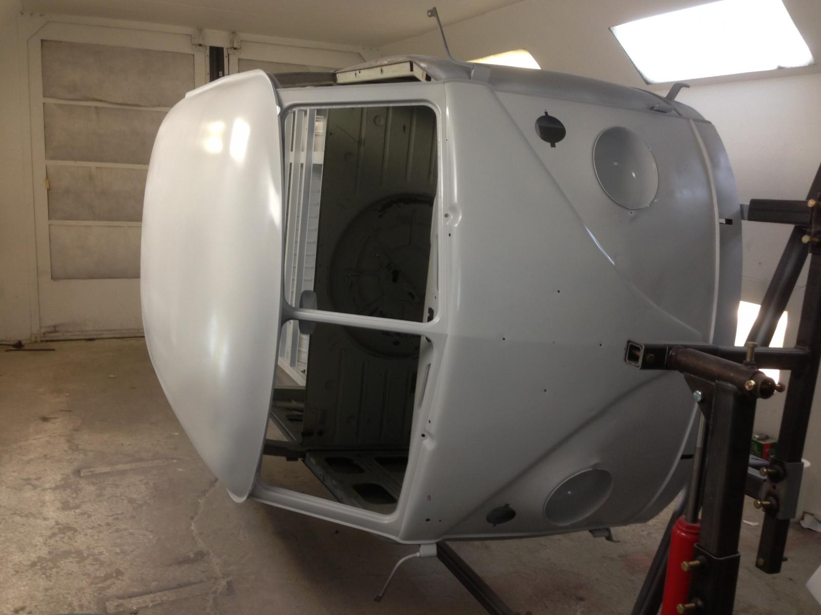

Here it i is the current stage. We are finishing up on final block sanding, interior and under bus is ready for final paint.

PostPosted: Mon Oct 28, 2013 2:40 pm    Post subject: 65 DC Reply with quote
Factory color is pearl white and I'm going with that.

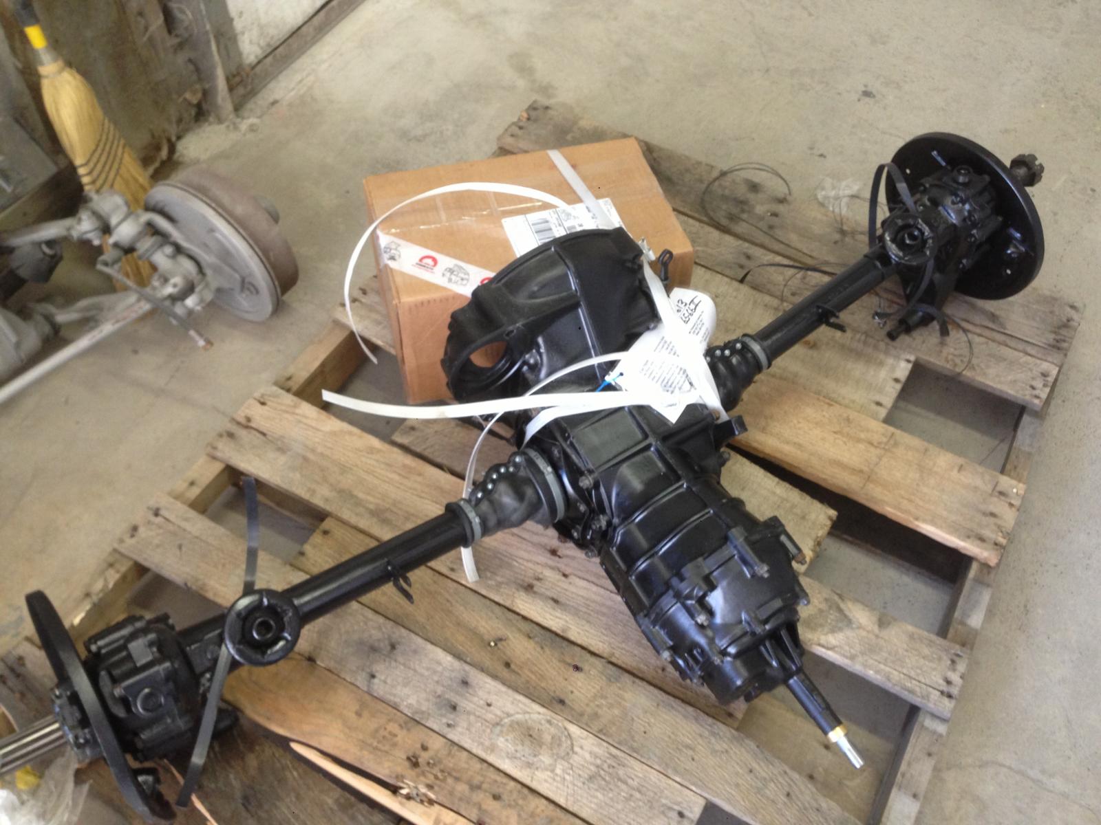

Completely rebuilt tranny just came in from German Transaxle of America
Just waiting on Nate from Wagenswest for the rebuilt stock front beam and it will be rolling again soon. Of course after we paint under the bus.

PostPosted: Mon Dec 02, 2013 1:10 am    Post subject: 65 DC Reply with quote
Well we are getting closer and closer. We have painted the engine area and where the gas tank goes. Also installed the rest of the bed of the truck. Next up is final paint under the bus and interior.
