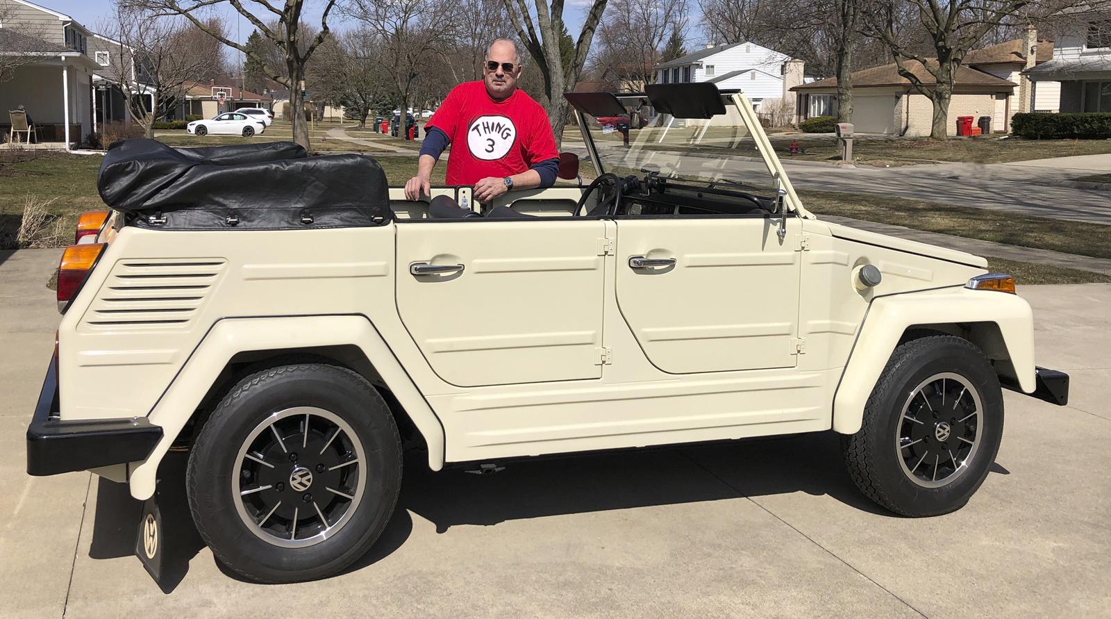

Here's a statue of my UPS man delivering the wheel balance adapter:
