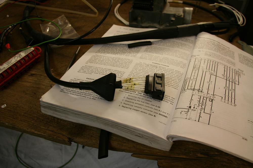

How to do it.
Prepare yourself a large area. I used a table and covered it in white paper. The way you should do it is get a piece of plywood and put nails in it to hold your harness in place as you go.
Begin by laying out the harness and making a diagram of where everything goes. This will help you keep things organized. I just drew on the paper. A half sheet of 1/2 inch plywood with the nails would be ideal as you can draw on it too. You will notice on the first photo that I use a label maker to label all connections when I take a harness out. This makes it much easier to figure out what everything is.
Next, strip off all of the old covering. Use a razor blade to slit it and peel it off. Leave all rubber boots intact.
Take the hood off of the ECU connector.
At this point, if you were anal, you could check every wire to see where it goes before you start to take it apart. The OG harness has markings on all of the wires at each end that tell you where they go.
This is the scary part. Pick a wire and pop it out of the connection in the harness. It doesn't really matter which one. I started with the shortest and worked my way to the double relay connectors. This is so I could wrap the wires as each section was finished to keep things tidy.
To pop out the connector, you need to use a very thin tool to slide into the connector housing. The female contact opening looks like a square with a notch on one side. You need to slide a tool into the both and press down the retaining clip.
This is what the openings look like
It really sucks until you get the hang of it. I use a small precision screwdriver that fits in well. I have also used small tweezers that I ground down.
Trace your newly extracted wire to the ECU and write down which pin it is in, before popping it out of the ECU. If you are color coding your work, look in the bentley to see what it does.
Measure the wire and cut a new one to the exact same length. Copy the contacts on each end and use the wire markers to mark the end of the wire at the harness side. This will allow you to trace it much easier later.
Slide it back through any rubber boots or grommets that you have and connect each end.
Move to the next wire.
Now, there are many wires that either connect to the double relay or to another connector. Just deal with these the same way. You can label them however you like, but I honestly just went wire by wire so that I could not make any huge mistakes.
At the end, you will have something that looks like this
Once you are here, you will have the "oh crap" moment as you realize that you cannot get the shrink wrap over the whole concoction again. I built mine with full intention of putting split loom over it. With the split loom, I used 3/4 inch, half inch and 1/4 inch to get the whole harness covered. For the joints, you can purchase "loom tees" from waytek wire in pretty much any configuration you like.
Now, after all this long story, I forgot to take a photo of my covered harness out of the vehicle. I just got the bus running again today and the harness worked out of the chute. I had some other interesting wiring gremlins to sort out, but none were harness related.

Great stuff, looks good. I'd like to add my own experience with this job, so other people may be encouraged to do this.
I used the method 77Campmobile already mentioned; the nailboard. Although I used a very crude nailboard, it's a great method. You just pin down your old wiring harness and start running wires starting at the ECU connector.
All wires replaced
When you use the wire labels, it's a good idea to use transparent shrink wrap over them, or they will come of.
Almost done! When you take your old harness apart, take a good look at how some wires are routed. Some wires make U turns in the harness.
I finished the rest of the wiring on the engine, to make sure everything is trimmed to length. As you can see in this picture, I also incorporated the wiring for the dipstick temperature sensor, the oil pressure sensor and tachometer in the wiring harness.
Happy wiring!
