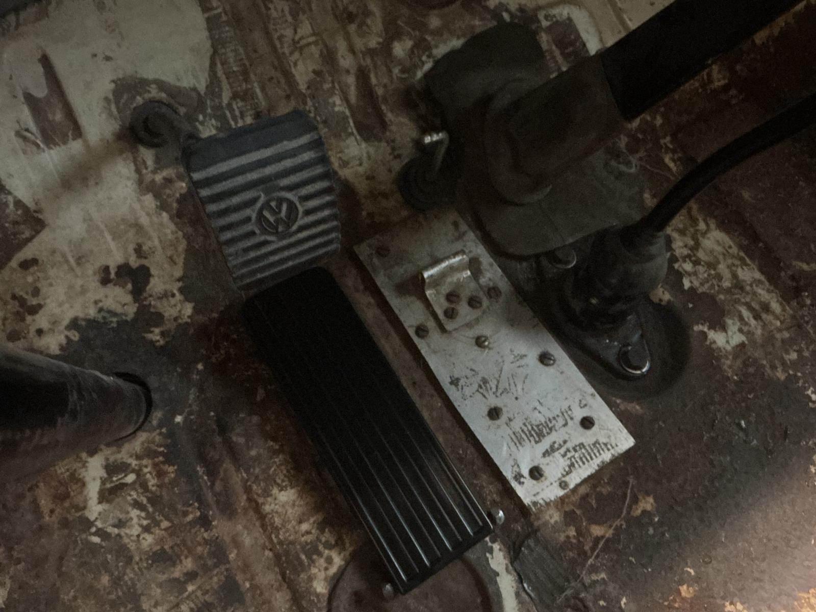

Found this gem tonight. Was hoping to just replace old hinge, and bring in new pedal. But SC PO had other ideas years ago.
What I need…what is location and orientation for resetting hinge? 65 Single Cab…
Thanks everyone.

First thing would be to remove the aluminum scab off the floor and see what you have under that.
