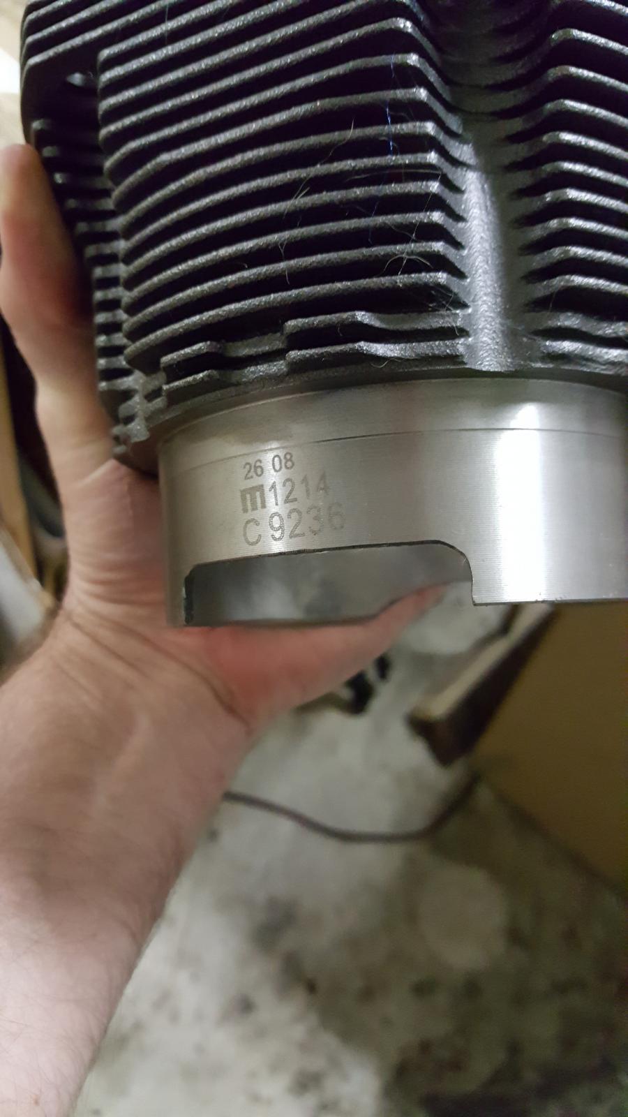

I'm rebuilding a 1978 bus motor that had been sitting in storage for many years, and condensation got into 1 cylinder and pitted it. The other 3 cylinders and all 4 of the pistons are in great shape, with very low miles on them (like maybe 5,000 miles), since the pistons/cylinders had been replaced shortly before it went into storage, so I'd rather just replace the 1 bad cylinder than buy another whole set.

I'm pretty sure I do (actually I think I have 3 of them, Mahle specifically, never used). Let me just confirm that first, and I'll get back with you...

And keep in mind that a 94mm P&C for a Type 4 engine is different that a 94mm for a Type 1 engine.

also please don't just stick a piston into a cylinder without having it properly measured first. If it is loose it may rattle like hell, and if tight seize when it gets hot.

Awesome! PM me if you do. Also Randy in Maine made a good point that I need a 94mm cylinder for a type 4 motor.
Seems like the top of the cylinder protrudes about 1/4" from the fins on a type 4 cylinder and about 3/4" on a type 1, but for sure they are not interchangeable, even though the bore is the same.
On a new or fairly low mileage used Mahle cylinder, I think I'm pretty good on making my current piston fit. I've alway's had good luck with the machining tolerances on Mahle P&C's, but SGKent makes a good point about sizing them correctly, since I know Mahle grades both the pistons and cylinders to fit together with optimum clearance.

Yup, type 4. I'll PM ya.
