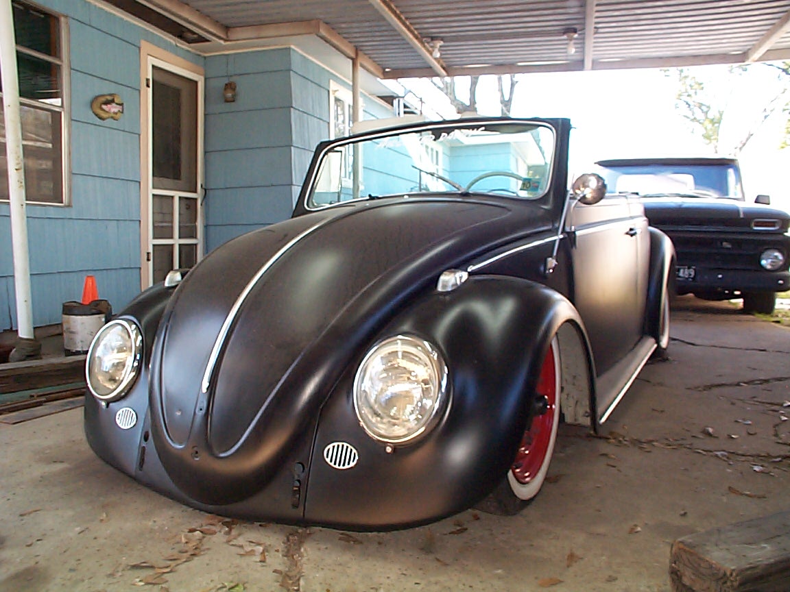

Just trying to see if I can get a pic to post in here. This is my 63 vert. I fabricated front air ride and I ordered rear from airkewld. Rear kit has not been received yet.g

Looks good. Was the bag system hard to install?

The hard part was thinking up a way that the bags would work without binding up or bending too much. As the lower trailing arm rotates down, the bag will start twisting. So I made brackets on a swivel to take care of this problem. After everything was fabricated , I could take it in and out in 10 minutes. The part that is a little hard is changing over to rack and oinion steering. Modifying the steering column to exit the fire wall in the middle instead of the left side.

here is another pic

what color is that car painted? Is that just primer black? I'm thinking about painting my car John Deere Blitz Black, which looks similar to that.

The paint on this car is Rustoleum Satin Black acrylic enamel. I bought it at home depot. It is actual paint that has a satin finish. If you use primer it will fade in the sun.
