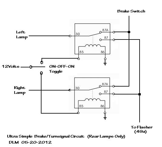

im using this setup.
i must have done something wrong. now that i think about it, the turn/stop filiment is trying to do both. i dont know why. when i step on the brakes, the tail light goes on. now while im on the brake peddle, and turn the signal on, the relay should stop sending power from the brake switch, and send it from the flasher right? so it should flash the same as if i wasnt on the brakes. i think its trying to do both. its the same for the left and right rears. im going to go play around removing bumbs and chasing wires.
Yes, when you turn on the signal, the power should be sent to the relay and and switch the power to the other circuit. If its doing both, then then you have something wrong with your wiring. Check your circuits and youll probably find it. I find that labeling the wires helps too.
Have fun chasing wires!

im lost.... i ive undone every connection and just did one side of the rear circuit. i took apart the hazard lighg setup, pulled the front bulbs. simplified everything. its still doing the same thing. i have noticed though, is that the relay is clicking at the pace as the flasher. why is that? it shouldnt click at all unless im using the brake then apply the turn signal.

im pretty sure i have my hazards wired in a way in which frys relays...lol. ive got my kids and no car seats at the moment, so ill have to pick up a couple of new relays and maybe a new flasher while im at it tomorrow. the ill hook them up as per dales drawing and nothing more. then, if successful, ill need help with trying to add front turn signals, and then hazards.
Dale M.
Joined: April 12, 2006
Posts: 20829
Dale M. is offline
PostPosted: Tue Oct 08, 2013 5:29 pm    Post subject: Reply with quote
This is better system when using relays.... Integrating STOP and TURNSIGNAL on same filament of bulb can be a problem....
And in both circuits you have to understand flasher and stop light circuits work through make or break (NO/NC) contacts of relays, relays DO NOT FOLLOW flasher pulses, the relays only operate and release through control of toggle switch or turn signal switch, if relays are following flasher, something is wired wrong...
IF you have flasher wired in ahead of turnsignal switch that is part of your problem.... Relay circuits are meant to be powered by pure 12 volt signal on/off/on per switch...
IN two relay circuit ONLY ONE relay should operate at any given time when turn signal switch is operated....
Two relay circuit was never meant to operate front flashers, if you are trying to integrate front flasher with ultra simple 2 relay circuit For rear flashers you are causing your self a nightmare...
IN 4 relay circuit only 2 associated relays (L1 & L2 or R1 & R2) should operate when turn signal switch is operated...
Dale

so its probably the fact that i tried wiring up the front signals and the hazards into dales setup that caused all my problems.
so before i go and buy some more relays and wire it up as per dales 4 relay setup, will i be able to add the hazard switch into this somehow? or is that going to be a totally seperate setup? i need them to function for it to be road legal.
and in the 4 relay setup, the flasher terminals are labled x l p. do i need a different flasher, or will any 3 prong flasher work. the one i have has i belive a 30, 49, and a ground. the 30 is power, 49 is to relays, but dales picture says to hook up "p" to an indicator bulb. would that be like the one in my speedometer?
