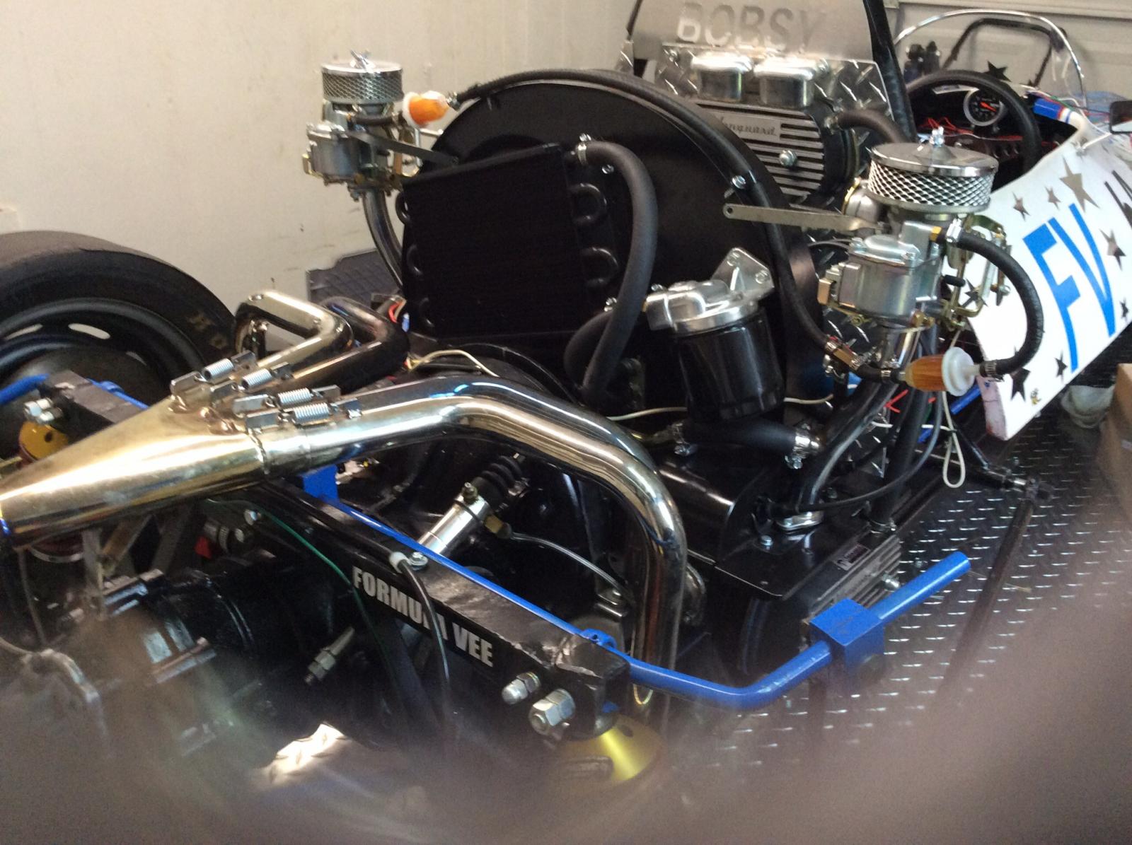

PostPosted: Fri Dec 19, 2014 3:10 pm    Post subject: Re: Hot Rod 40hp Stroker with 1300 heads build Reply with quote
Hi lug bolt I just got down building my hot rod 40 hp motor .i just got it running today .it sounds bad ass lol I looked at the 1300 heads. And a set of1965 40 hp heads . The intake side of the head on the 1300 heads is not that much bigger than the intake side of the 40 hp heads .after seeing that I went with the 40 hp heads I ported them and cut the seats for bigger valves I cut a set of SS valves .down to the size I needed. And ended up with a set of 34 mm intakes and a set of 31 mm ex. Valves I cut the heads for dual springs I then cut the heads for almost 9.1 cr I used 83 cyls and a 40 hp crank deep sump straight cut gears scat C 25 cam 30 mm oil pump nos 40 hp rods vanguard dual carb set up with two pic30 carbs a 009 dizy I like the way a 40 hp crank revs up super fast .its got I am a bad ass motor sound to it lol lol it's going into my vintage formula vee vanguard bobsy .imust say it's been a hard to build motor just finding the right parts is a lot of work . But all worth it allso I wanted the stock 40 hp look good luck on your build your going to like your motor two .
