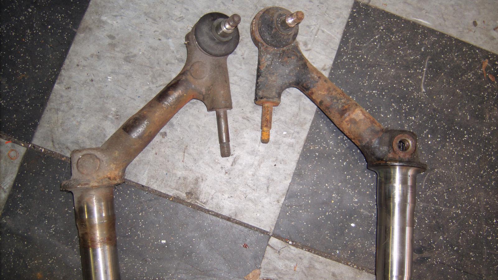

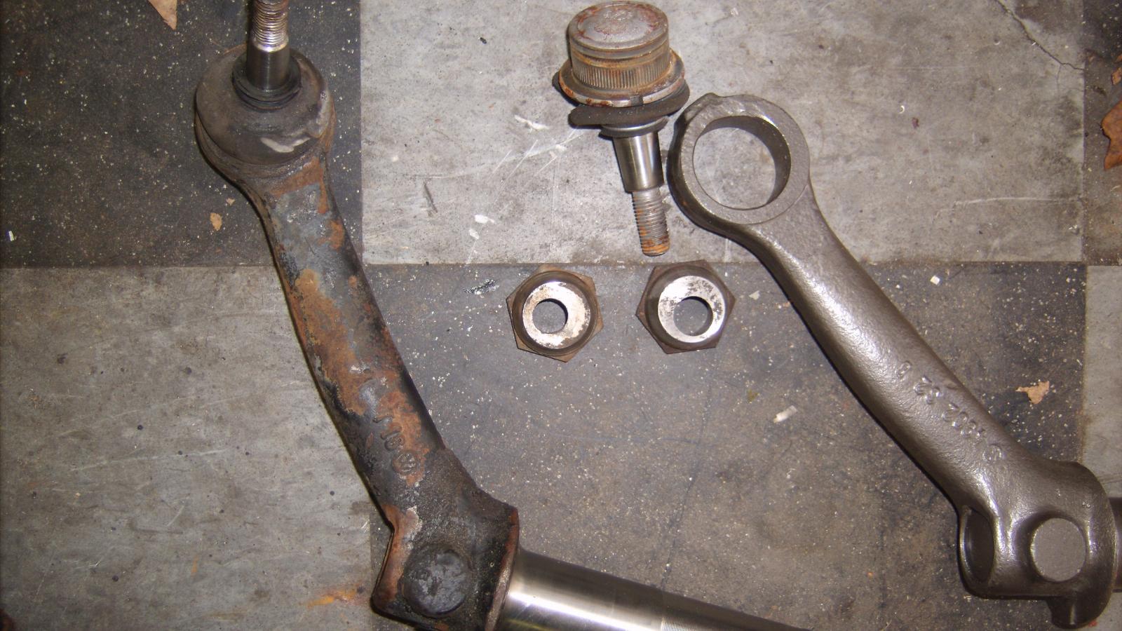

PostPosted: Thu Oct 10, 2013 3:59 pm    Post subject: Reply with quote
ok here goes these are a few pictures that might help
these are the adjusters the small one are for the bugs the large one are for the thing
the one on the left is for the bug the one on the right is for the thing which has a larger shaft same size mounting
the one on the left is the bug the one on the right is for the thing same arm different joint
lower arms left is for the thing right is for the bug notice the longer stud for the shock on the thing arm and the bigger shaft on the ball joint

PostPosted: Thu Oct 10, 2013 7:40 pm    Post subject: Reply with quote
So the torsion arms are essentially the same except for the stud for the shock? The difference between the Beetle and Thing beam would mainly be the direction the lower joint was pressed in from?
Ron Domeck
Joined: August 05, 2007
Posts: 1466
Location: louisville Ky
Ron Domeck is offline
PostPosted: Thu Oct 10, 2013 7:56 pm    Post subject: Reply with quote
I think the last time this was covered we found out that the lower arms had to be swapped left to right and not the way the joints are pushed in. That how you change weather the control arms go in from the top-Thing or bottom- Beetle.
