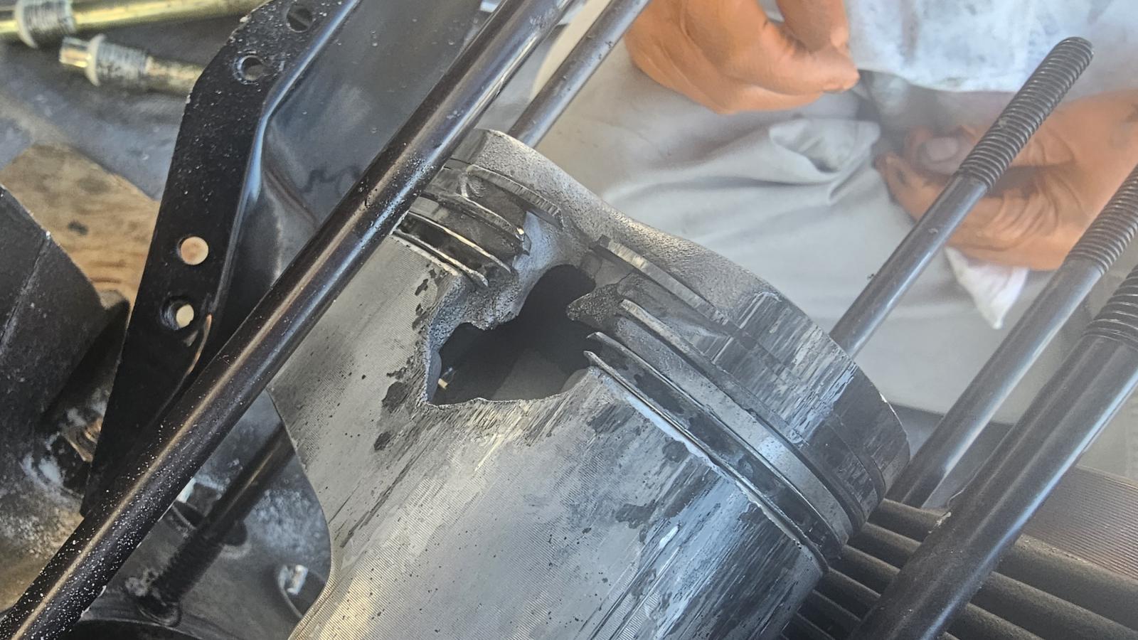

Yup, that was the setup I saw/worked on last September. It just had staggered jetting not the vents and velocity stacks.
Of course after we rejetted the carb. The owner turnt up the boost to max and fried a piston and head in short order.
One thing ive learned, you cant really complain about customers that do dumb stuff and are willing to pay for their mistakes to be fixed.
