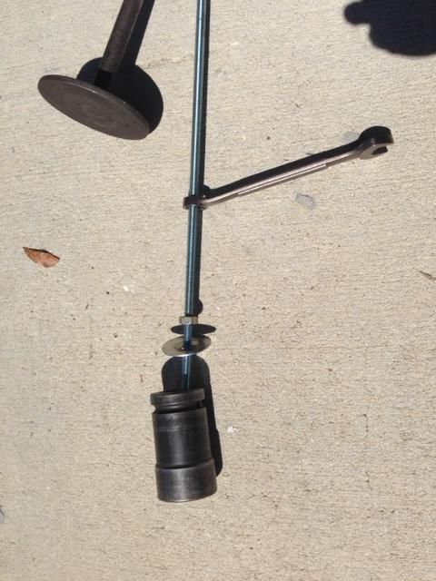

Thread a 10mm stud into the out shaft of trans(engine mounting studs work great) then use a socket and 10mm nut to push the seal into place, no hammering involved

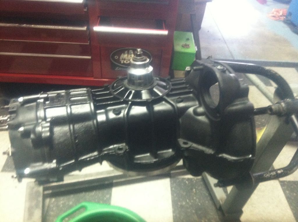

Just built this one today

PostPosted: Thu Oct 10, 2013 8:30 am    Post subject: Reply with quote
I believe it is, it measures 2.437 od. It will stop at the lip in the side cover so as not to push the seal in to far

PostPosted: Sat Oct 12, 2013 11:43 am    Post subject: Reply with quote
i can't thank you enough, mcmscott! once i got all the stuff together, it took me 5 minutes to get the seal and flange in place. the hardest part was getting that lock ring in (nearly took my eye out a couple of times).
went to the local hardware store and picked up a long piece of 10m 1.5. here are the pics. hopefully this helps someone in the future!
