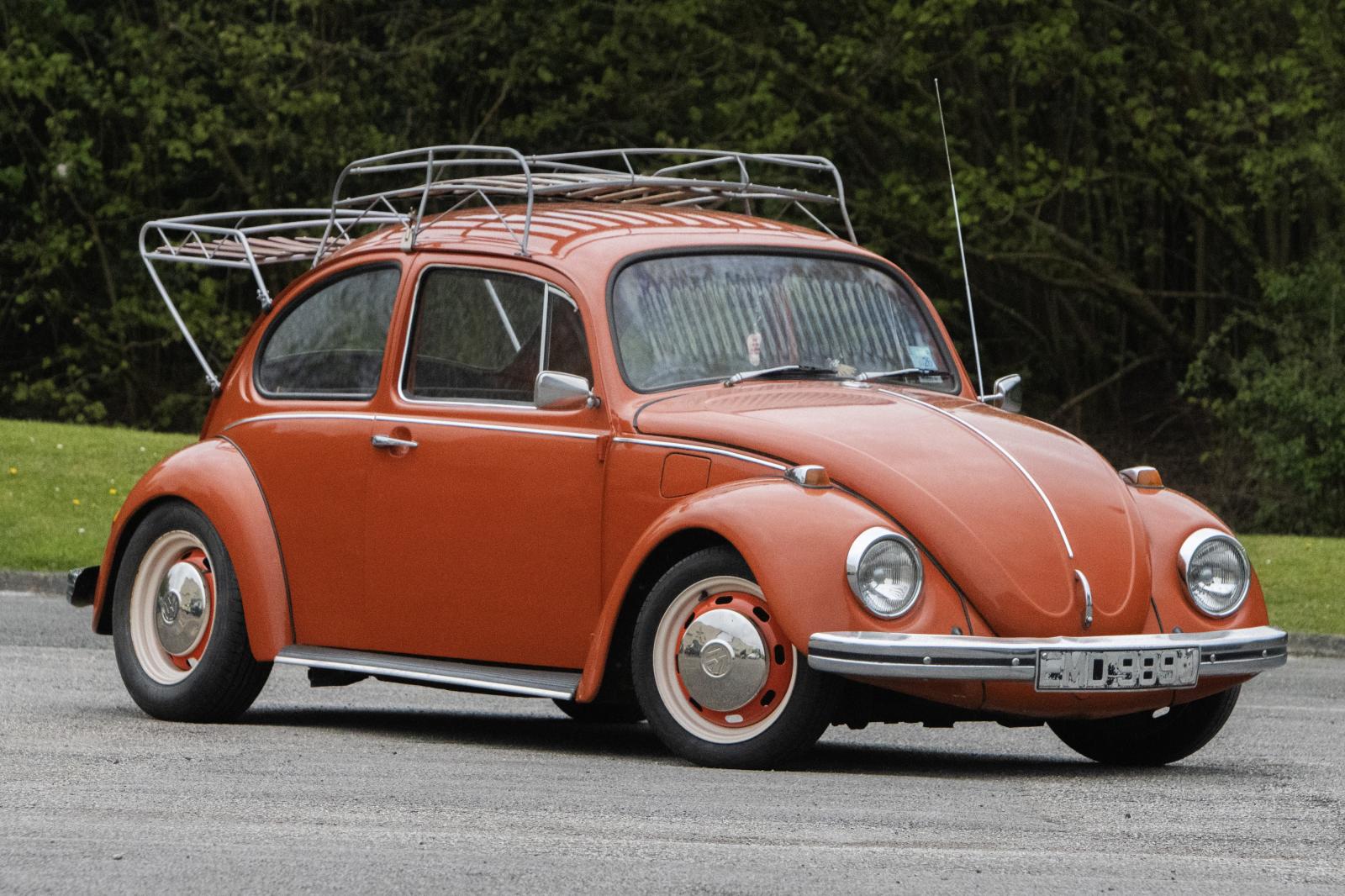

So the online auction website was playing up and I entered a bid for an orange Beetle. I bid low enough that I thought I wouldn't win but later that day got an email saying I was the winning bidder Shocked . I went to pick it up and I haven't stopped smiling since! It's a real Frankenbeetle and it has a lot of issues. I'm only going to drive it in the summer and will keep it in the garage. I'm willing to bet it will leak like a sieve in the rain and I haven't been brave enough to look at how bad the rust is underneath. But, it's mine and it makes me smile, hopefully it won't empty my bank account.

Wow, looks really sweet! Congrats. Love that rear roof rack, hoping to find one soon...!

I've never seen that rack before. My plan was to remove it but it's grown on me and I quite like it now, it'll be staying on for a while. I think it's made by a company called Flat4.

I really like the 'Stance' created by the tires. Digging it!!

Cool little car you got there, congrats. The mismatched tail, headlight and bumpers would drive me nuts but otherwise I'd drive it no problem (after replacing the brake and fuel lines as said above.)

Nice, those late slotted wheels actually look good in two-tone, and it has a solid stance. I really like the lates with metal dashes. I'm curious if the European 1300s came with the earlier taillights or if somebody swapped them for earliers.
And I never realized that Euro Beetles in the UK had speedos in MPH, I would've thought Km/h.

"I'm curious if the European 1300s came with the earlier taillights or if somebody swapped them for earliers."
Fairly confidant the earlier tail lights have been swapped. Headlights and bumpers appear correct

I don't think it is. It is a bit of a Frankenbeetle so not all the parts belong together from factory. It was registered in 1971 but has had a lot of work done over the years. It originally left the factory with a 1200 engine which was replaced with a 1300tp along the way.
