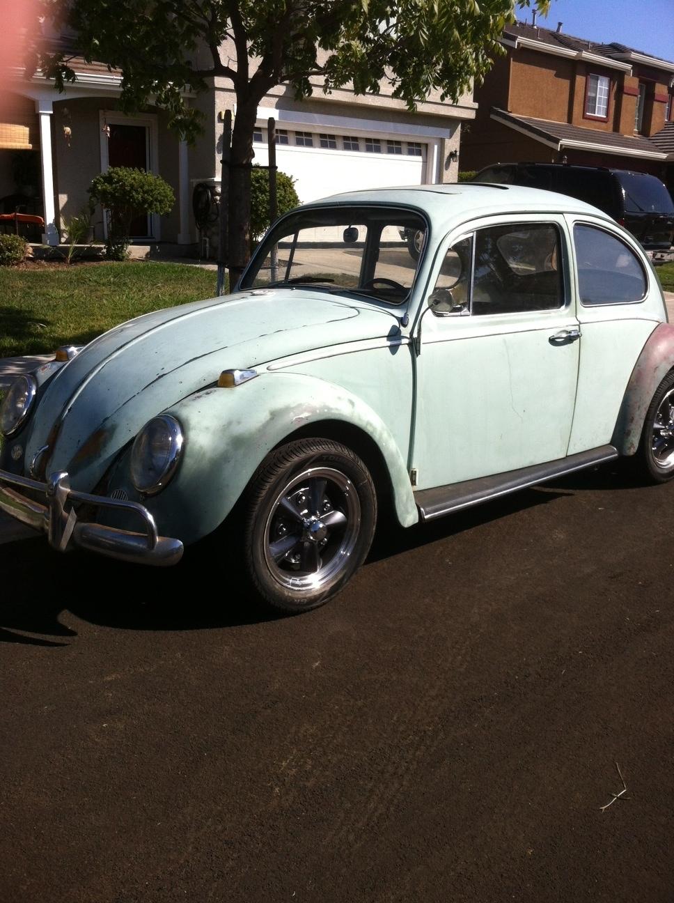

This is what she looked like before I started:
she was basically intact but in need of some basic repairs....

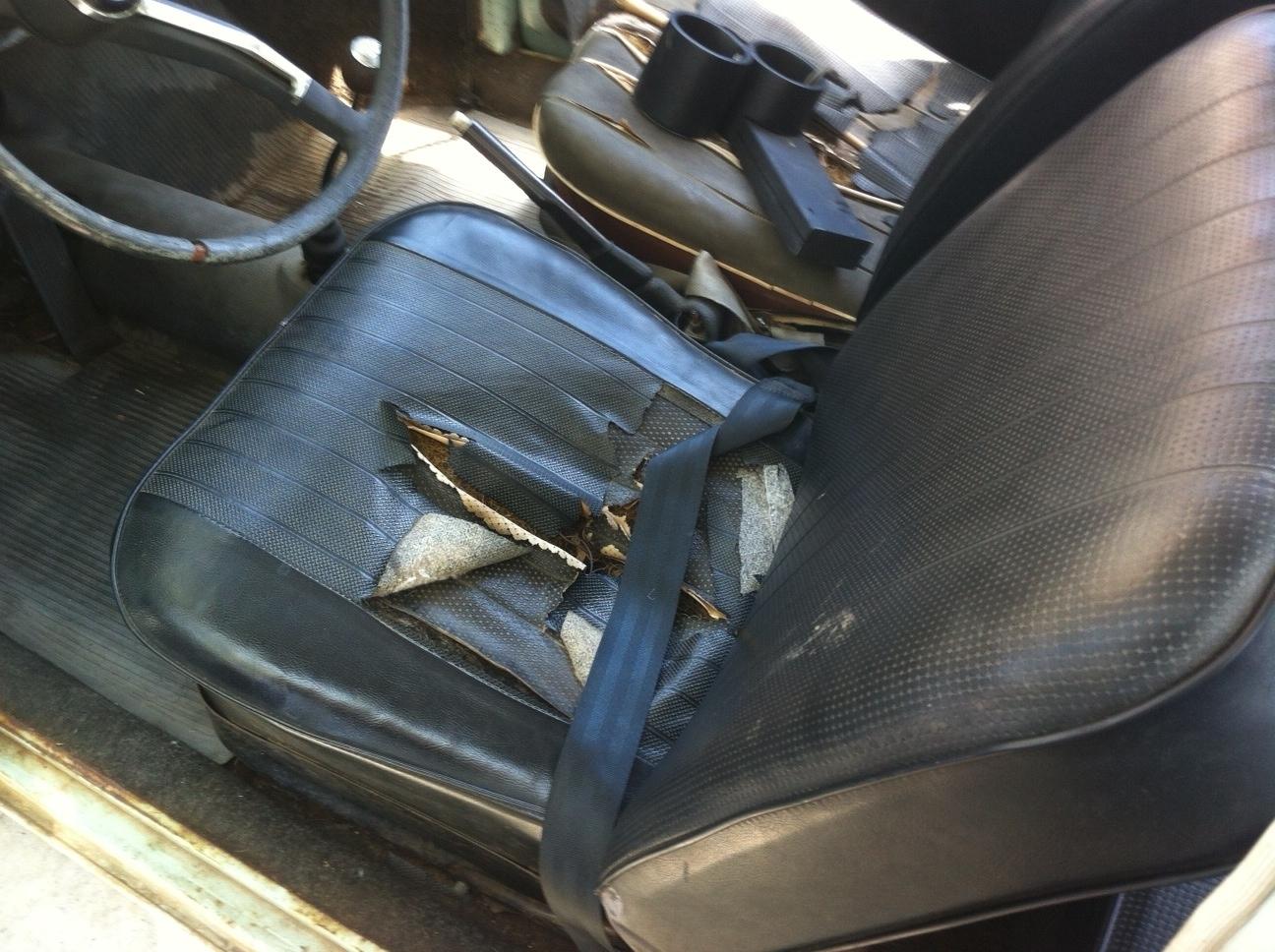

The interior was trashed.

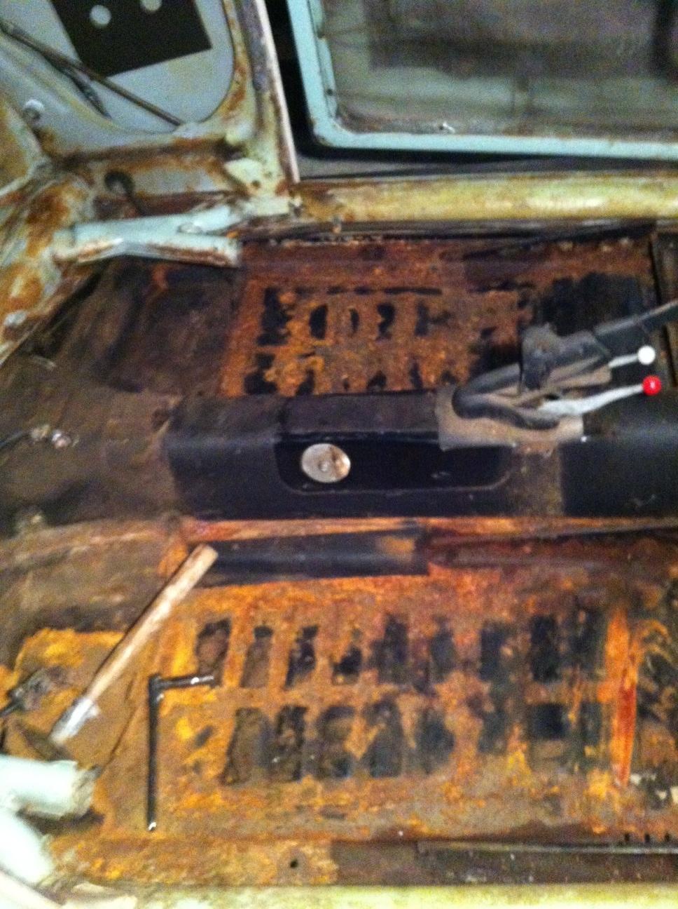

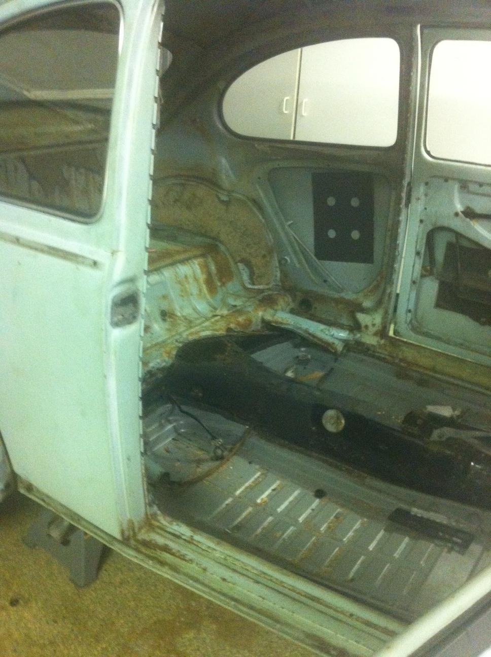

I knew it would need to be replaced. I removed the seats and found I had rusted pans.

My first major project was replacing the pans with Wolfsburg West replacement pans. After they had been cut out, I was told that the pans were actually in good shape, and I should have just repaired them. Rolling Eyes

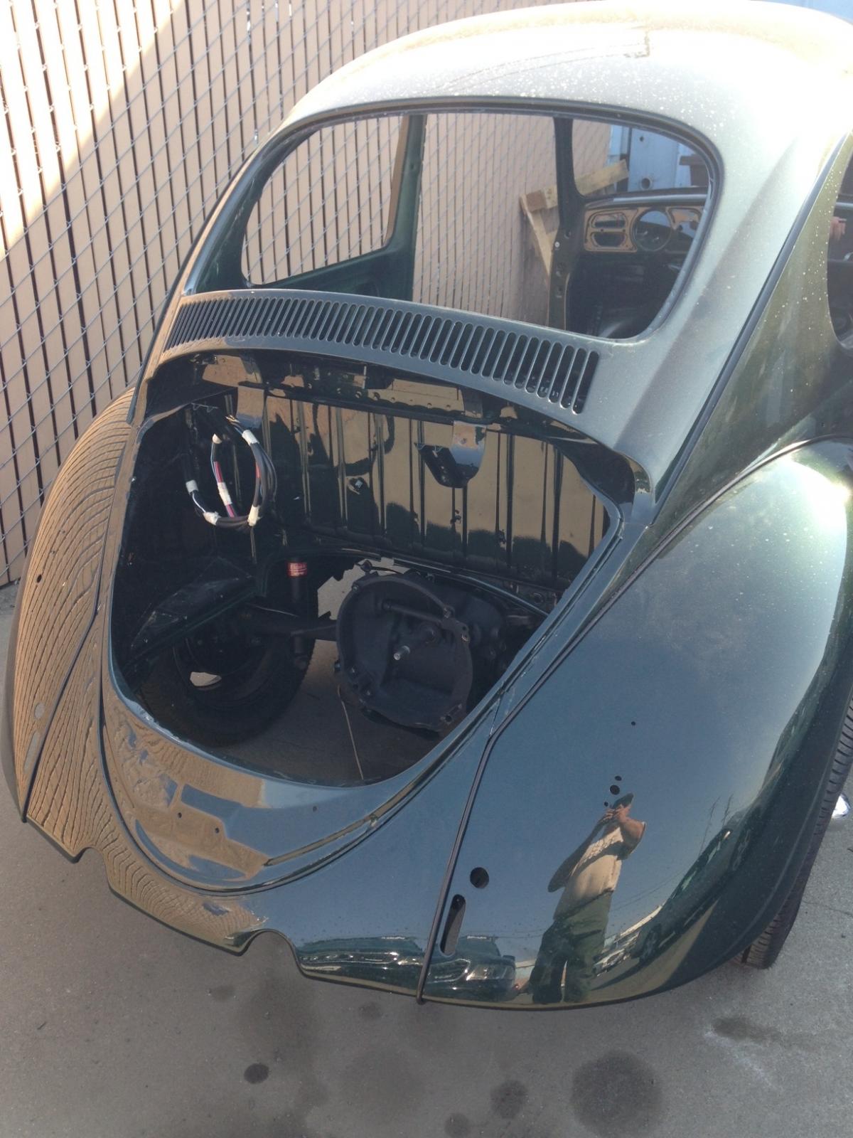

The car went to the sand blaster in pieces.

The body came out fantastic, and very little rust. Some around where the fenders attach, and a few pinholes in the sunroof.
The pan was blasted and coated. Underneath with a spray on truck liner, inside with a spray on heat resistant and sound dampening material.

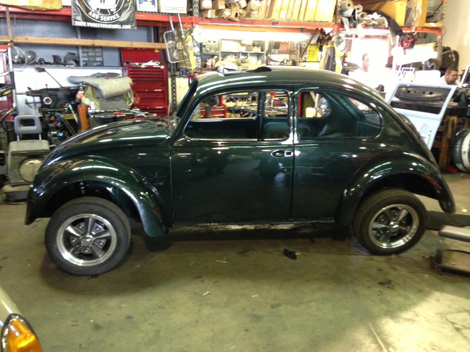

I had to get some replacement panels for the apron and the vertical piece just inside the apron. It was a labor intensive welding job and added considerably to the bodywork budget. But the guys at Mayshore Autobody did a fine job. In addition, someone had at one time cut out the stock radio slot to fit in some POS 80's stereo. I got replacement panels and knockout panels from Wolfsburg West. I wanted a clean look in the interior.
Finally, the paint went on.
While the body work was being done, I was re-building the chassis.

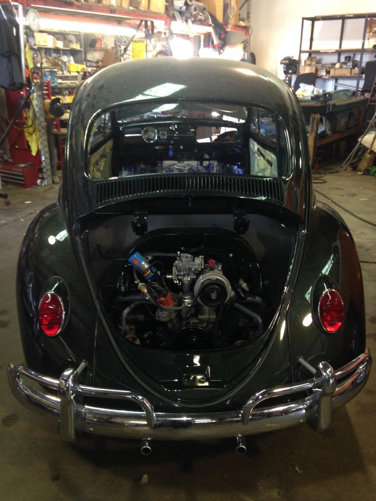

Then engine was being rebuilt at LaVere's in Concord, CA. It may or may not be the original motor. It was a 1300cc block with an old number, but it had been bored out to 1600cc. I wanted to put it back together with this motor, but plan on putting in a high performance motor later on down the line. In order to prepare for the higher HP motor, I upgraded the transaxle with a new "freeway flyer" from Rancho.

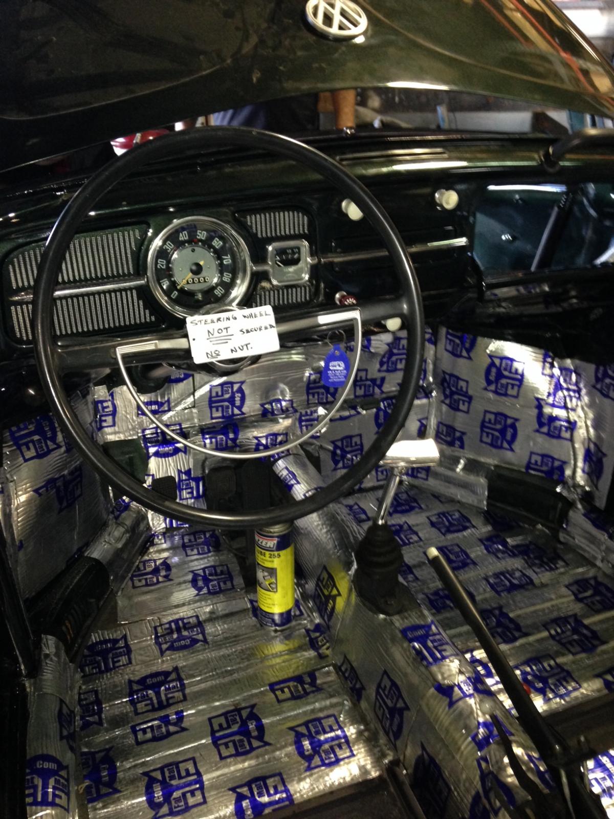

I decided to install FatMat for more sound dampening.

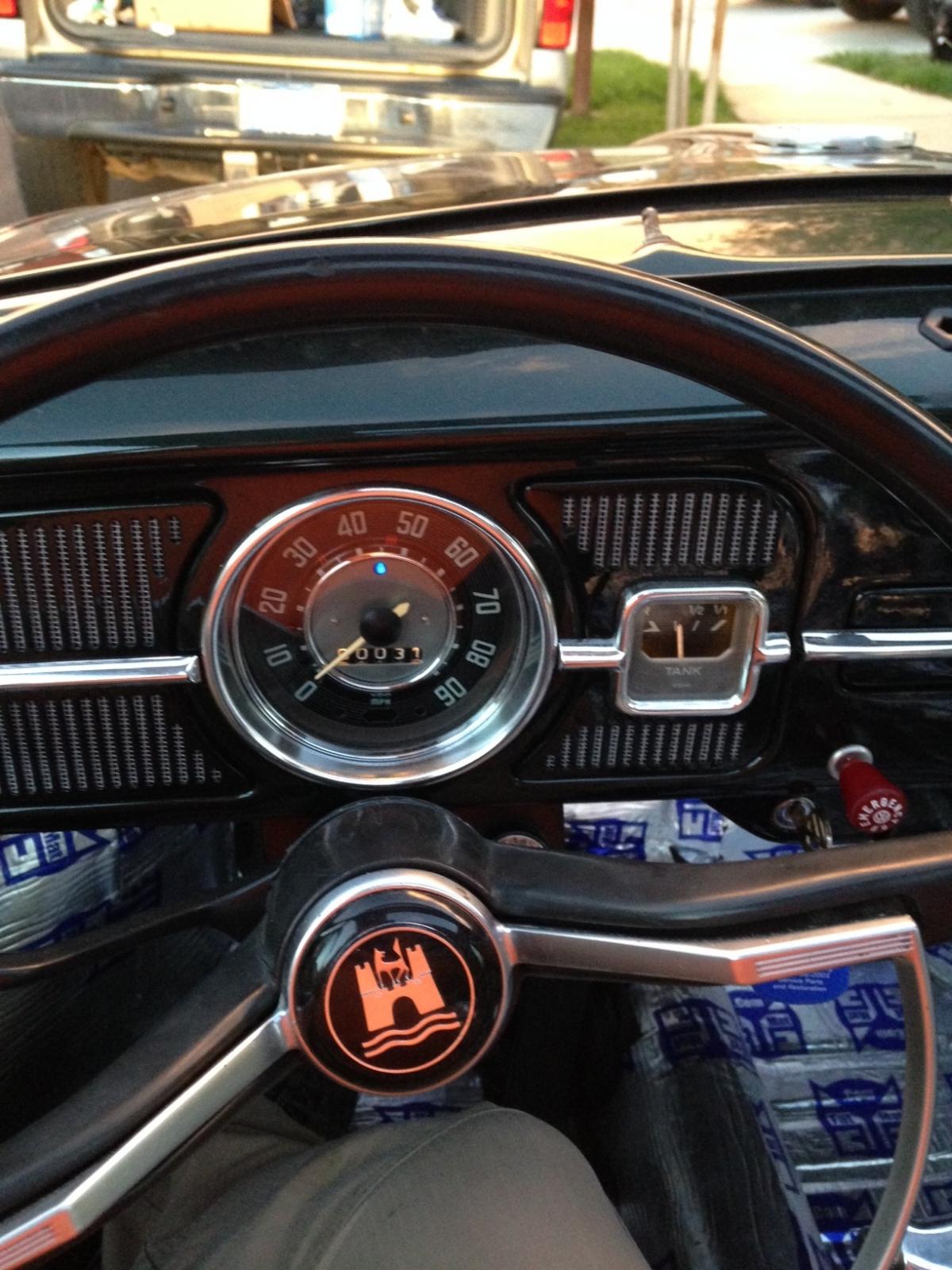

At this point, the car is back home. I installed the fuel tank and battery. It only took about 20-30 seconds to get the fuel from the tank to the carb. It started off rough but evened out after a few seconds and then purred like a kitten. It won't drive yet, it needs a clutch adjustment and I'm not sure if the brakes are adjusted yet. Plus it has no windshield.
It needs to go back to the body shop to address a few minor issues. Then on to the upholstery shop for the interior. I chose Bob's Custom Interiors in Hayward, CA for that. Doug will be getting the car soon.
