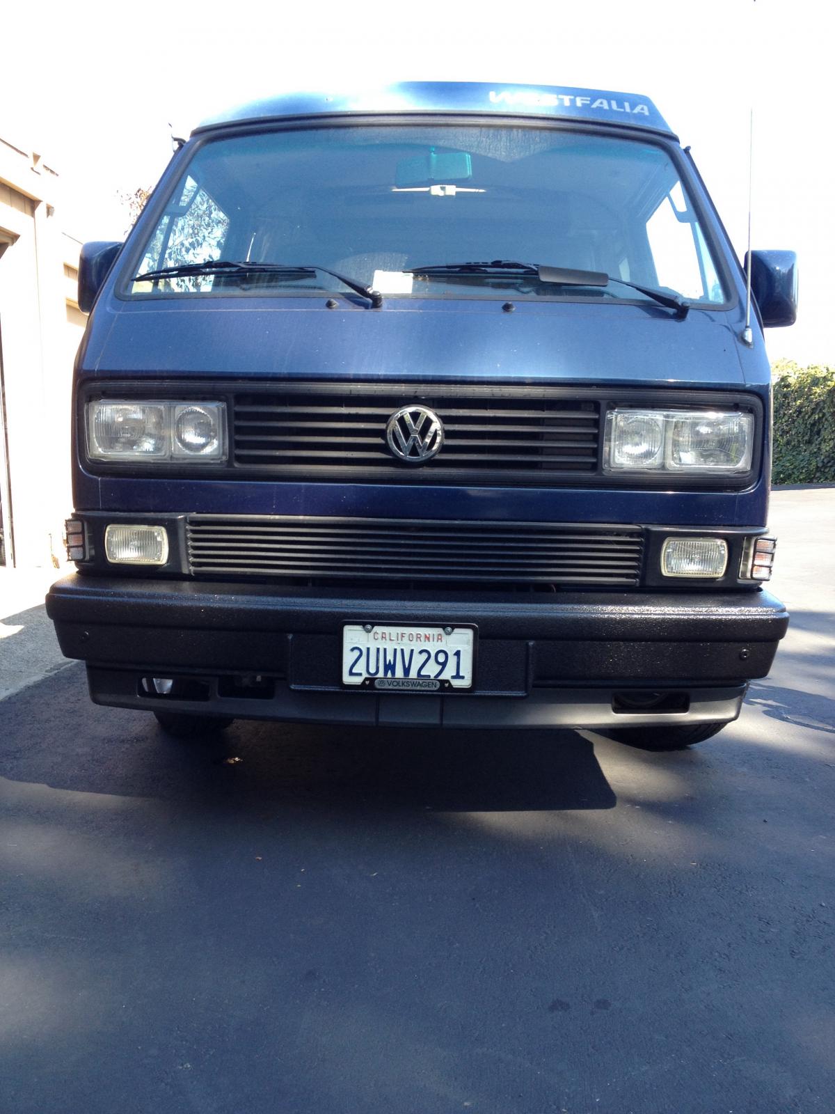

I was able to re-install the front bumper and front door cladding plus the front air dam pieces. I painted the air dam with Duplicolir bumper coating. Not sure I want to do them with bedliner. Hard to show how good the bumpers look with iPhone pics.
Next up is the rear bumper with Burley hitch bar. Maybe I get to install this afternoon.
The other thing is now with shiny bumpers it is clear I need to re-paint the upper and lower grills and would also like to get shinier TerraWagen postal flare repros. The postal flares look a bit dull right next to the bedliner bumpers, maybe I can apply some Forever Black on them.

Rear bumper with Burley hitch is in! I need to do some touch up painting and a bit more detail work to adjust the side bumper pieces but here is pretty much how this looks including some special decoration from my little helpers.

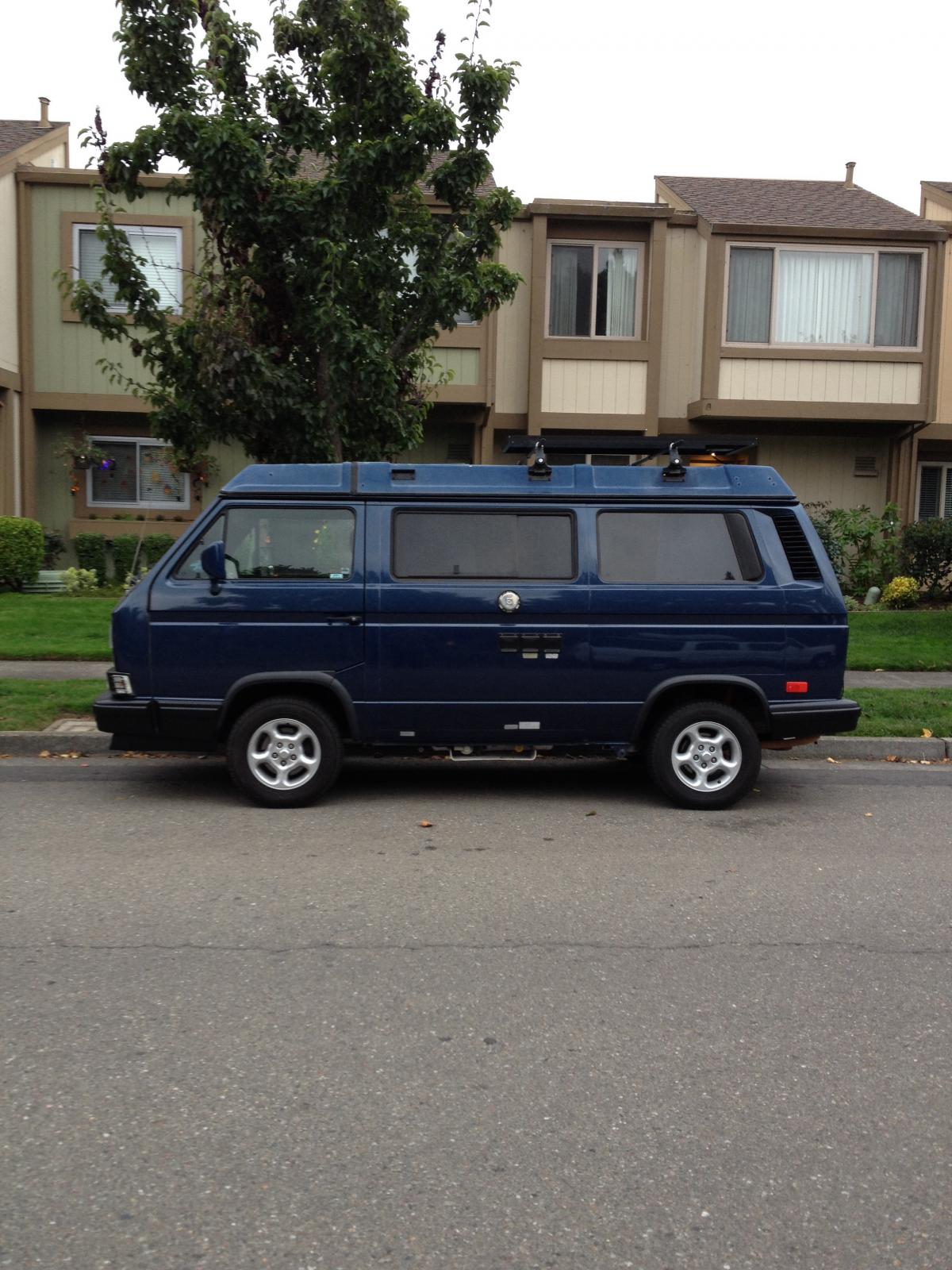

Can we get a nice side profile pic of the entire Vanagon w/bedliner?
Oops... now I see that maybe they are not installed yet.

Hard to show detail , no color contrast with Orly blue on cloudy day
