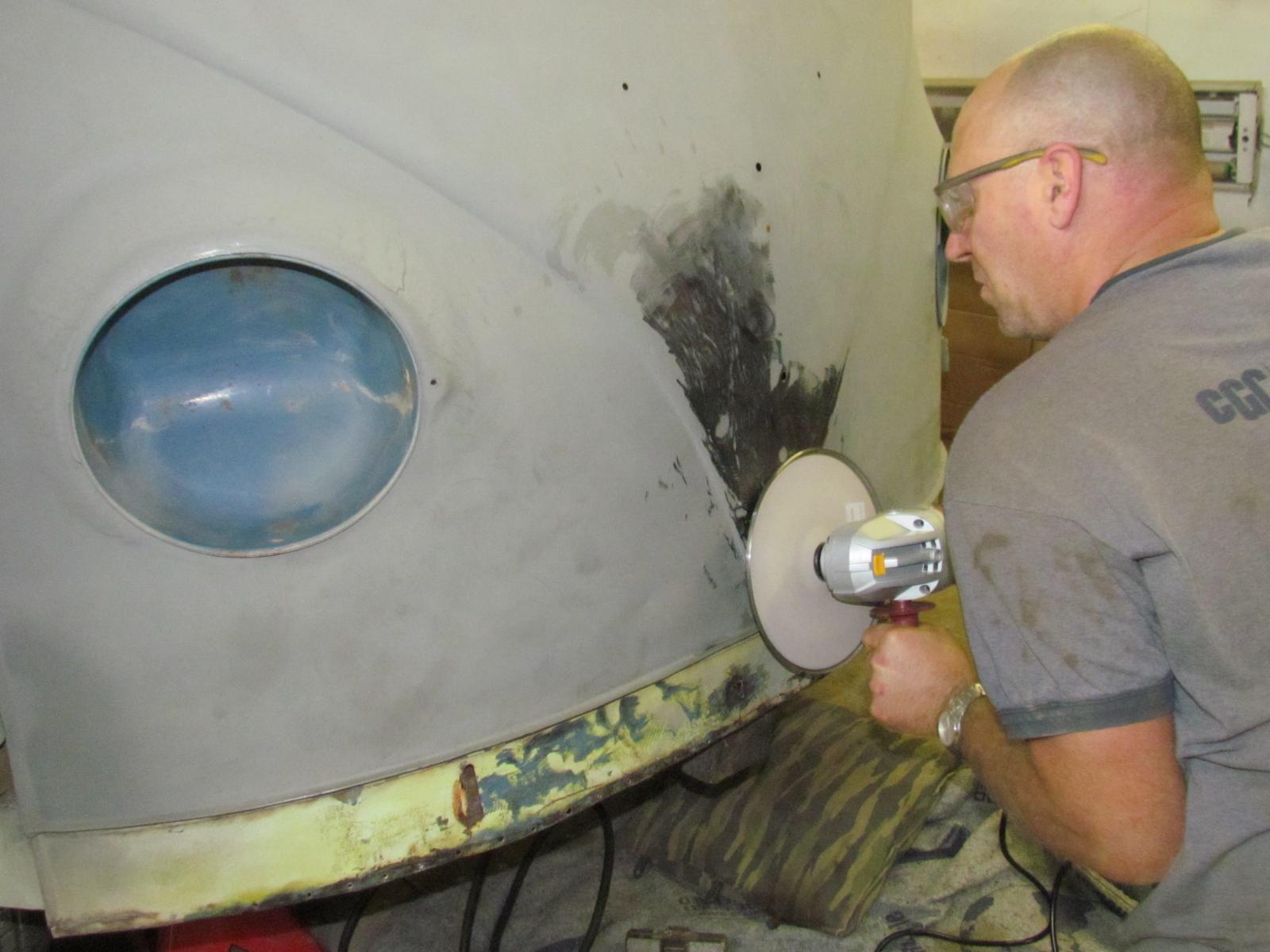

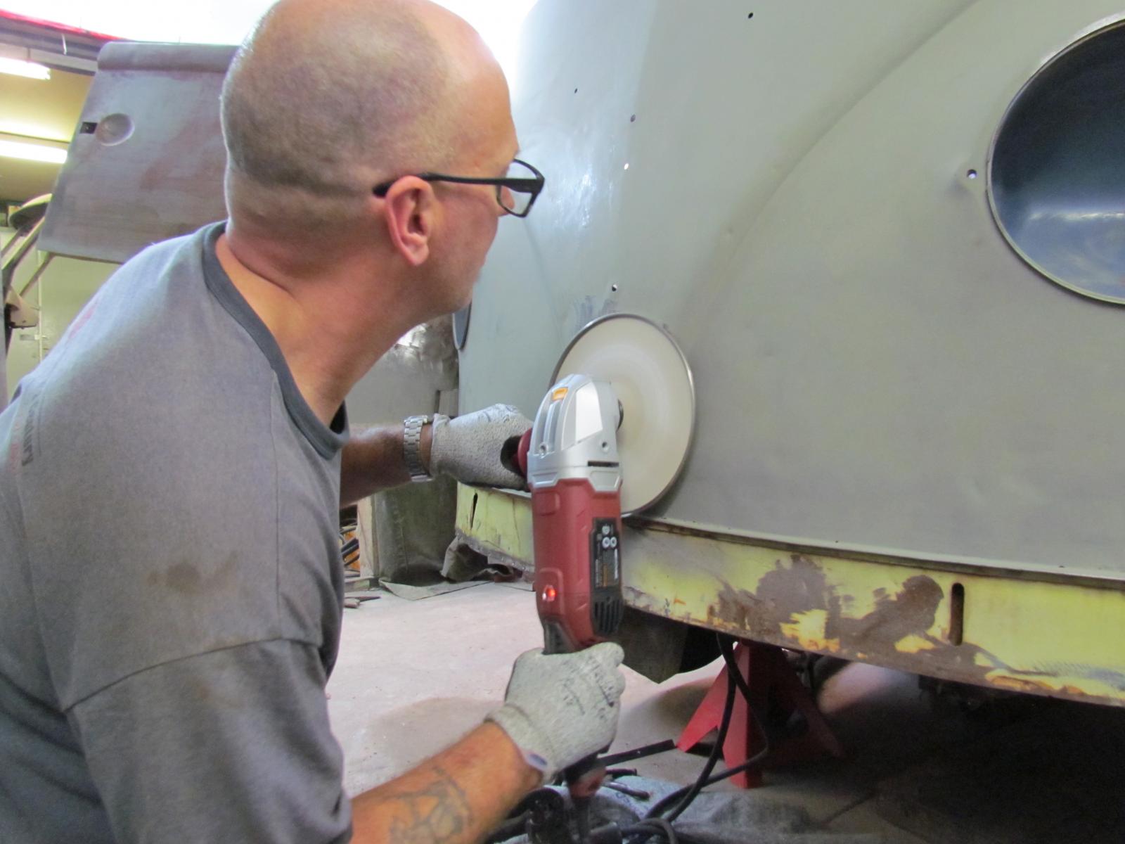

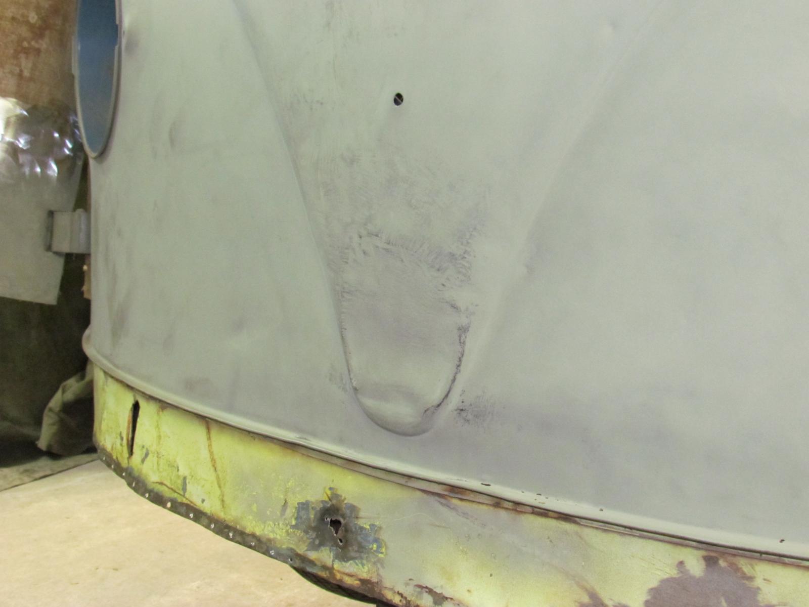

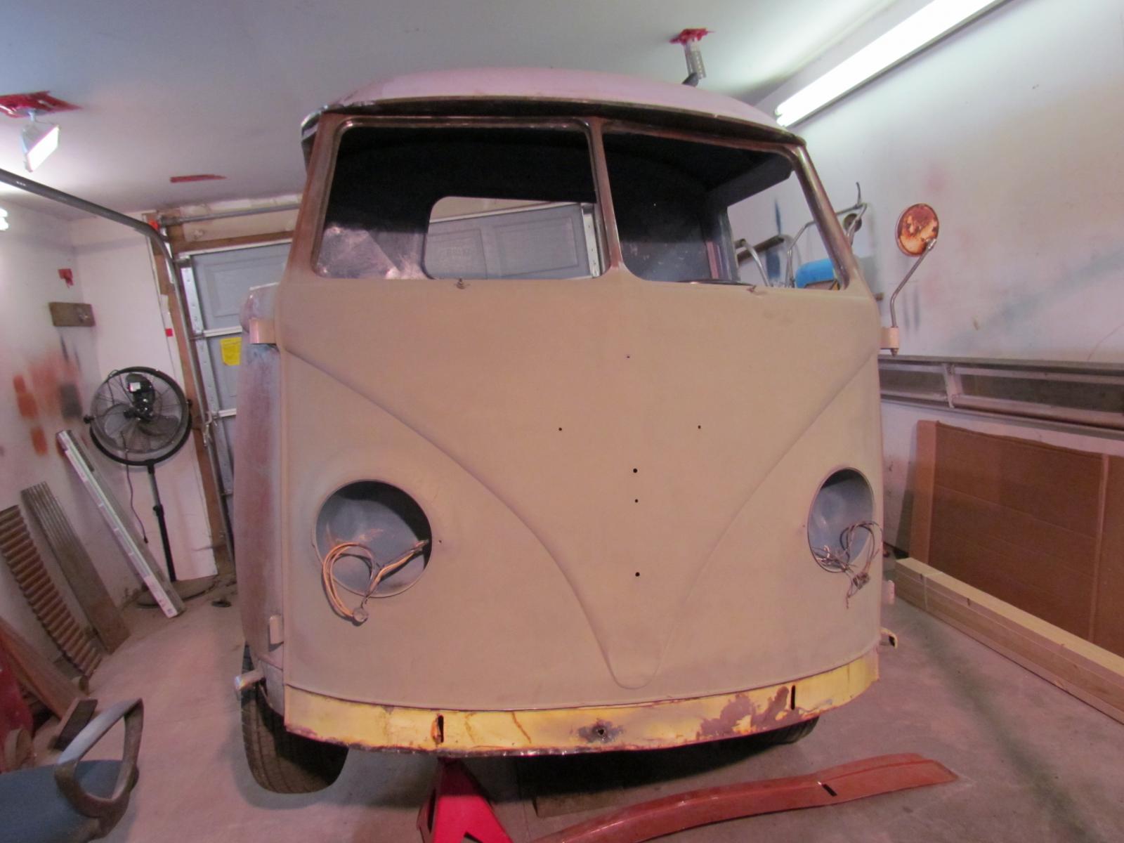

Tom working his magic on the dent in the front nose. We didn't want to use filler here. Allot of work and massaging of the metal, but making sure it's done right the first time

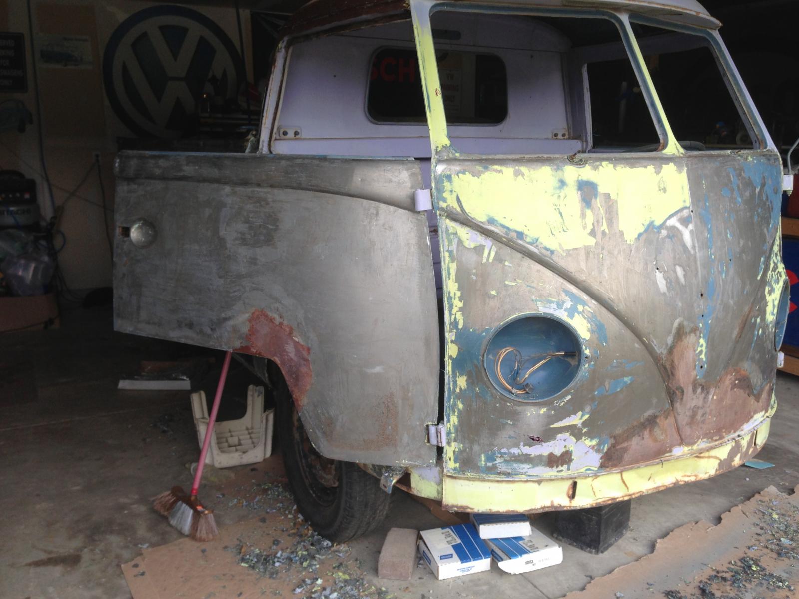

Striping paint to bare metal

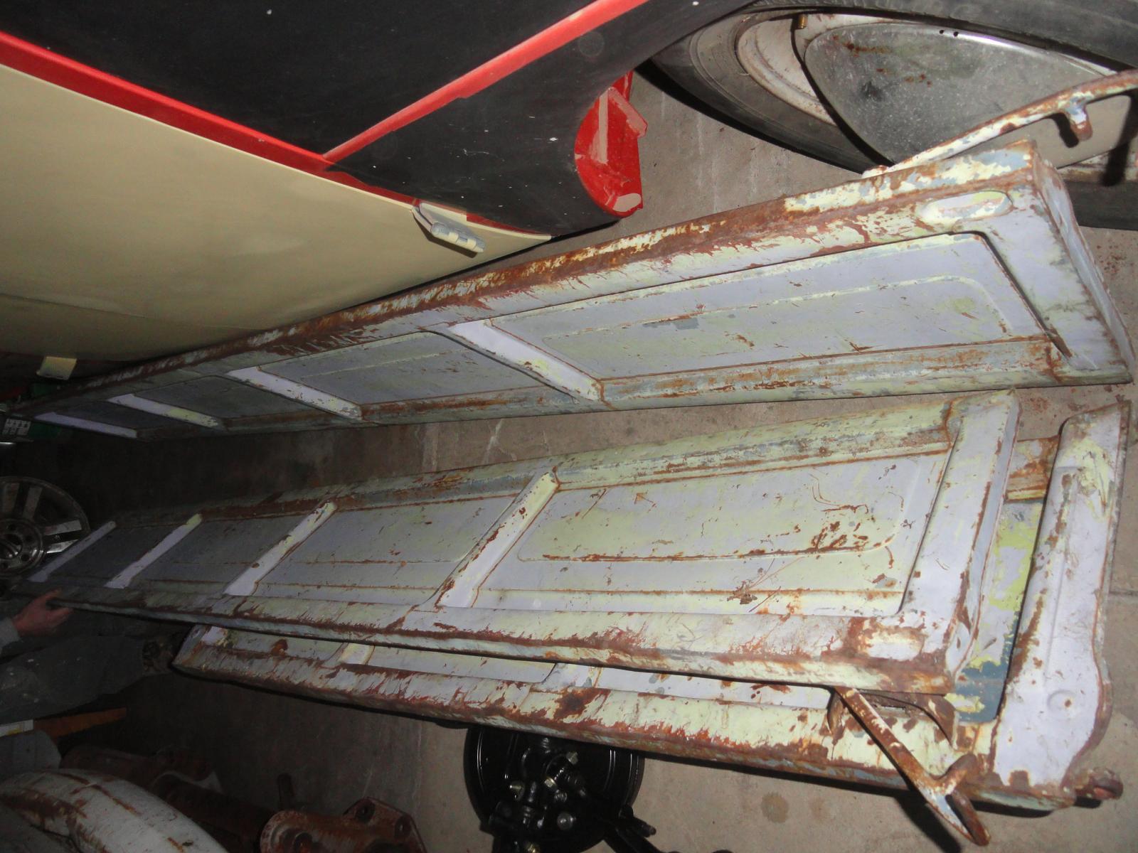

All Gates Present and in great condition.....

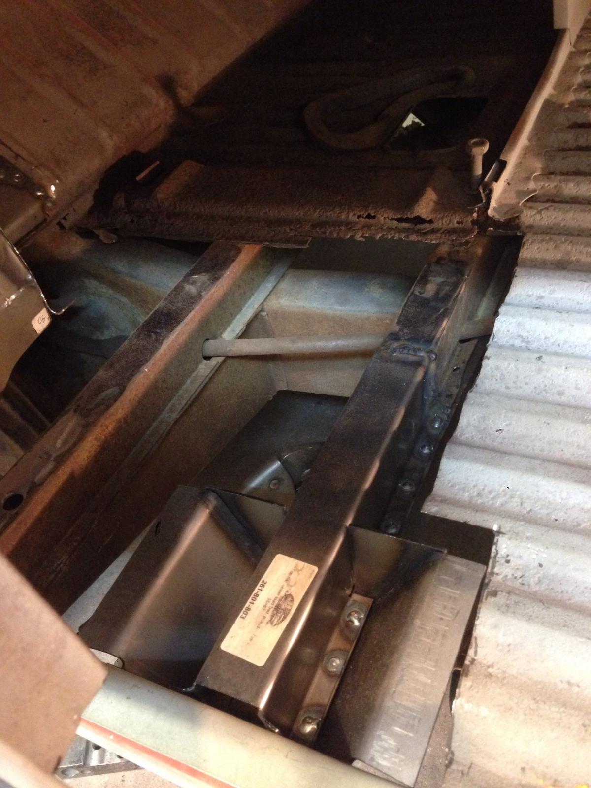

Rust repair started.....out with the old......In with the new. Using nothing but the best metal...Auto Craft. Contact Tom ferrier at www.eastcoastcornerstore.com for all your repair metal

Cool, looks great so far.
Is he reaching all the way into the inner nose with a dolly?
For some reason I was thinking the distance was too far and the clearance too tight to do be able to do that.
Or maybe he has a spoon in there?

Thanks for the comments. We sacrificed 2 footballs, one mini soccer ball and 2 hand pumps to help push out the dent. The rest was done by heating up the metal with this tool....cooling it....and working the metal. It's was crazy watching the metal move, shift and pop out.... A real art.

PostPosted: Sun Nov 03, 2013 5:29 am    Post subject: Reply with quote
Hey Ev hehe I've been told by some I have long monkey arms but there is no way I can reach that far.
When the dolly was required Dave got to get inside and see just how tinny and acoustically magical these things really are. Then the small 4 inch Walmart soccer ball worked great until it exploded. Yes really LOUD
Sometimes I used the football pressure for some "off dolly" work
I put about 4 hours on the nose and probably have another 3 or 4 to go
That is the Wray Schelin amazing shrink disc it is the best tool that I have ever purchased.
Looks like I am comparing noses
It's a long-handled dolly, similar to a spoon, that fits in to that tight space that you can't otherwise reach. Handy tool.
The shrink disc is where its at for working a bus nose over.

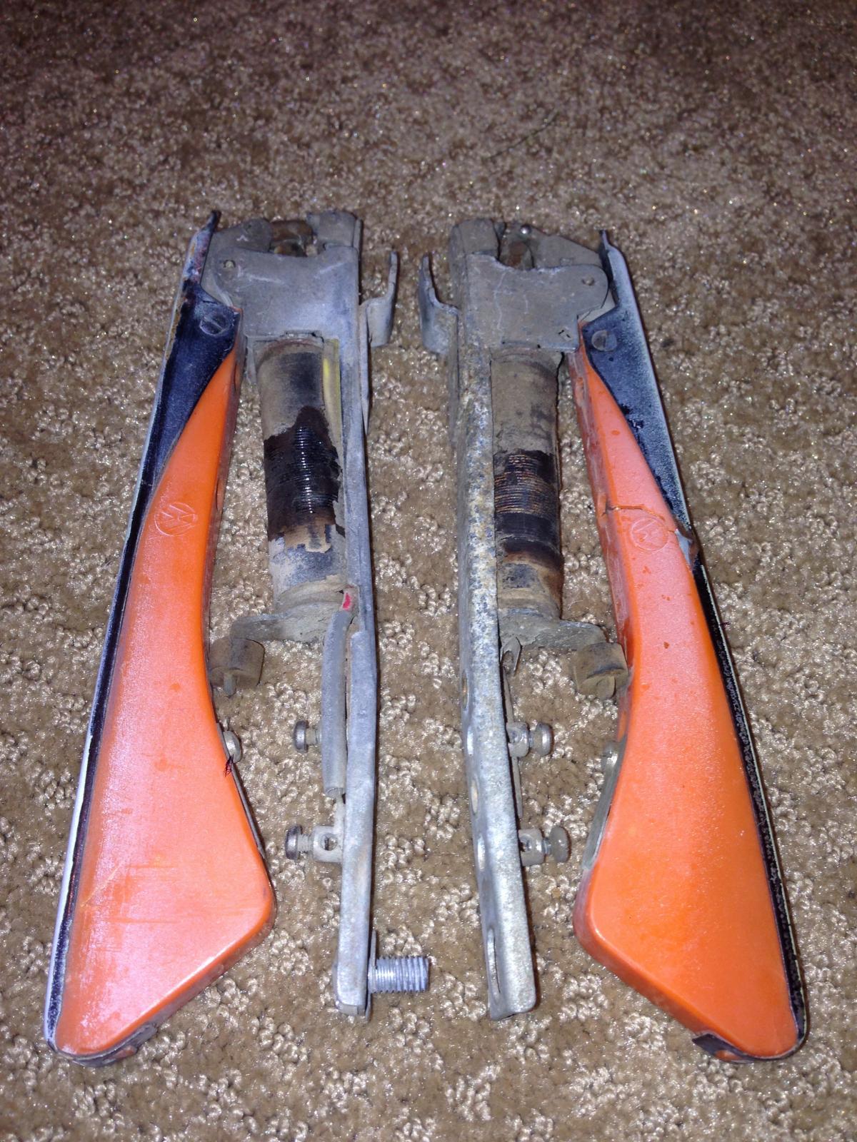

Here are some of the OG goodies for the '55 SC build.

Can anyone explain what these threaded inserts are used for? One on each side. Are they for the canopy set up?
Buba
Joined: February 23, 2003
Posts: 383
Location: Argentina
Buba is offline
PostPosted: Mon Nov 18, 2013 2:18 pm    Post subject: Reply with quote
Yes. They are for the front hoops

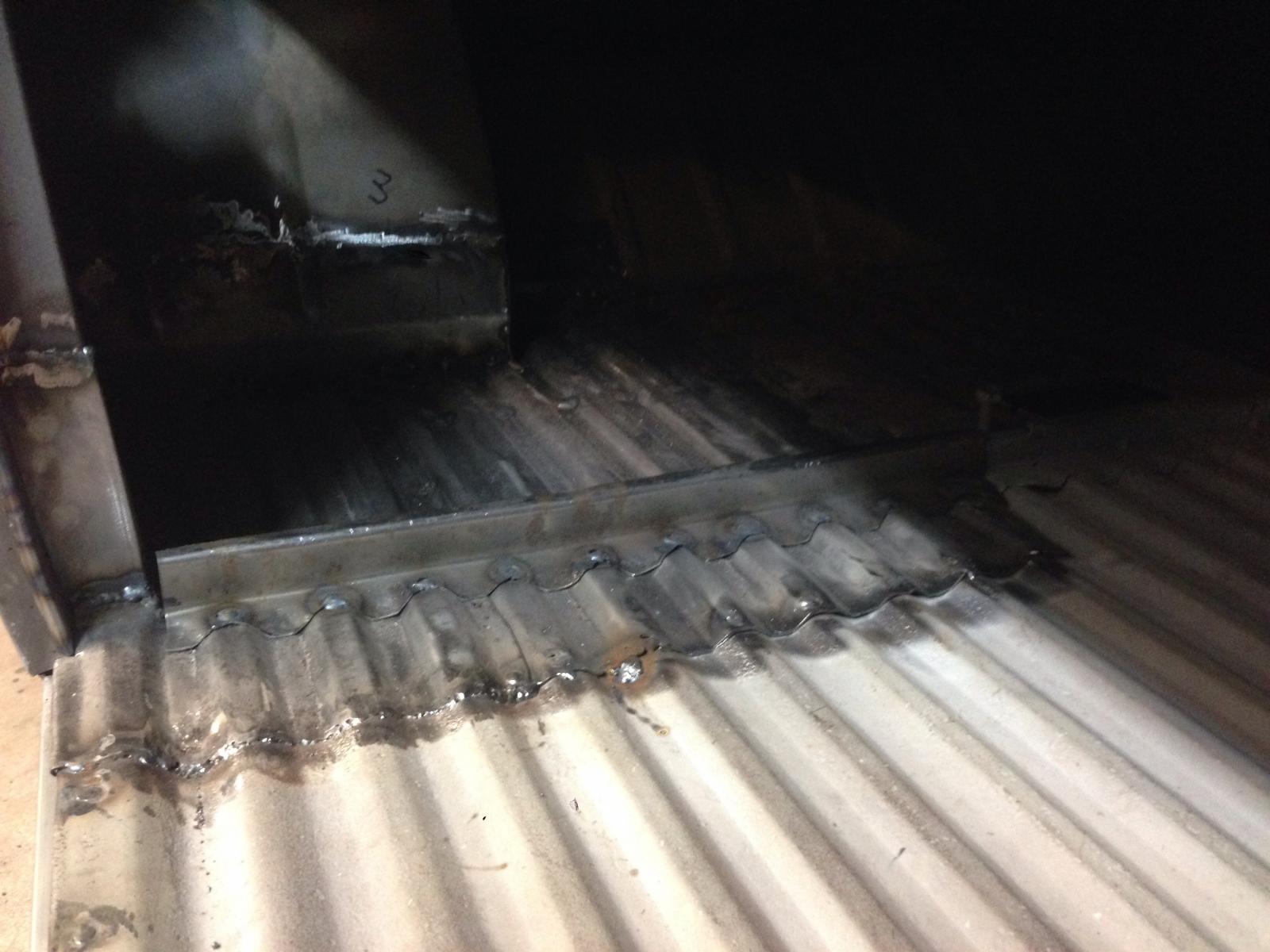

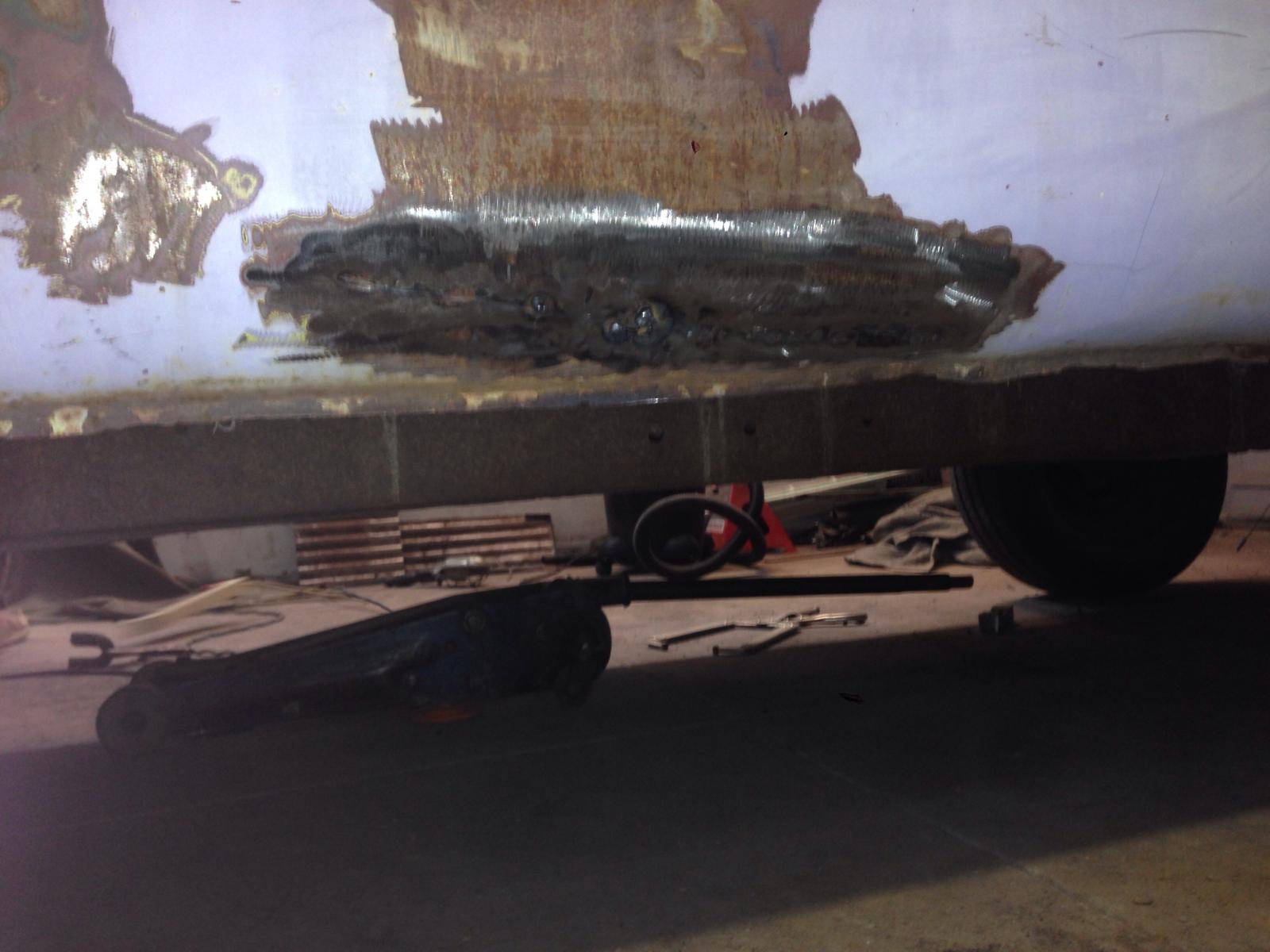

PostPosted: Wed Dec 04, 2013 7:38 pm    Post subject: Welding Reply with quote
Progress.

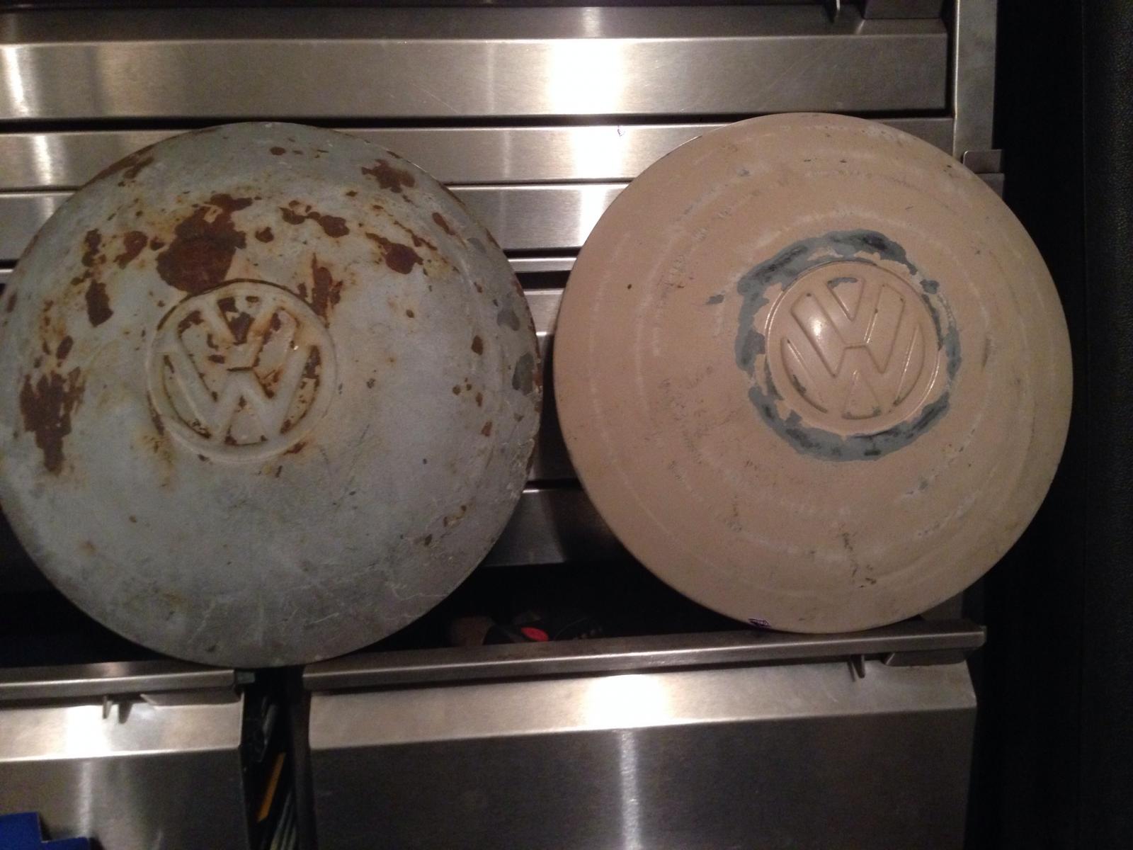

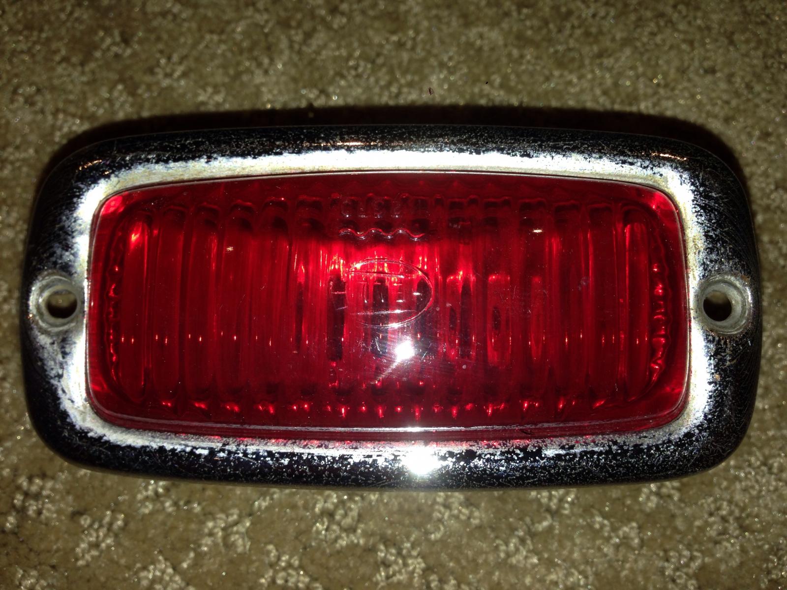

PostPosted: Sun Jan 19, 2014 2:38 pm    Post subject: Hubcaps Reply with quote
Commercial hubcaps. Cleaning right back to metal.

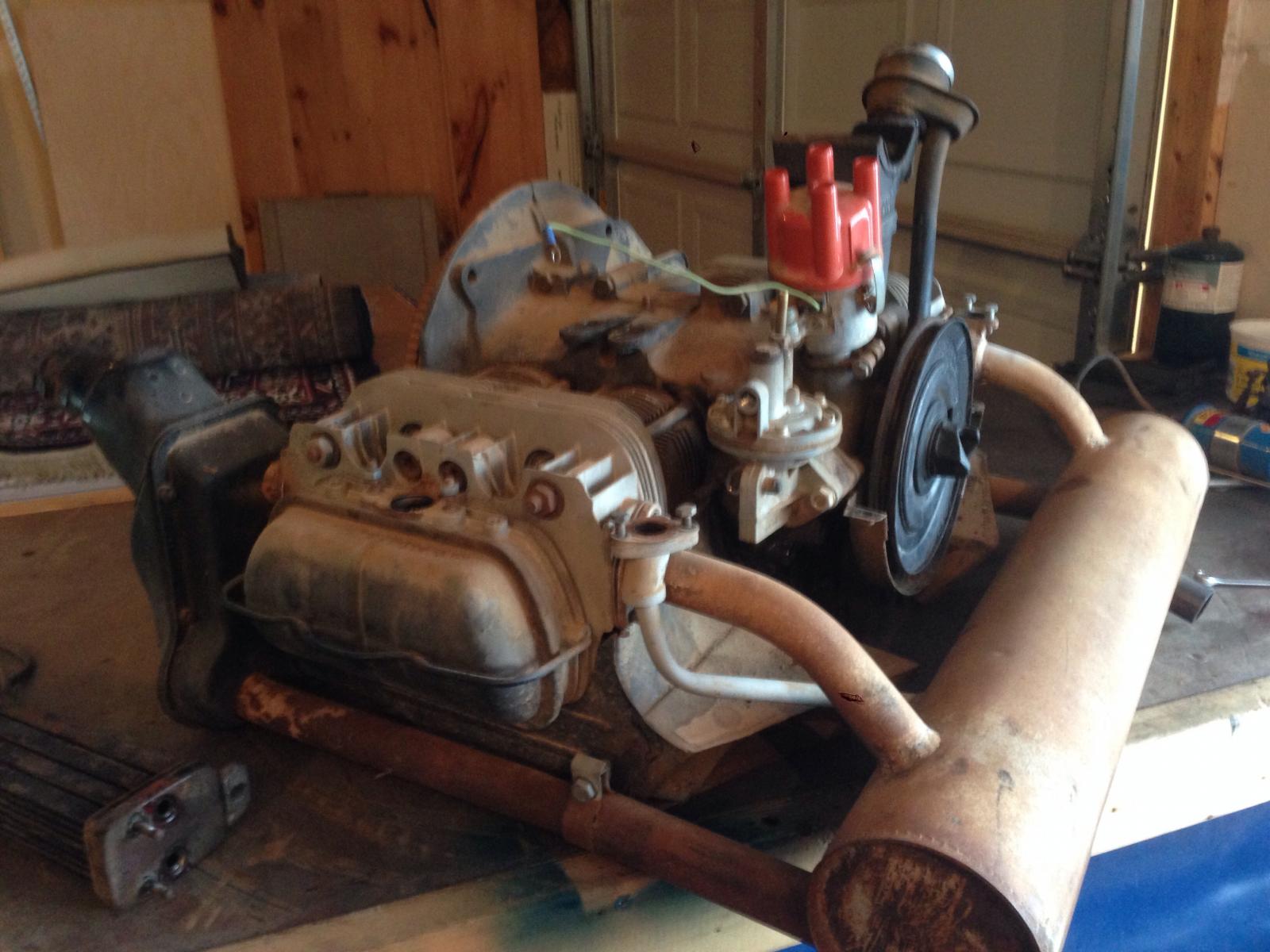

PostPosted: Sat Feb 01, 2014 5:36 pm    Post subject: Engine dismantle Reply with quote
Original motor with some incorrect parts. Stay tuned for what's next!

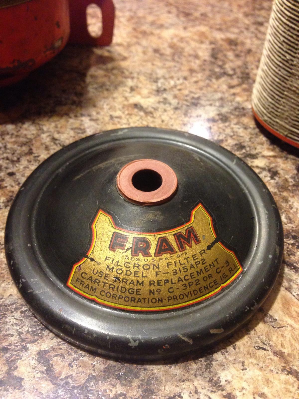

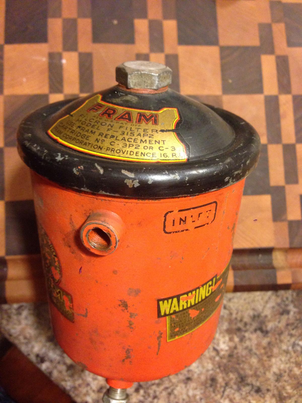

PostPosted: Thu Feb 13, 2014 7:03 pm    Post subject: oil Filter Reply with quote
Here's an NOS Fram filter I've had for a while. Going to add this to the express motor build. Plan is to restore. Thoughts??
Posts: 71896
PostPosted: Thu Feb 13, 2014 10:32 pm    Post subject: Reply with quote
Thoughts - Do it.

PostPosted: Fri Feb 14, 2014 2:04 am    Post subject: Reply with quote
Thoughts - Do it.
do it express or do it restore?
shiny paint doesnt make it worth any more

PostPosted: Fri Feb 14, 2014 7:04 am    Post subject: Reply with quote
Should I add it to the express build. I've heard mixed feelings about running these filters. Can anyone chime in and let me know how the've made out if the've run one?
I think I'll strip this one right down and give it a new fresh look....

PostPosted: Fri Feb 14, 2014 8:49 am    Post subject: Reply with quote
D-train wrote:
Thoughts - Do it.
I meant yes, add it to the build.
People have posted they are not as efficient as a real full flow system but I was thinking add it just for the look since you have one.
