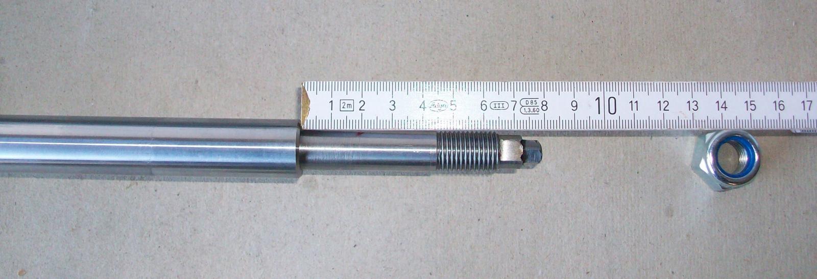

I have attached a photo of the NOS Top Mounts I have that have the inner bearing.

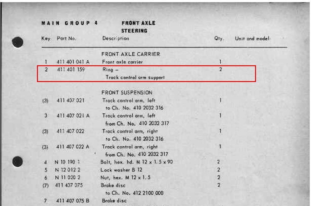

The centering rings....you cannot SEE whether you have them without at least pulling the rear bolt out of each side, removing the dished washer and rear most rubber donut.
The centering rings were little thin, flanged rings that keep the radius arm centered in the eye and prevent vibration and wear. They were made of the wrong material hardness and they either disintegrate to dust because they were never greased...or they fall out and roll away when being worked on and most mechanics never knew they were there.
There are about 3 ways you can easily make this part for pennies. Its really a packing to be made of plastic that is high wear like Delrin or nylon. It does not have to be the grommet shape the factory made it.
AS for whether your shocks are adjustable...I think they are. That black knob in the picture is an adjusting knob. The tops of your strut rods have double hex flanges. The lower one the larger one...is usually for tightening the nut down. The smaller one looks like what you turn to adjust the valving. Ray
