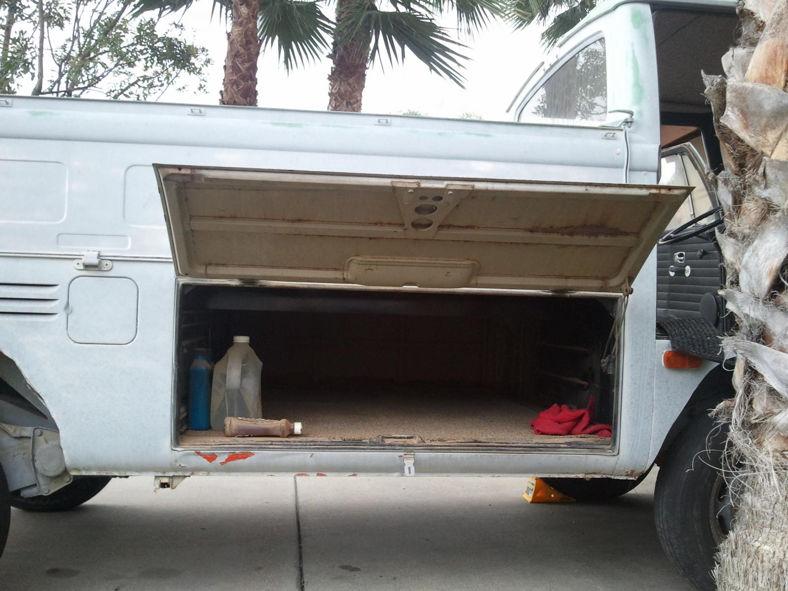

The treasure chest was a fun bit too, PO had put a big piece of carpet in and left me with 3 quarts of oil and a gallon of orange juice. How thoughtful. Of course the lock and lock cover are missing, meaning I have to shell out for those.

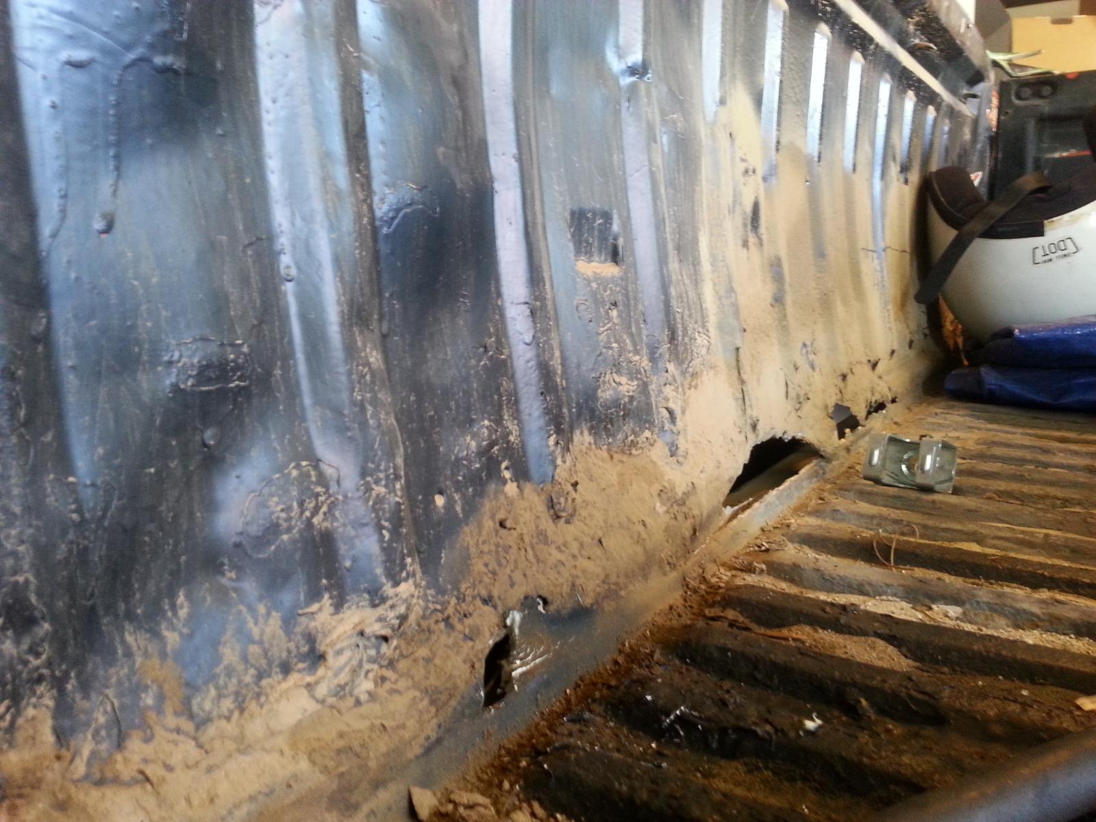

I fell in love with these trucks because of the beds. 9 feet long and 5 feet wide, 45 square interrupted feet of bed. But in the picture here you can see the cab divider is covered up, I wonder why?

Some time after, I decided it was a good time to tackle the treasure chest. I'll tell you what, I thought I was going to die in there.
I crawled in with an angle grinder with a wire wheel attachment and scrapped off all the surface rust. Sprayed some primer and coated it with bed liner. All with Harbor Freight respirator and swimming goggles Laughing
I'd have more pictures but its all black, nothing really to see.

So today while cleaning the garage I decided to take a crack at what was hiding under the nice bed liner. It was a mix of paint and putty. I started to peel one of the sections off and it looked as so:
And of course its all the way down this cross member.
I also started to peel more at the cab divider.
