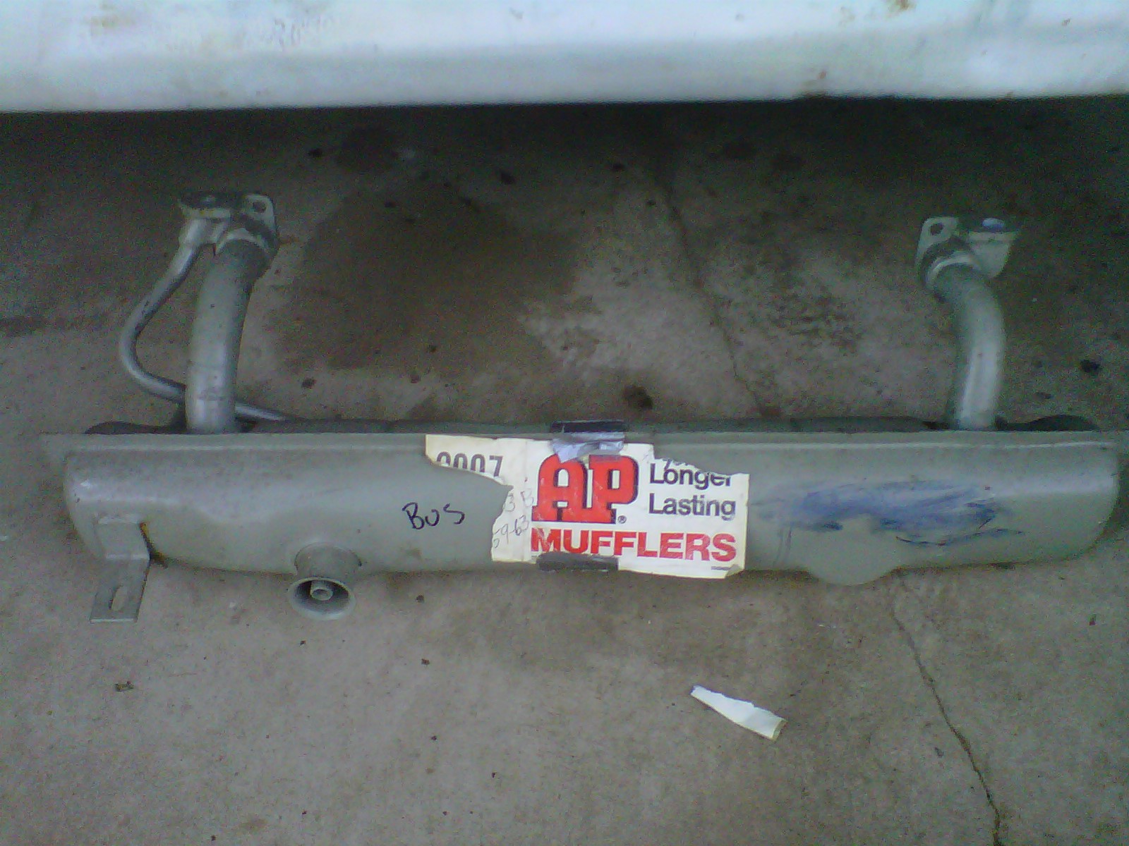

hey all , what are the differences in the bus exhausts? my bus motor is a 1500 any pics of the changes would be greatfully received thanks in advance neil

1200 thru 1600 bus exhaust pretty much looks the same

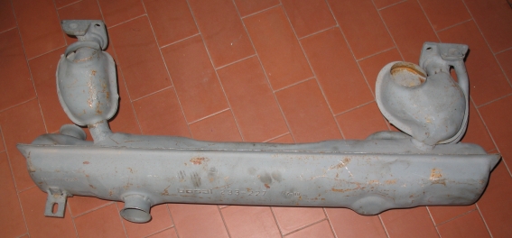

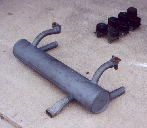

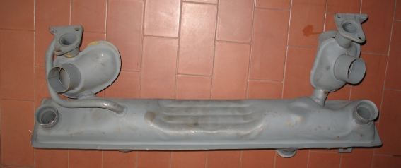

1200 has less width between the connections to the heat exchangers and heads.

Also early 1200s have no upper heater box pieces. "Stale air heating".
36hp style
40hp style
1500/1600 style
