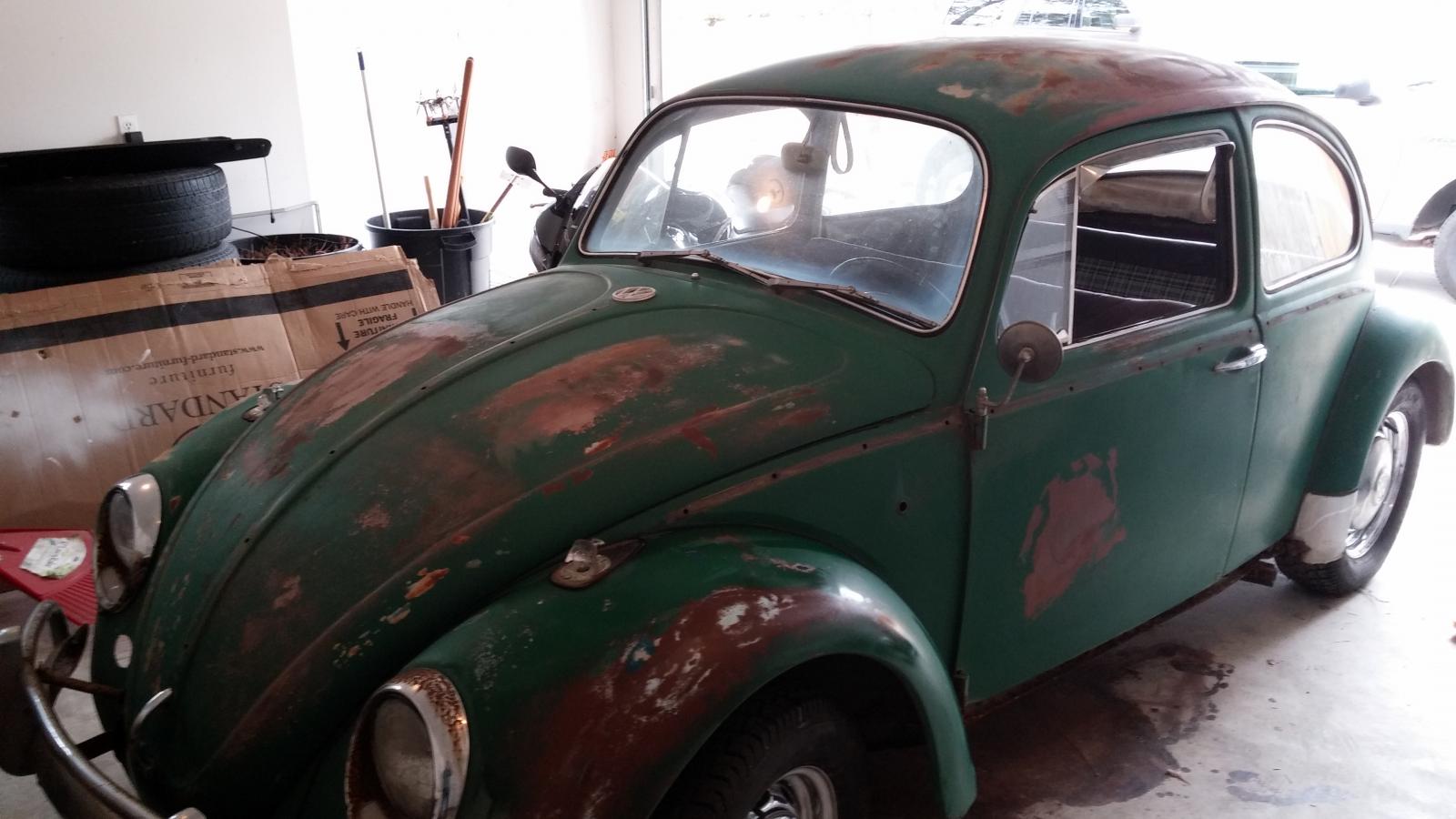

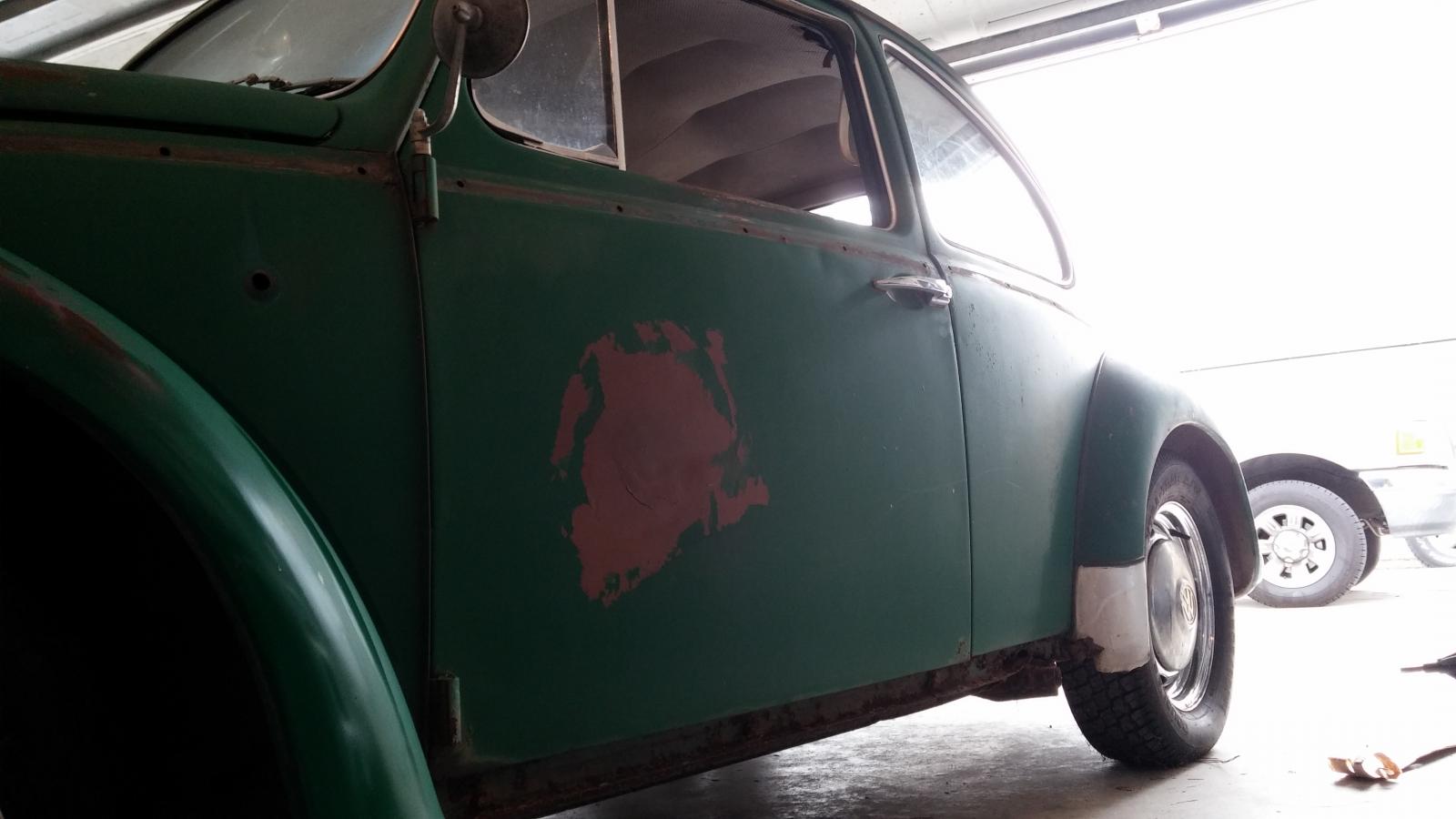

Picked this bug up in a trade. Going to take the pan off and the heater channels and replace them. I will be posting pic of the build in hopes of getting tips and "how to" help along the way. Thanks

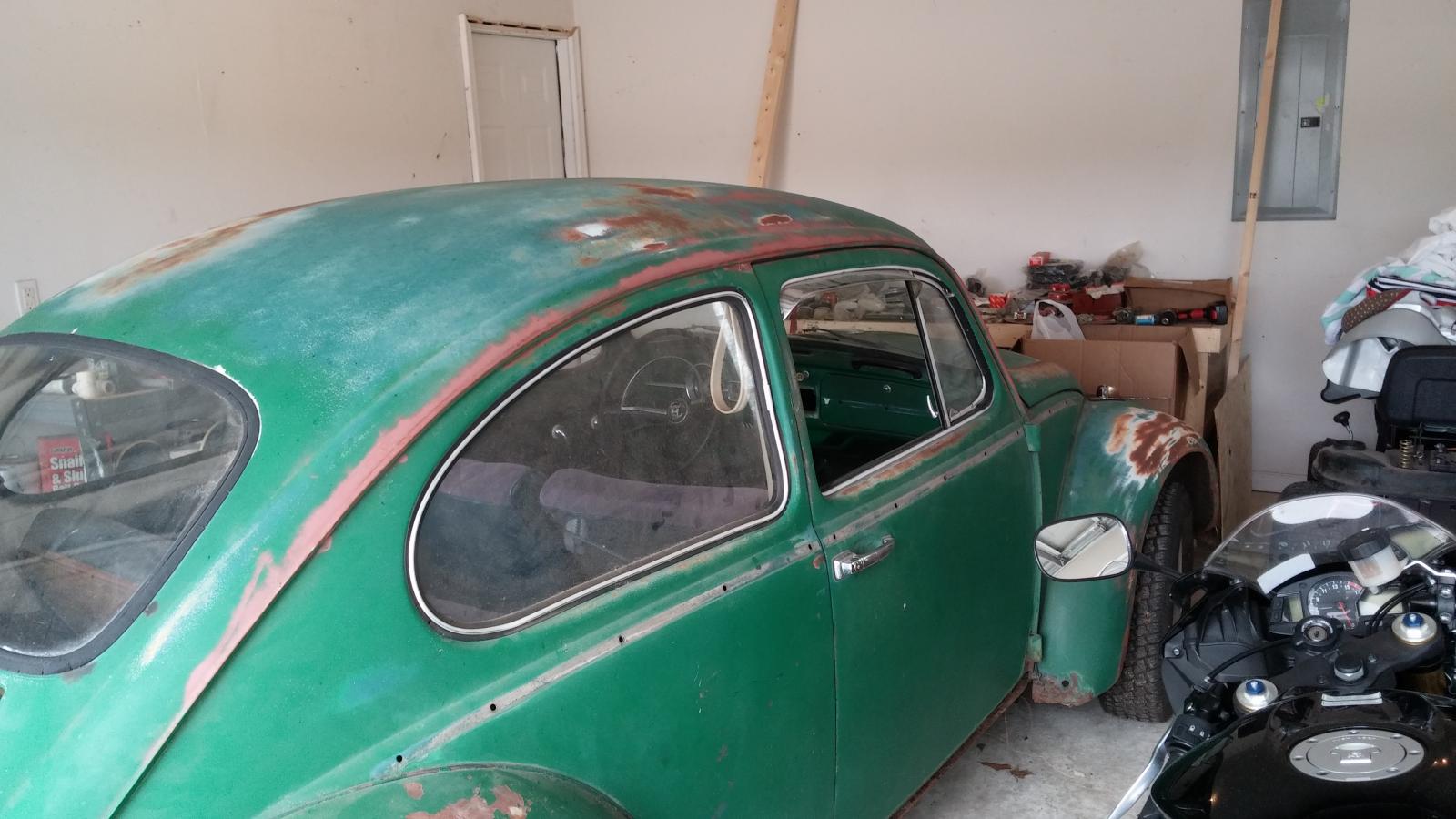

PostPosted: Fri Jan 03, 2014 11:03 am    Post subject: Pictures of the left side Reply with quote

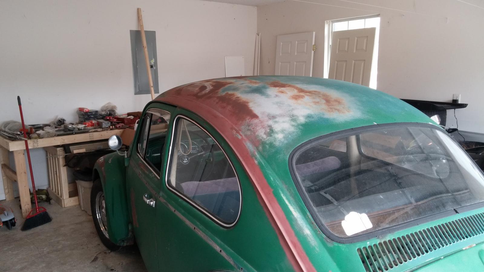

PostPosted: Fri Jan 03, 2014 11:10 am    Post subject: right side Reply with quote

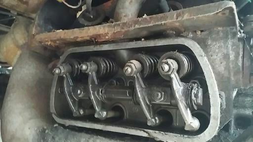

PostPosted: Fri Jan 03, 2014 11:15 am    Post subject: under hood and engine Reply with quote

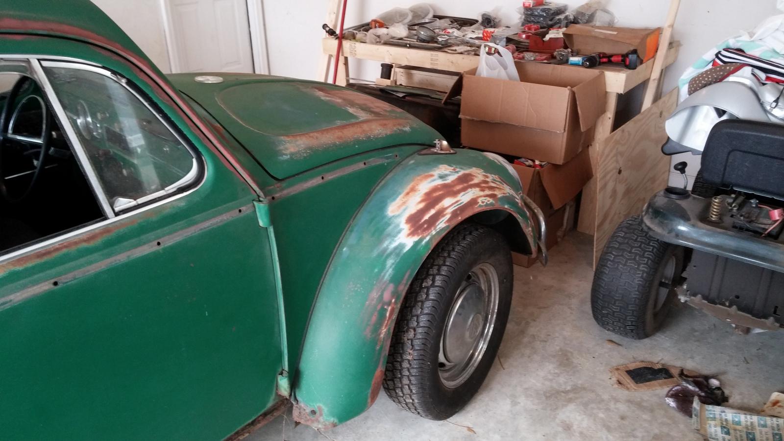

PostPosted: Fri Jan 03, 2014 11:28 am    Post subject: Getting a better look at the floor pans Reply with quote
Who knows how long the valve covers have been off the heads....

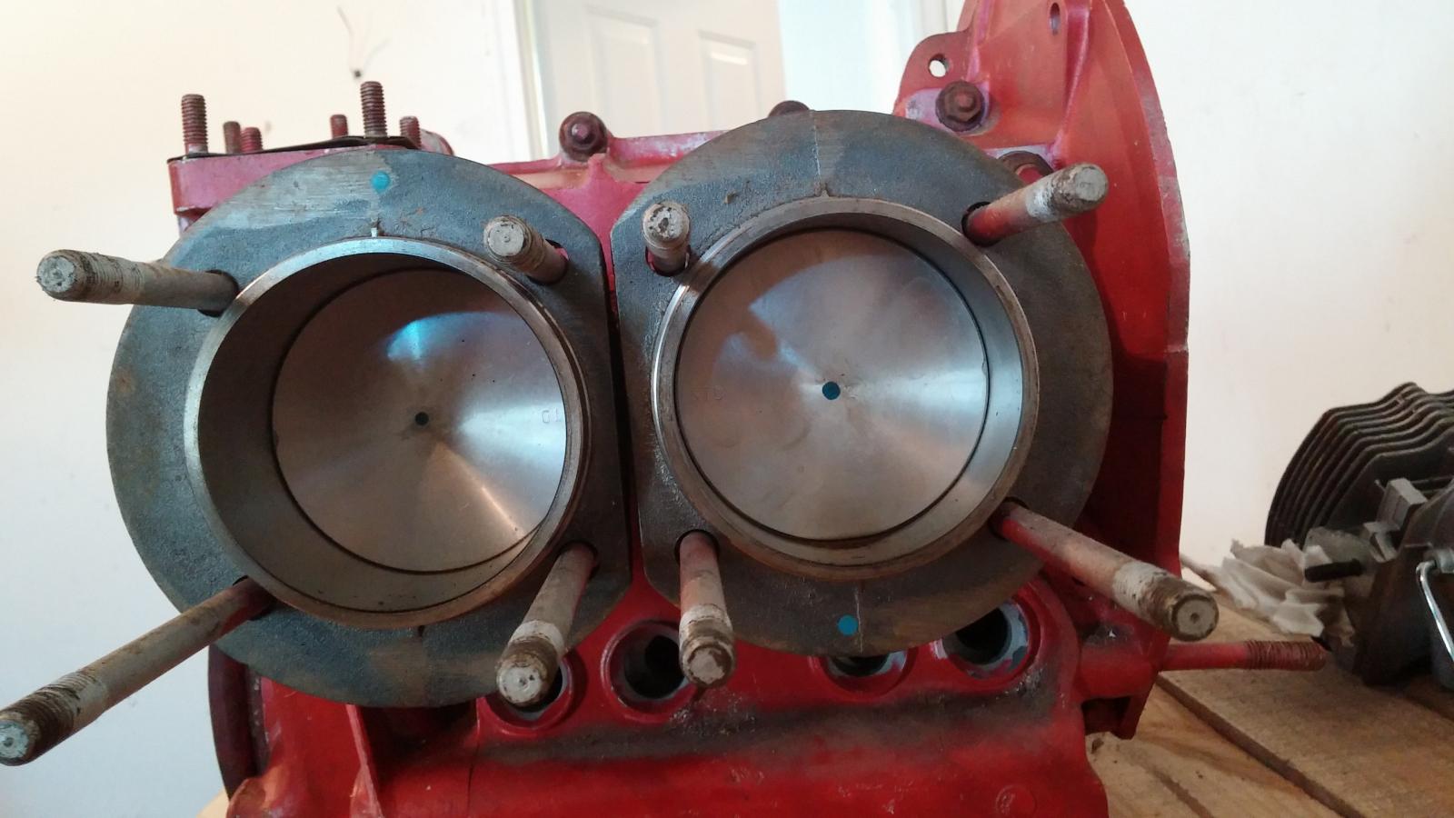

The bug came with an extra engine and trans axle. Looking at the engine code it looks like the extra engine is the og engine. I started to take the long block apart and it looks like it was rebuilt. Super clean, no cracks in the heads, almost no wear on the lifters, pistons are clean and rings new. The problem I am having is I can not turn the pulley. Any Ideas why? Should I split the case and look inside?

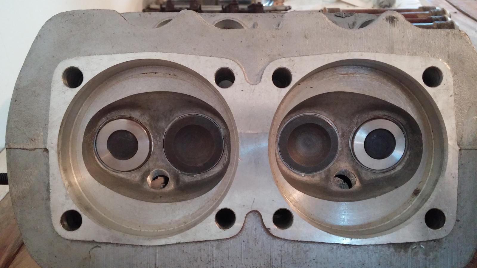

PostPosted: Fri Jan 03, 2014 1:44 pm    Post subject: Heads and Pistons Reply with quote
Here is a better shot of the pistons. Can anyone tell me what kind of head this is? Is it stock or aftermarket?

gt1953
Joined: May 08, 2002
Posts: 13947
gt1953 is offline
PostPosted: Fri Jan 03, 2014 3:15 pm    Post subject: Reply with quote
OK. nice you have your work cut our for you. I like the Patina!

Thanks! Anyone have any tips on why my crank won't turn freely?

if the motor has been turned backwards with no dist in the block it can push the dist drive up and bind the crank. Just my 2cent

Well I took a look at the block this morning and there isn't a dist drive gear in the block right now and it still won't turn freely. Any ideas?

It doesn't appear you have a flywheel attached. Crank may need to be pushed toward flywheel side to turn.

Well I can't push the crank forward or backward so I'm not sure......

just split it and find out what it is, looks like someone spent the cash on the parts but made an error in assembly. could be rod bearings not sized to crank correctly or an error on the install. get rid of that red paint, so split the case and hopefully put it back together with nothing more than a gasket set and ability. great car, the cash will flow one direction for awhile so be prepared.
