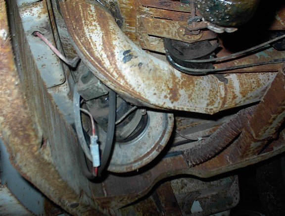

Hello folks,
My 65 Roadrunner at some point had a Stewart Warner gas heater installed. It's the typical kind sold by VWOA mounted in the engine compartment opposite the battery. The problem is the spare tire well was cut out and covered to make room for it. If I return the spare to its original home there will be no room for the heater.
What was the typical MO for mounting gas heaters in a walkthrough bus?

That photo looks normal for a SW heater install. Yes, the wheel well tub gets removed and blocked off.
The eberspacher heater the factory installs doesn't require removing the wheel well.
It looks like this:

Thanks Campingbox. I was wondering if an Eberspacher would be slim enough to fit.
I wonder if the heater was installed by Riviera as my bus has lived its entire life within 10 miles of the dealership.

There was a stewart warner heater that fit under the parcel tray in the front. It looks like most of the parts of a rear mounted heater, but arranged differently to fit. Hard to tell from the pics, and I've never been able to peek under the cover at one in person.
I have a type 3 eberspacher that I am considering mounting under the bus, with a Y fitting to add hot air to the factory center tube.

This was the SW solution. just use a different hole in the wheel to secure it to the mount.

As Toolbox Ted mentioned, just mount the spare tire up higher, on top of the tray. I have a Stewart warner gas heater in my '65 walk thru dd panel. I found a jeep spare tire cover that works well to cover the entire spare.
