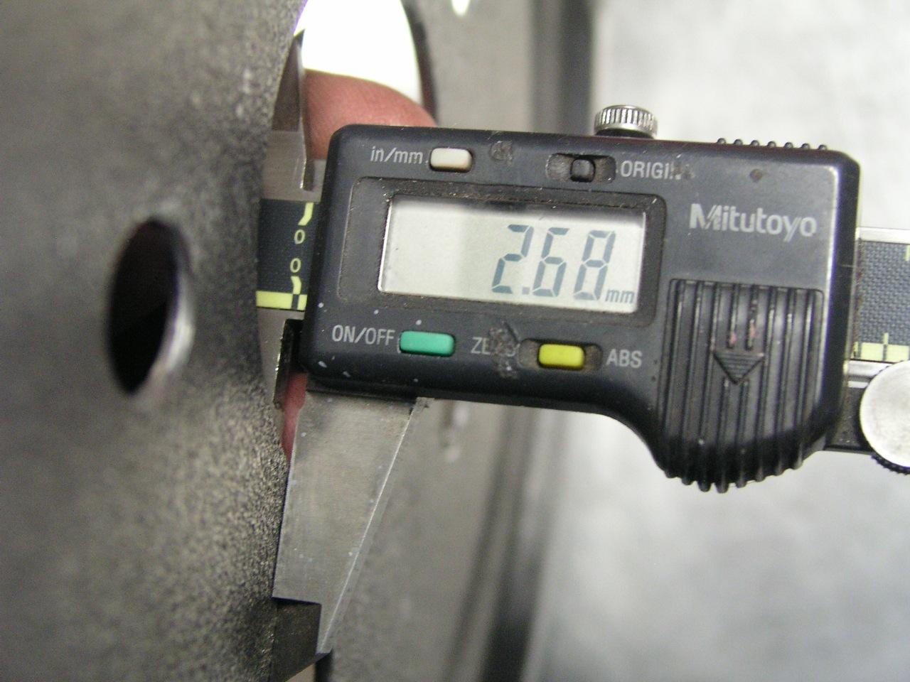

PostPosted: Sun Jan 05, 2014 10:37 am    Post subject: Bus and Vanagon drums compared Reply with quote
it's easy to get Vanagon & late Bay Bus drums mixed up, even the big companies who distribute parts do it. in the photos below the new Brembo drums are Vanagon but labeled with a '71-'79 Bus part number. next to it is an NOS Bus drum for comparison.
i measured the thickness of the centre part of the drums. the new Brembo is about 2.68mm and genuine NOS is 2.53mm. it's not a big difference. i don't remember seeing a drum that's thick like the one posted originally.
the difference between a Vanagon drum and '71-'79 Bus is the outer edge where the drum notches around the backing plate, the Vanagon drum has a wider groove in this area. you'll only find this out by looking really closely or by installing a drum on the wrong vehicle and it will either rub the backing plate or not fit over it.
