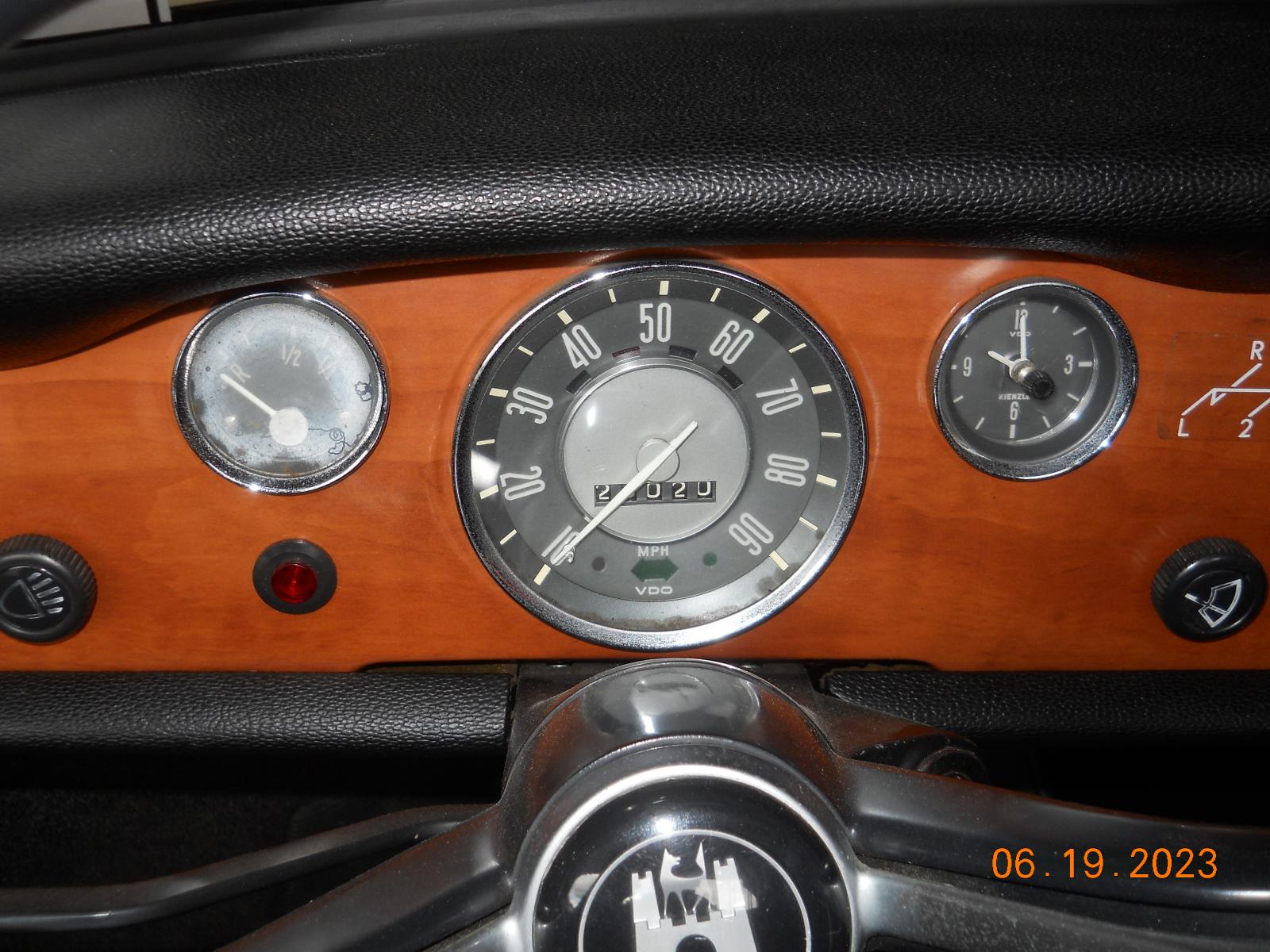

PostPosted: Mon Jun 19, 2023 5:32 pm    Post subject: Re: Condensation inside of my gas gauge Reply with quote
Did anyone find an answer to the condensation in a VDO gauge? My Ghia's fuel gauge will have condensation within just a few minutes of local driving. It only happens on the fuel gauge and it happens every time I drive the car. It's never been enough to see it drip down the inside of the glass but it's enough to cloud up the glass. I thought it was due to the front trunk having a bad horn boot, causing a fast change in temperature and humidity. I installed a new horn boot today and it made no difference. Are these gauges intended to be more or less sealed?
Marc

PostPosted: Tue Jun 20, 2023 6:30 pm    Post subject: Re: Condensation inside of my gas gauge Reply with quote
Maybe run a jumper from the + power terminal to the light bulb + so the heat will evaporate the fog.

PostPosted: Sun Jun 25, 2023 7:07 pm    Post subject: Re: Condensation inside of my gas gauge Reply with quote
Same as before, one needs to make it so the moisture can go up and vent out. Have run the dash lights all day long and it does not dry out the gauge. Gauge we have this problem is above the dash, so no way water is dripping into it. Still need to fix it.
