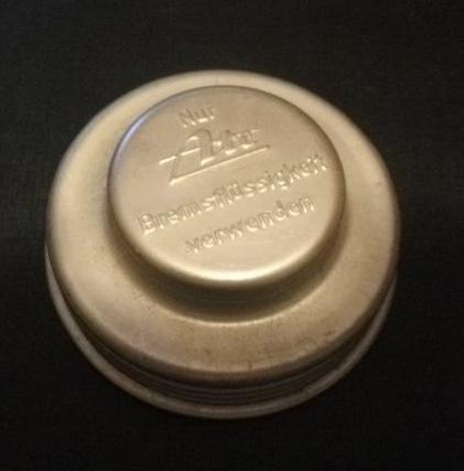

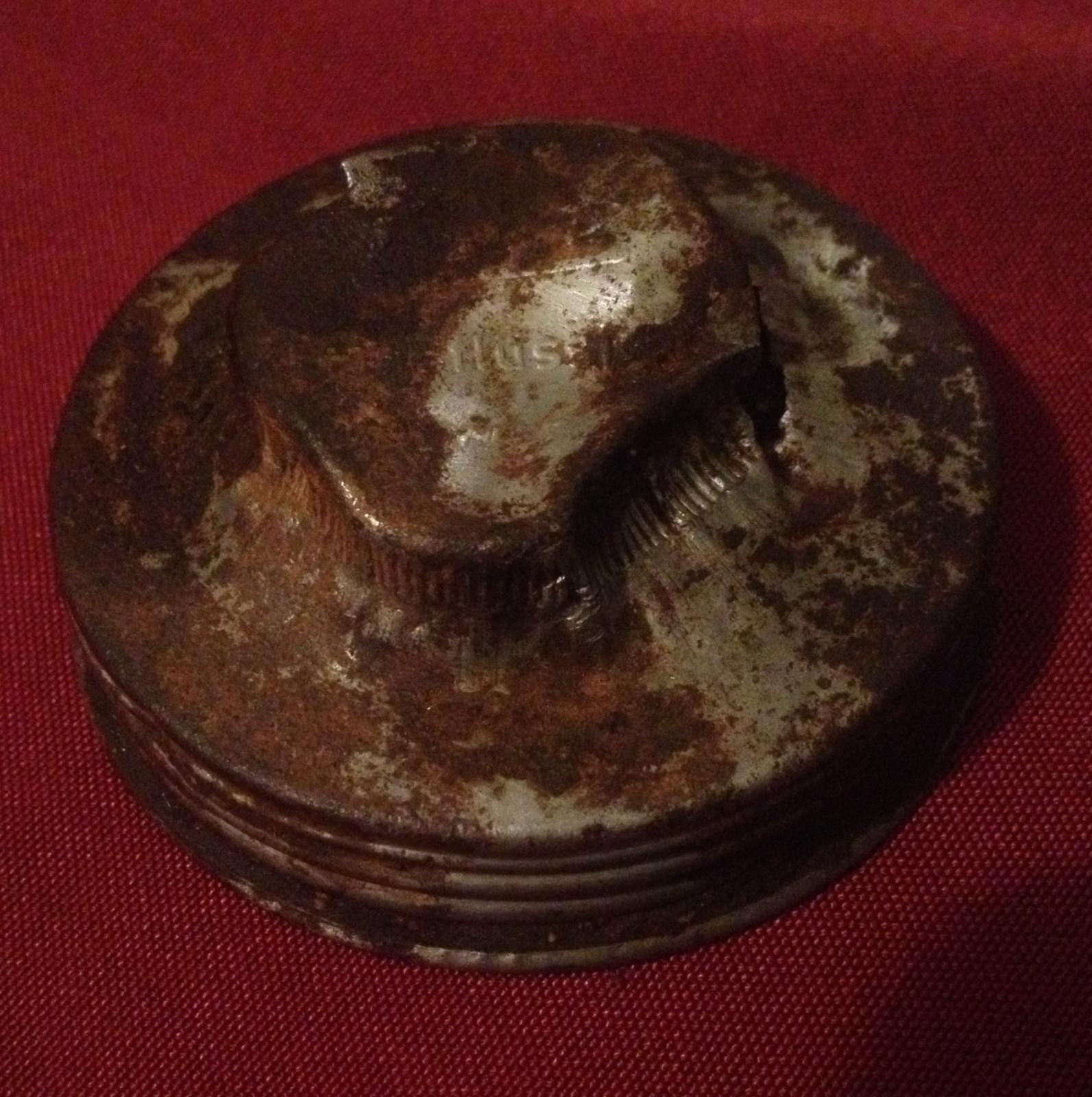

Asking the pros here if Barndoors used this metal type reservoir? If so what years. Early split window bugs did.
Posts: 71259
PostPosted: Wed Jan 22, 2014 10:21 am    Post subject: Reply with quote
Yes. All years, unless I am not aware the super early Barndoors are different.
It extended into non-Barndoors too.
Progressive Refinements says:
11 Apr. 1957
Chassis # 248 322
Brake Fluid Reservoir
Now: rubber cap
Formerly: Screwed cover
Now: screwed flange, 19mm
Formerly: 27mm
CaLiBus
Joined: May 27, 2011
Posts: 1097
CaLiBus is offline
PostPosted: Wed Jan 22, 2014 10:56 am    Post subject: Reply with quote
Awesome! Thanks Everette!
Do these early numbers mean anything? At one end what I think is a number 16? The outer diameter of master cylinder is smaller compared to an August 55 master cylinder.
Is there a thread somewhere pointing out the differences in years?
Posts: 71259
PostPosted: Wed Jan 22, 2014 5:07 pm    Post subject: Reply with quote
Usually that number is the diameter of the master cylinder.
For instance 19 or 22 meaning 19mm or 22mm.
Barndoors are 19mm, 55-67 are 22mm.
16 is for ?

CaLiBus
Posts: 1097
CaLiBus is offline
PostPosted: Fri Jan 24, 2014 9:25 pm    Post subject: Reply with quote
Brian_Mccue wrote:
Steel one are 1952 and down bug and bus
That's the info I found in the spit window bug threads.. I'm thinking what Everette found was for the aluminum canisters.
CaLiBus
Posts: 1097
CaLiBus is offline
PostPosted: Fri Jan 24, 2014 9:30 pm    Post subject: Reply with quote
52panelvan wrote:
The remains on both my 52 and 51 were steel I think, I had assumed that the one in the pic above was steel (zinc plated) too as it looks rusty on a few spots on the side of it?
Yes steel canister. Here's the metal Ate cap Sad

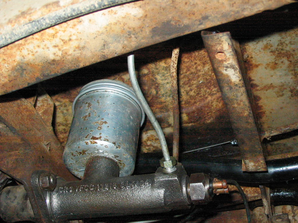

That looks curved at the bottom.
This reservoir was on my Jan '56 westy when I got it:
The same type was on my June '53 bus when I got it, and it had '66 tags on at the time.
You can't see it very well:

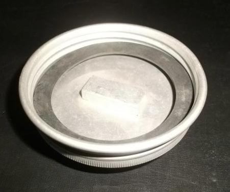

CaLiBus
Posts: 1097
CaLiBus is offline
PostPosted: Tue Mar 04, 2014 12:46 pm    Post subject: Reply with quote

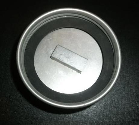

Yes. Mine does appear to be more round at the bottom.
Here's the bottom stamping just like what you have. The reservoir is definitely Ate. The Ate cap fits perfect. It could be an earlier or older version.

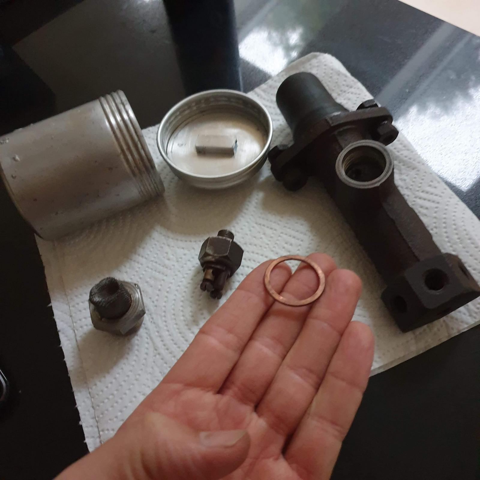

PostPosted: Thu Sep 22, 2022 9:21 am    Post subject: Re: Barndoor brake Reservoir ? Reply with quote

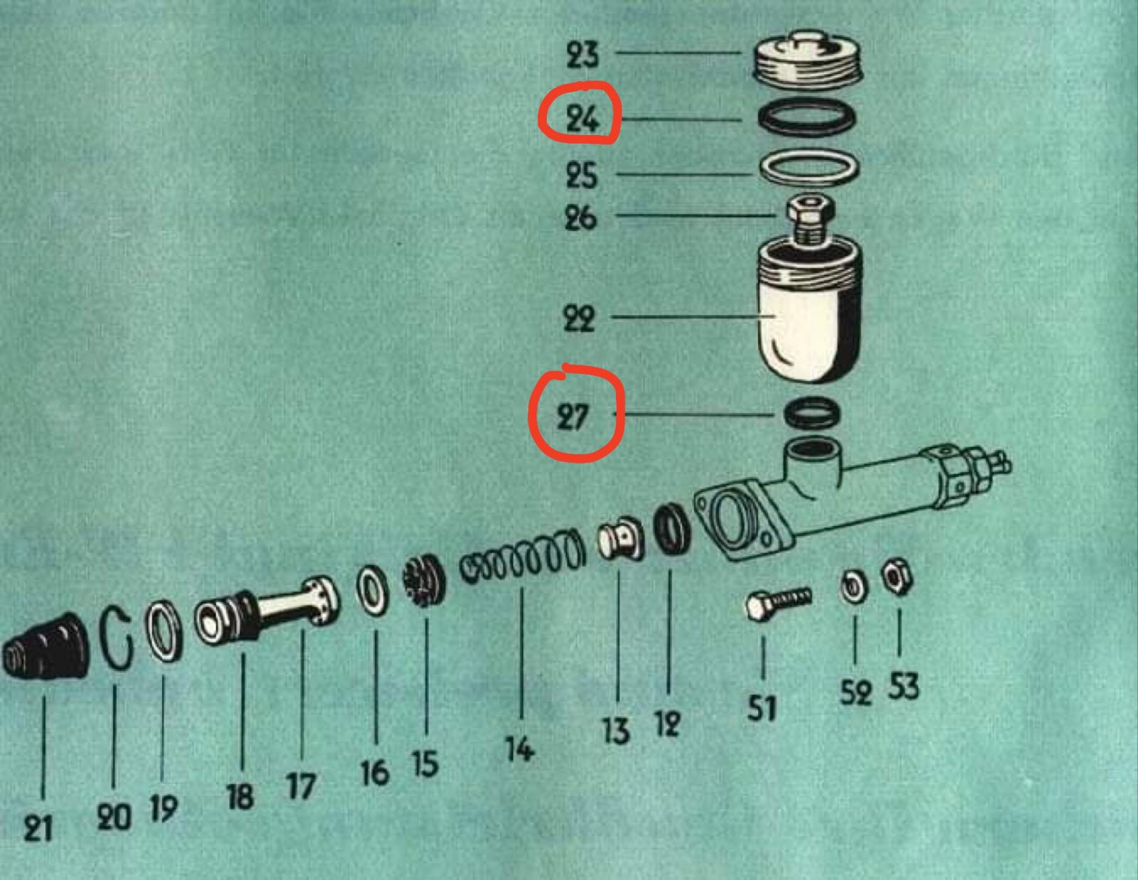

What are people using for reservoir gaskets 24 and 27?
Ie who supplies these?
Are they rubber, or the fibre type?
(Ref gasket 27…is that internal diameter 22mm, external diameter 27mm?)
-StockRocks-
RockStock
Joined: November 26, 2004
Posts: 4188
Location: England
RockStock is offline
PostPosted: Thu Sep 22, 2022 10:48 am    Post subject: Gasket 27 Reply with quote
I actually have gasket 27…it’s a copper ring, approx 22/27 diameters.
So would like to know about gasket 24…and gasket 25 come to think of it

#24 Rubber Seal

PostPosted: Wed Mar 01, 2023 1:35 pm    Post subject: Re: Barndoor brake Reservoir ? Reply with quote
Virtanen sells copper seal #27.
https://www.thesamba.com/vw/classifieds/detail.php?id=2213844
WW one is probably the same
https://www.wolfsburgwest.com/cart/DetailsList.cfm?ID=N138272
BBT
https://www.bbt4vw.com/en/catalogue/brakes-shocks-...4iALf6lE44
Still unsure what material gasket #25 is.

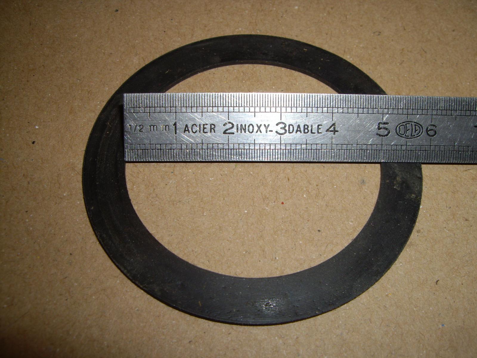

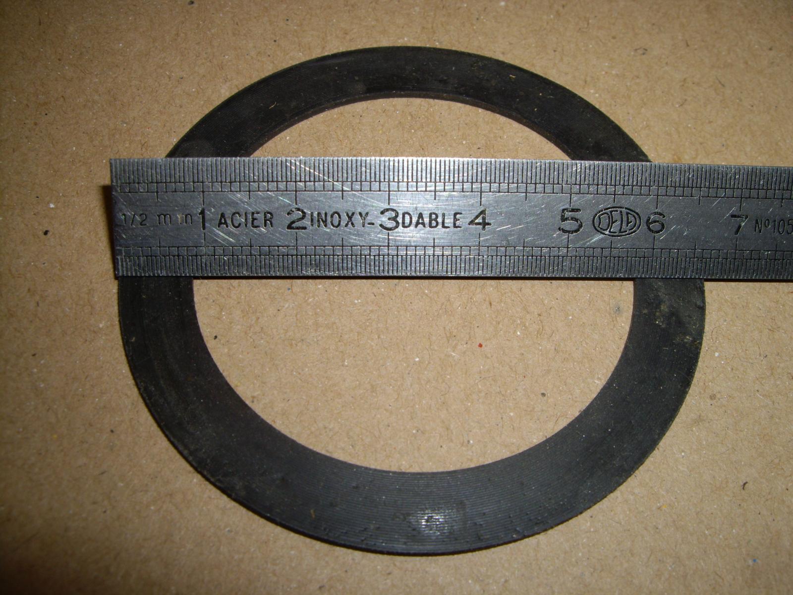

RockStock wrote:
#24 Rubber Seal
Please can someone post up the internal and external diameter of rubber seal #24?
-StockRocks-
Crashbox
Joined: February 11, 2010
Posts: 41
Location: Germany
Crashbox is offline
PostPosted: Wed Mar 08, 2023 12:43 pm    Post subject: Re: Barndoor brake Reservoir ? Reply with quote
Inner diameter is 50 millimeters.
Outer diameter is 66.5 millimeters.
Thickness is 1.2 millimeters.

Thank you Crashbox! Very kind.
Does anyone have a spare seal?
