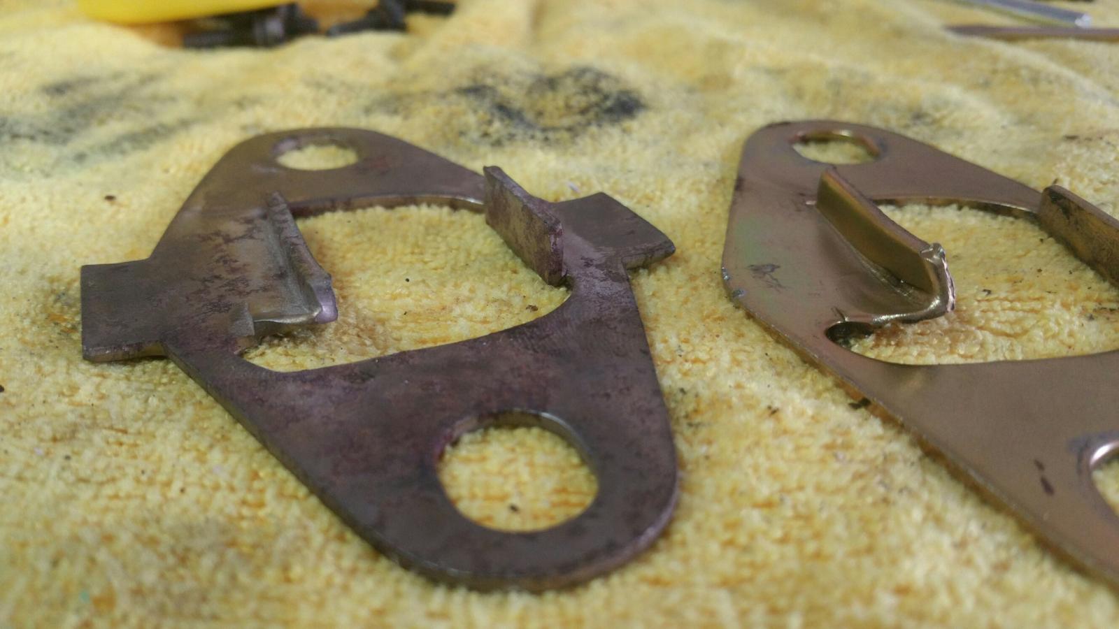

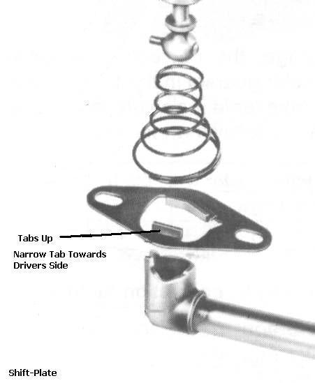

SHIFTER STOP PLATE
68-79 Stop plate 211-711-149
Left is OE: note ears on plate and Opening is norrower
Right aftermarket:
Note: Ski ramp goes on right when installed. Not left as pictured.
wcfvw69, noted ski ramp on oe stop plate was lower and gap was narrower. He noted that the oe stop plate made shifting smoother and shortened the throw. In this thread.
Shifter plate height question
Stop plate orientation: short raised tab to left side, ski ramp to right side.
This raised portion is supposed to be there..

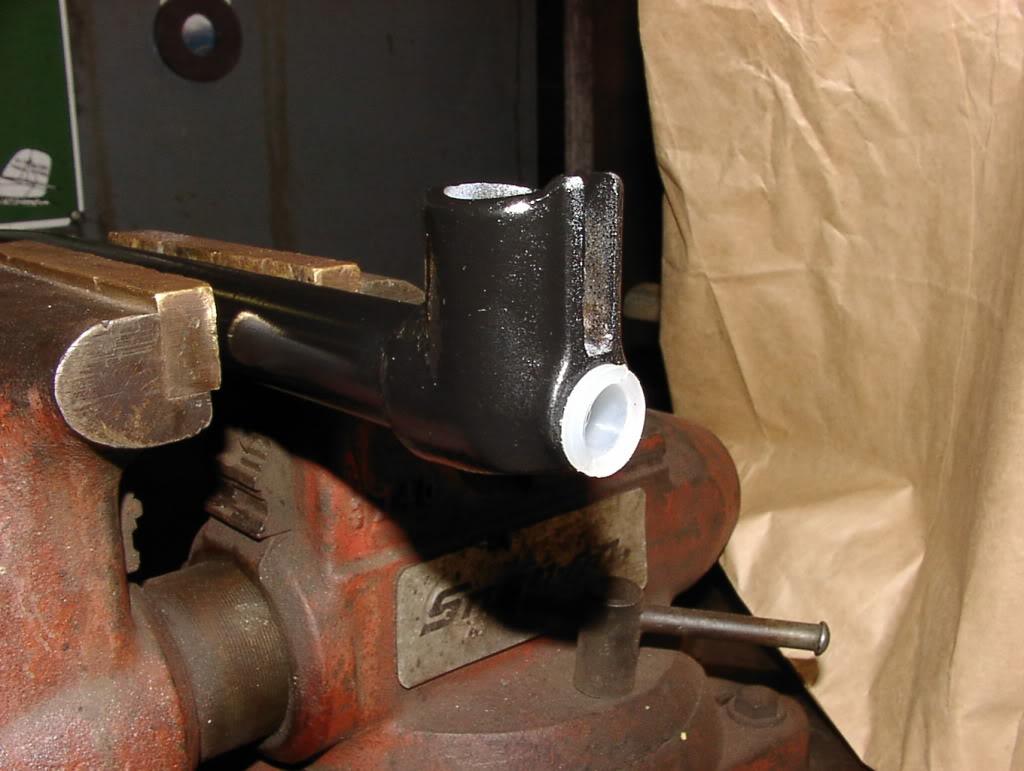

E. 211-711-197 Front Shift Rod Bushing, 1968 to 1973
Thanks to aeromech: Front shift bushing installed.
Before Front shift rod bushing replacement.
After Front shift rod bushing replacement.

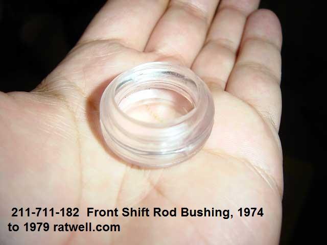

F. 211-711-182 Front Shift Rod Bushing, 1974 to 1979
Thanks to aeromech for the pic.

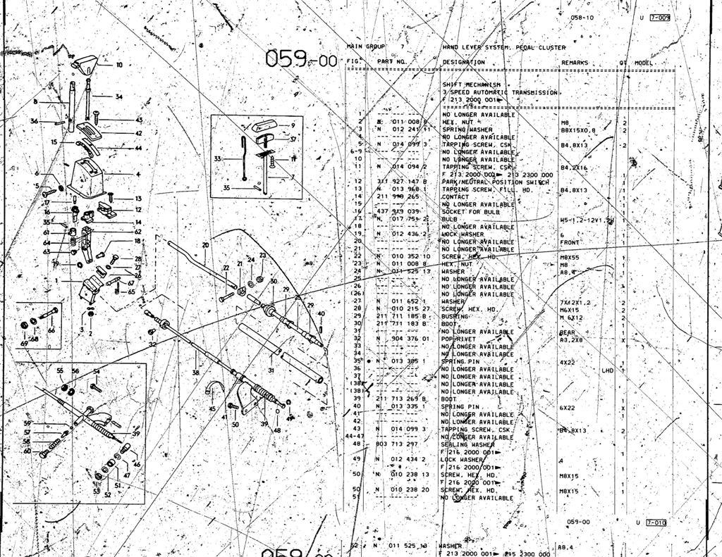

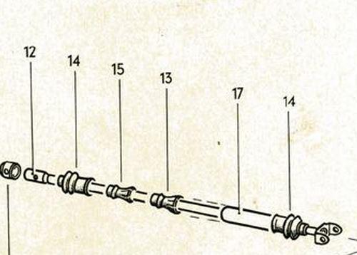

72 ONLY GEARSHIFT ROD REAR
24. 211-711-221 Guide gearshift rod rear 8/72-72 only

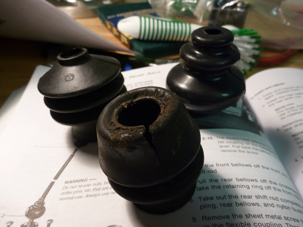

N. 211- 711 167A Early Rear Shift Rod Boot
N. 211-711-183B Late Rear Shift Rod Boot
211- 711 167A Early Rear Shift Rod Boot.
This boot started on Splits and was used on Early Bays. I was unable to find, the cut off date.
211-711-183B Late Rear Shift Rod Boot. No start or end of production dates.
Here they are next to each other.

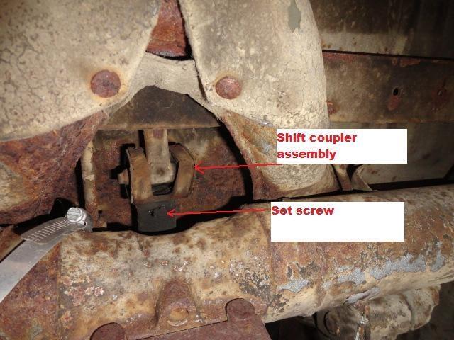

P. 311-798-211 Rear Shift Rod Coupler 68-79
Note: the bent shift coupler on the right is the result of not supporting the rear of the transaxle with the engine pulled.
Won't fit: It was suggested there may be a burr on the shaft.
R. 211-711-189 Coupler Set Screw

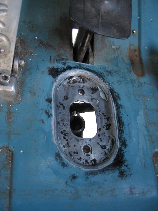

Shifter floor pan pocket repair

Shift coupler failures

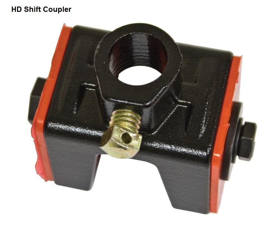

so which rear coupler should I go with... Being on the east coast I usually buy parts through bus depot, but they don't seem to have the rear coupler? Only place I found rear coupler is cip1.. but they have 4 to choose from.
I'm thinking I'll go with the so called heavy duty one? Has anyone else tried it?
here's the link
http://www2.cip1.com/SearchResults.asp?Search=coupler&sort=7
73 Riviera Camper
64 13w deluxe
1967250s
Joined: May 02, 2007
Posts: 2137
1967250s is offline
PostPosted: Sat Mar 01, 2014 9:34 pm    Post subject: Reply with quote
Get the heavy duty. Some of them are really cheap and bend.

There are quite a few different ball housings and stop plates floating around. The ball housing, Bentley calls it a bracket, and I refer to it as the shifter pivot tower, come with side cutouts for stop plates with side tabs or no side cutouts for the plain stop plates without side tabs.
Early bays had the stop plates without tabs and pivot towers without the side cutouts. As far as I know they are the same as used on some years of bugs. Some bugs used stop plates with square ends.
Late bays used the stop plates with side tabs that protrude from the side cutouts in the pivot towers. The stop plate can be moved around when adjusting by pushing on the exposed tabs. The pivot tower bolts still need to be loosened to adjust but just a little bit. The early bay setup needs the 2 bolts losened a lot and the pivot tower raised up quite a ways to push in underneath with a screwdriver to reposition the stop plate.
Stop plates with side tabs require that the pivot towers with side slots be used. But the stop plates without tabs (my prefered ones) work with either style of pivot tower. Except when used with towers with slots then the slots turn into quite an air leak in the winter.

I don't know what the part number for 24 is. Or where you are going to find it.
#24 is 211 711 221. no idea where you would get this part besides old stock somewhere.
the parts book diagram (yellowed image above top) shows a '72 shift rod and the front bushing #15 as 211 711 185B which on most Buses is actually in the rear location. 211 711 179 is the bush with the metal ring inside and it is normally at the front (except '72, it looks like). So the '72 shift rod must be unique not only in it's 2-piece design but also in using the bushings in the reverse location than other years.
Thanks Scott for the part number.
On the 72. The drawing depicts bushing 179 front - 185B rear. But as you pointed out the text has 185B front - 179 rear. Wonder what is correct.
Thanks again

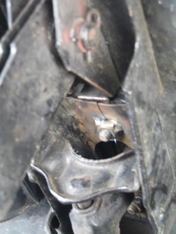

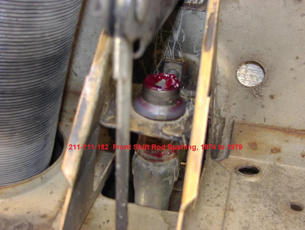

PostPosted: Wed Sep 10, 2014 7:22 am    Post subject: Front shifter bushing bracket repair. Reply with quote
Thanks to aeromech.
aeromech wrote:
I ran into this same issue recently with a 1976 I've been working on. Last week I installed a newly rebuilt transaxle from Transworks here in El Cajon.
While I had the transaxle out I removed the shift rod assembly and refurbished the rod along with new nylons birdies. Once all together we went for a ride and I found shifting difficult so we started looking and found this.
I don't have a welder so I fabricated a repair doubler from .092 stainless.
If you're going to do this the size of the doubler should be about 1 7/8 X 2 1/4. The size of the bushing hole is 1.00 inches. Here's a pic of it installed. I mounted the doubler on the aft side and this worked out fine even though the bushing actually sits a tad bit aft from original.
I haven't driven it yet but my guess is that this will be a good repair.

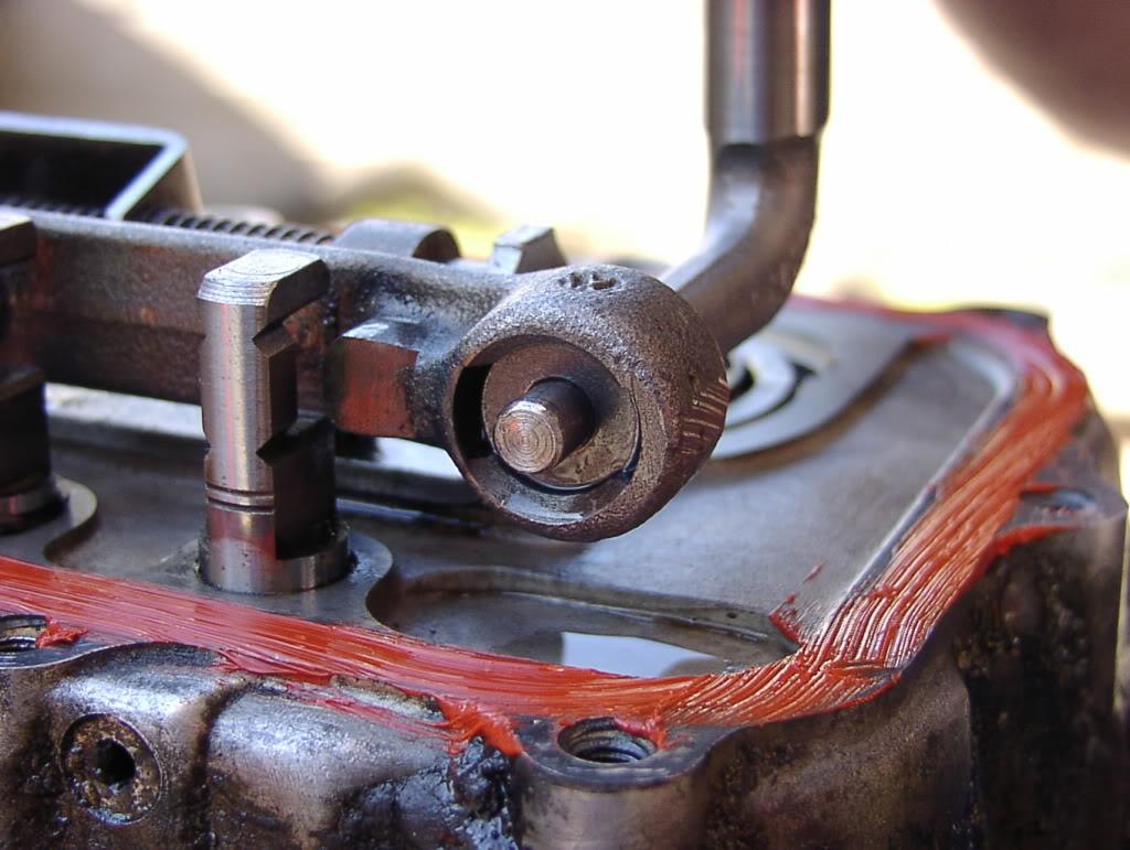

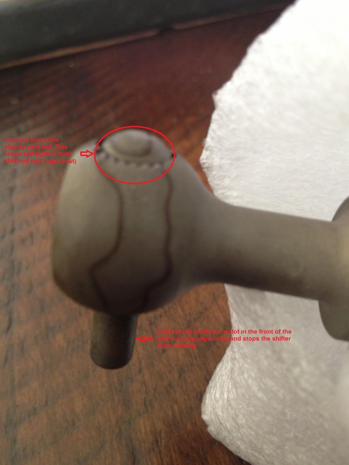

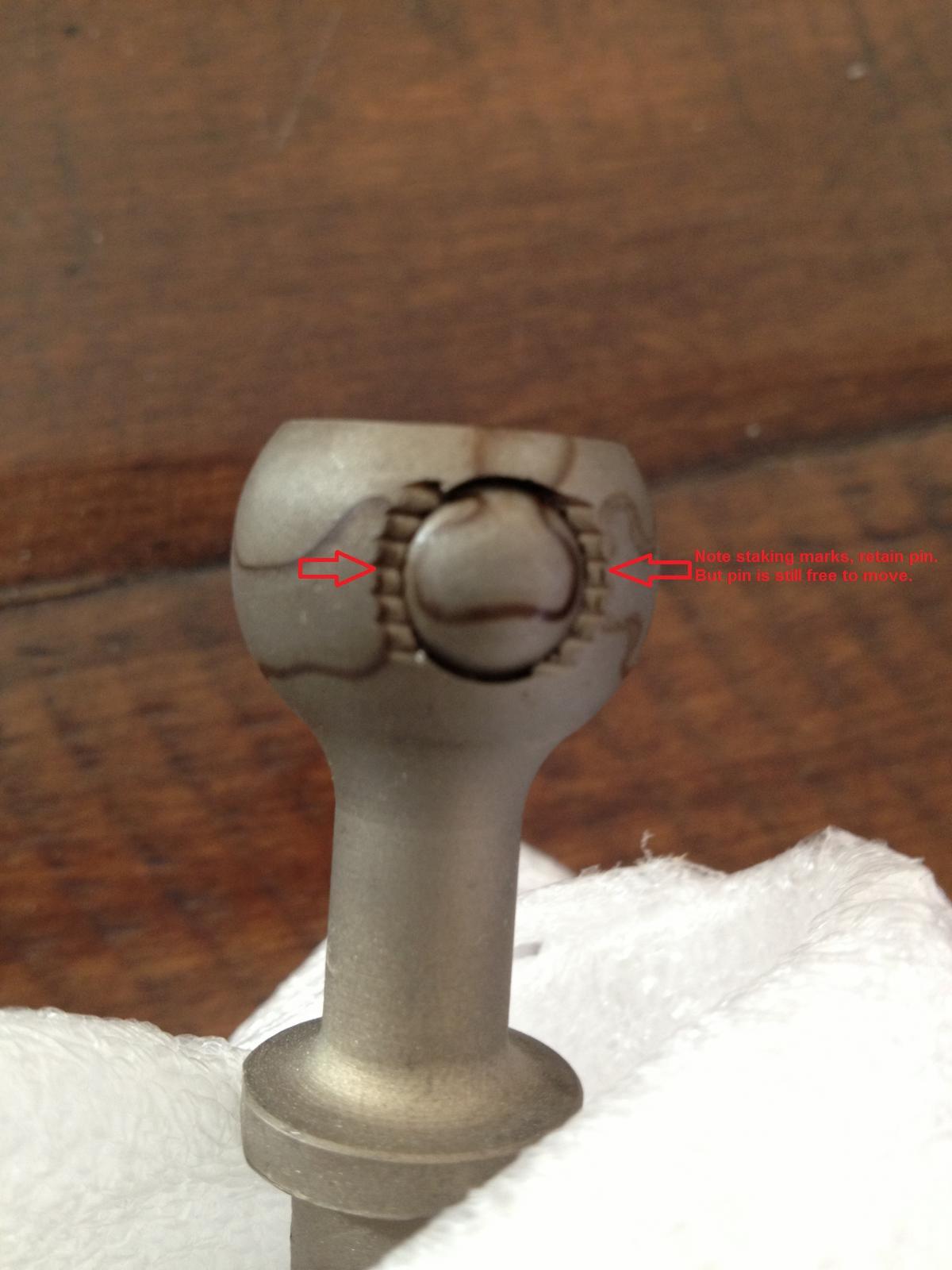

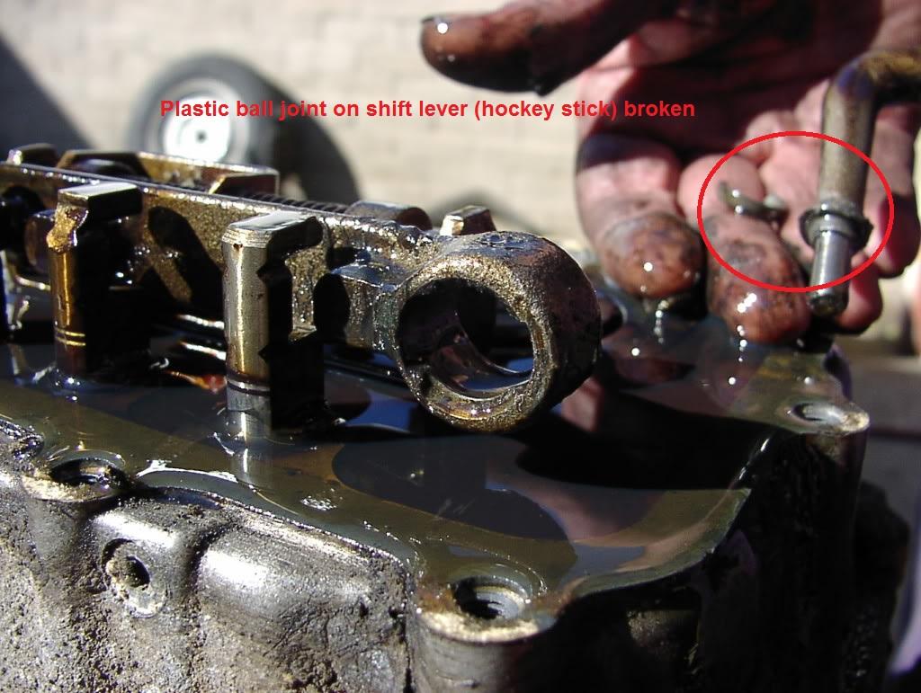

PostPosted: Wed Oct 22, 2014 11:51 am    Post subject: Hockey Stick guide broken and Ball worn out Reply with quote
url=http://www.thesamba.com/vw/forum/viewtopic.php?p=7417386#7417386]Hockey Stick guide broken and Ball worn out[/url]
Replaced with a metal ball.

PostPosted: Wed Aug 12, 2015 10:05 pm    Post subject: Reply with quote
asiab3 wrote:
Does anyone know the length of the shifters in the picture?
So after four years of hitting my forehead on the dash for third and patting the passenger on the knee for fourth, I found out that there is a distinct difference between the two shifters in the photo. The overall length of the OG shifter is about three to four inches longer, so we don't need shift extensions, but the REAL difference is the axial bend of the "elbow". See in the Bentley reverse lock out (stop) plate adjustment section, that 2nd gear should have the short lower section vertical and the main handle shaft tilted towards the driver? The crap aftermarket shifter is opposite: 1st and 2nd handle is centered, then 3rd and 4th are tilted to the right enough to annoy the passenger. I wholeheartedly despise whoever approved the aftermarket shifter production prototype…
See in the picture below how the "pipe bowl" indexing pin is tilted "up" more in the OGVW shifter on the left. Yeah, that's a BIG deal. Thanks Volkswagen.
